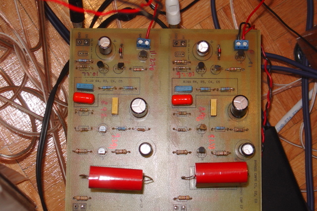

Hi guys. I just swapped the 100nF cap from a Mundorf Supreme, to a Russian Paper in Oil 47nF and got quite an improvement! Treble is definitely better and mids seem more open. The soundstage also seems more 3d.
I am really surprised by this, as the Supreme's are really great caps.
Salas, the reg I am using is an SPower. These are the best voltage regs I have yet found, but I don't like to mention them as I don't want people to think I am advertising etc.
As always, I am looking for ways to improve what I have, so that is why I was asking about caps and psu. At the moment I have a large toroid - Schottky diodes - 22,000uF 50v Mundorf - SPower reg - and 2 x 220uF Rubycon ZA's on the phono stage. All resistors are Kiwame, nice and smooth.
I shall try and find some time soon to try the Shunt reg, it will be interesting to compare.
I also got a fantastic deal on a shiny new Jelco sa-750 tonearm, which I should receive next week.
Cheers, Lee.

And the CCCP ones I recommended cost peanuts... Did I ever do any ''theoretical recommendations''?😉
SPower maybe very good Series OpAmp controlled high feedback regulators? If so, you know the future comparison story... Make the shunt.😎
I am happy for your progress and results so far. Bravo! Expect more.

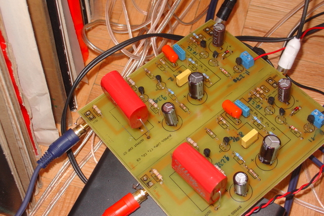

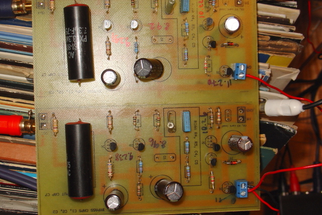

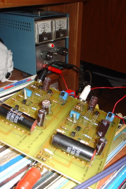

Here we go...
Some parts are different between the first and the current version of the prototype.
By the way, are the power mosfets on the regulator supposed to get really hot? 😀 Mine do.
Guys, many thanks for all the advice concerning better parts. I've already ordered some russian pio caps, and some better resistors. We'll see.

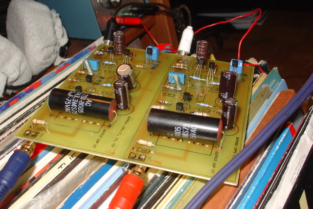

Very practical boards!

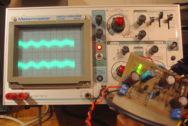

Good work. What are those traces on the scope represent?

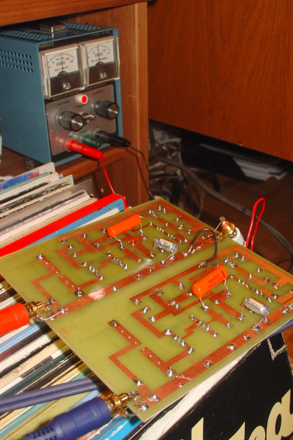

I'm not good at making pretty boards, so at least I hope they're practical, with lots of room. I think I should have left more room for the interstage caps of various sizes. Well, perhaps in version 1.1 🙂
The lower trace on the scope is before the regulator, the upper one after the regulator. Too bad I don't have a movie of it, showing the lower one moving up and down, especially when some device turns on in the house. Nothing crazy, but you did ask for a scope pic. I mean, can we really have a serious thread on diyaudio without some scope traces? 😎 Never mind this one doesn't actually carry any information 😀

yes more space for riaa caps , and compact resistor- jfet, as gainclone story short are better 🙂 and tin the pcb

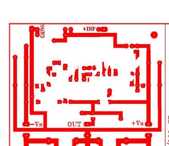

Thank you ikoflexer very much for the board layout, it gave me the needed info. I've had an itch to lay boards out since I was a kid, I find it quite therapeutic! Back in the bad ol' days with transfers and line tape.... 🙂
So here is my go at it. I wanted to tweak them to take larger parts. I don't know if I got it quite right, maybe some other eyes can check it. Still not enough space for for the russian teflon 100n's; probably an under-board solution.

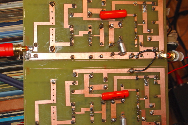

ikoflexer if you do new pcb better use , 0.1mf at input of B+ to avoid pickup rfi from cable
and for gnd you can see the separate signal gnd trace ,this little difference are impontant (separate local loop),walk + and- in pair were possible, and carry a separate wire from psu for gnd ,do not cross on pcb and do not connect the out rca gnd
pcb design is a art ,hope this help and I do not know more 🙁

Hot Mosfets in shunt
Hi ikoflexer-
Mine too, got quite toasty when I first built it. I built the non-led shunt PS. Somewhere back in this thread, Salas recommended reducing R1 to ~6.8 ohms. That did the trick for me. Not so toasty now; just warm. 🙂
