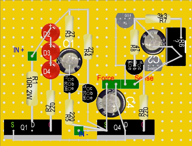

Since I didn't catch up the latest BIB GB I'm proceeding with Shunt 1.0.5 from pdf P2P.
Here is my PRELIMIARY layout... (Don't use it without care !!!)
Board will be mounted vertically with Q1&4 bolted to case bottom.
The only thing that bothers me is that C4 is too close to Q4 (heat..) or it shouldn't.
Comments please 🙂
