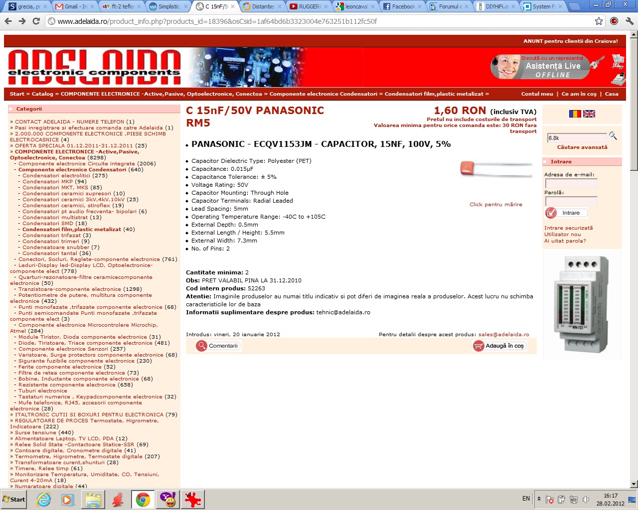

C3, up to 100nF the most. Not part of riaa but part of very low frequency filtering, big value can give rumble with big speakers.
Buy Teflon FT-2 Russian caps, they are very influential in that position and of course much better than those you got. Laying out such huge caps in your present PCB is a bitter story though. K42-Y//FT-1 0.022uF can be a good more compact combination. Watch for not much woofer flapping with the bigger value C3 and disc eccentricity (wobble).

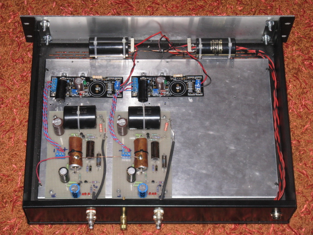

I use BIB now from V1.2 and seems better, probably due to my layout on the V1.2. Set at 230mA dual mono CLC prefilter.
Teflon RIAA caps and interstage, mundorf silver in oil output, sinkoh and takman metal film resistors.

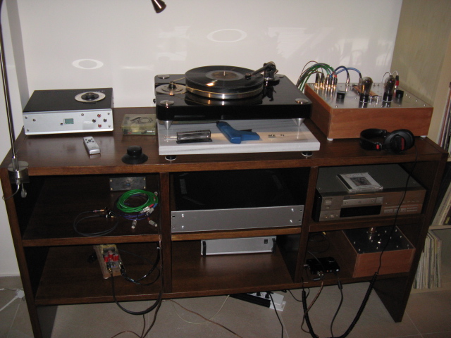

And some porn from the phono and from my cave!

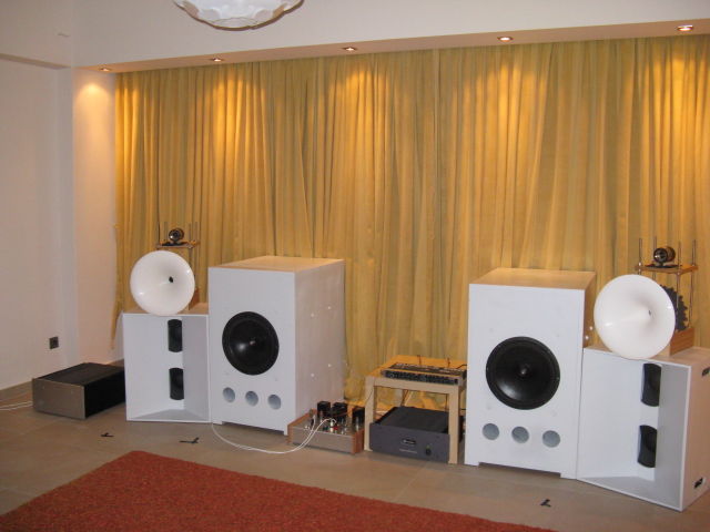

The #26 pre and Baby Huey EL84 amp look purpose built, no frills, but very nicely put together non the less. The speakers, wow!

The Baby Huey is very nice. I like it better than F5 and Aleph J.
Did you ever try shorter XLR interconnects to Huey and longer speaker cables, i.e. inverse installation of that in the pictures?
*If you look at F5 and BH schematics there are enough similarities in approach beyond FET & Vacuum domains or BH's shunt feedback.
**gingertube was prowling the tube threads with an eye for revisiting Baby Huey recently by the way. Maybe he will have something up his sleeve in due time.
Unfortunately no. I do not have that long speaker cables now. These should be 7 meters minimum. Would you suggest to bring the Huey closer to the pre and leave the active cross and amp for the sub were they are now?
*One of the reasons I liked the baby huey.
**I am waiting for this, but something tells me that it' s going to be with a mosfet follower and would like to stay tube only on this.
You know, since the input 12AX7s on the Huey have a Miller and the many meters interconnect has a capacitance blah, blah, maybe bringing the Huey closer to the #26 pre could yield more performance. If you can do an easy rearrangement it would show. Just an idea.
