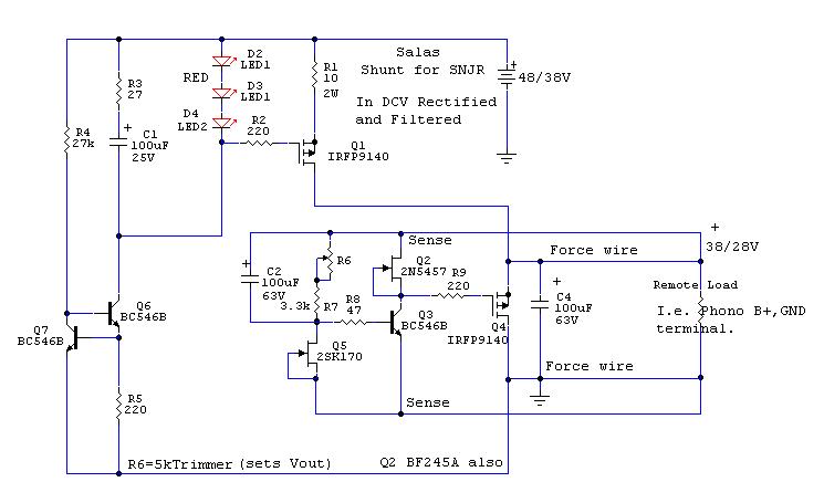

Regarding the two electrolitycs i've seen some shunt versions where you recomended 1000uf but in mine also 100uf. Is 100uf enough ? Would be 470uf let's say, bad ?
They aren't exactly the same. 220uF for the one across the trimmer maybe, don't change the output one's value though.

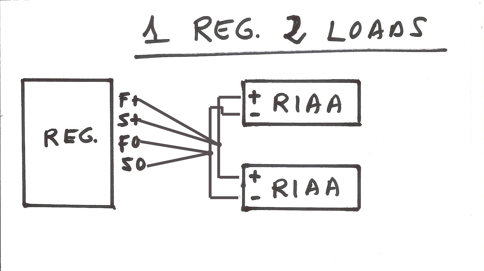

- how to connect power (sense, force) from shunt regulator to both channels of preamp as my pcb design is a dual mono approach? (positive and grounding are separated for every channel)
- knowing i need 20volt for preamp wich would be the minimum voltage on the entrance of shunt regulator? Is enough to be only rectified and filtered? (now i have a LM317 as stabilizator before shunt)

- For first question see attached. (+Riaa=V+, -Riaa=GND).
-30Vin is good for regulation and mains variation. Avoid less than 25V. Your 317 before shunt can be good or can have weird interactions. Try listen without it, the reg is designed for C filter or CRC, CLC, passives to be enough.
-You got to have the case at circuit's GND potential to minimize hum pick up anyway but have GND defined paths, so isolate RCAs and use coaxial signal cables to minimize the field sensitive loop area. You may use just one wire from where F0,S0 meet RIAA channels GND link to reference the chassis.

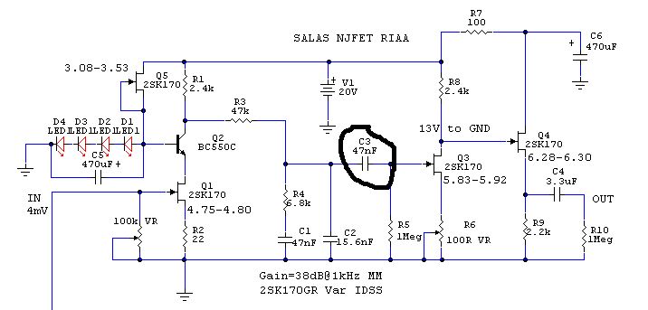

The 47nf cap marked in the picture can be 100nf or 220nf? As far i can understand he is not a part of RIAA network.
I'm asking this because i've found some 0,1uf russian PIO caps wich i think will be better than my cheap poliester caps. Or should i push for some teflons ? http://www.ebay.com/itm/K42Y-2-0-1u...ps=63&clkid=6648419942149181386#ht_820wt_1187
For RIAA would be a good choice these http://www.adelaida.ro/product_info.php?products_id=18396&osCsid=1af64bd6b3323004e763251b112fc50f
