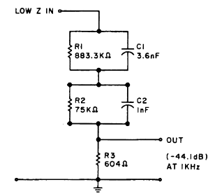

You can check that the regulator is trouble free by using the oscilloscope on AC input and 5mV/div, 10uS. Looking for a clean straight line on the screen with probe between B+ and GND. No small frequency riding, no noise hash. If you make an inverse-riaa input filter to very tight tolerance spec and you got a function generator you may check 1kHz square waves are good also. That will prove good Riaa shape. Our phono uses Lipshitz Riaa classic, no extra supersonic pole. Just for fun testing, not really to worry about when with tight Riaa caps and resistors in the phono, has been tested before it gives compliant Riaa if made well.

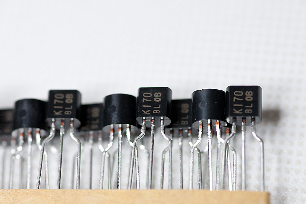

Salas could you please have a quick look at the k170 I found. Do they look legit? I got them for something like 20c a piece. I have no 9v supply right now to measure their Idss, but the vendor said they were matched to 8-10mA
attachment.php
Thanks a lot for your time
