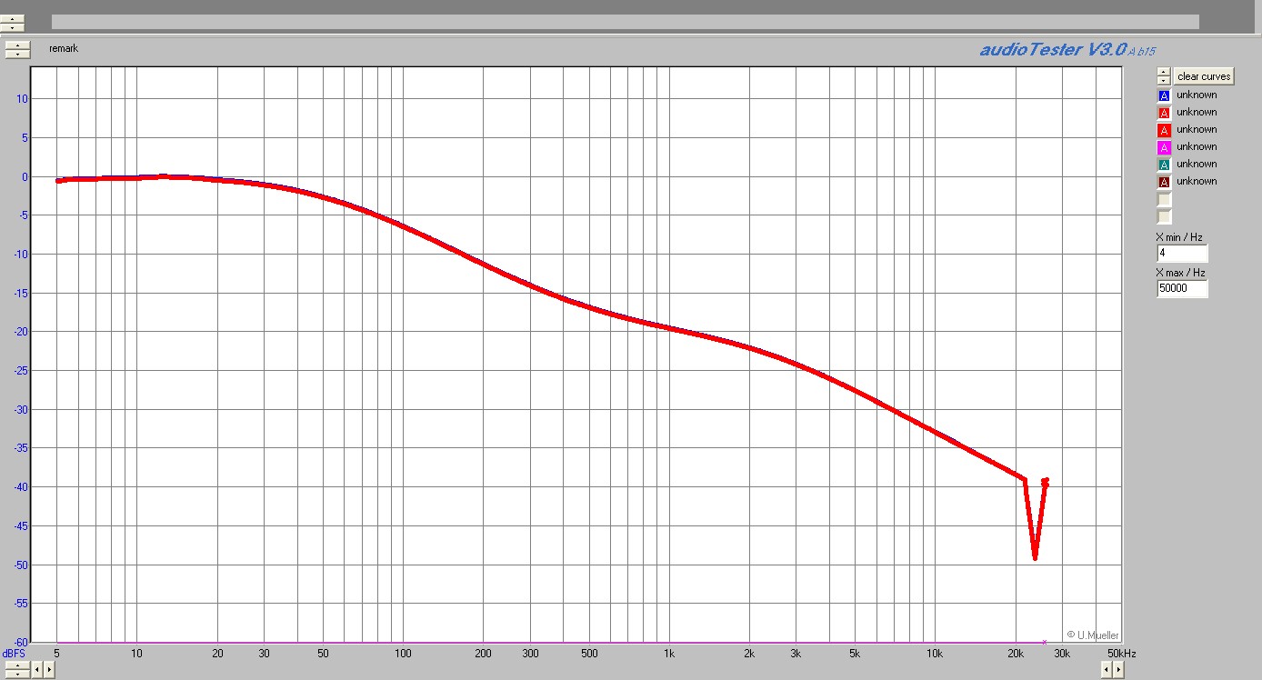

Hmm R6 (2nd stage's Rs) is 33R... That Jfet seems isn't 8.8mA IDSS, looks like less. When the buffer's Jfets draw as IDSS stated. Is your R10 6k8? Can you add 1.2k in series with R10? That will give even more gain and it will centre the buffer. Look for 10V on second stage's drain.
I was too quick. Before I saw your reasoning I changed them. I did a quick check on the channels and they still match. See Attached.
The buffer are now sitting at 11.6 on right and 11.4 on Left
Sorry about that, but from my perspective and in hindsight, it it alot easier then redlining all of the schematics🙂. I also would prefer not to have too much more gain. The thing allready blows the windows out.
If I did my math right, I need about 150R now
P.S. guess I should attache the graph
You will have a bit more, now that you put the properly strong. Check gain and THD with 0.3mV in. Lets see where we are before adding any R. There is Rs we can up a little along more load as well and win some THD.😉

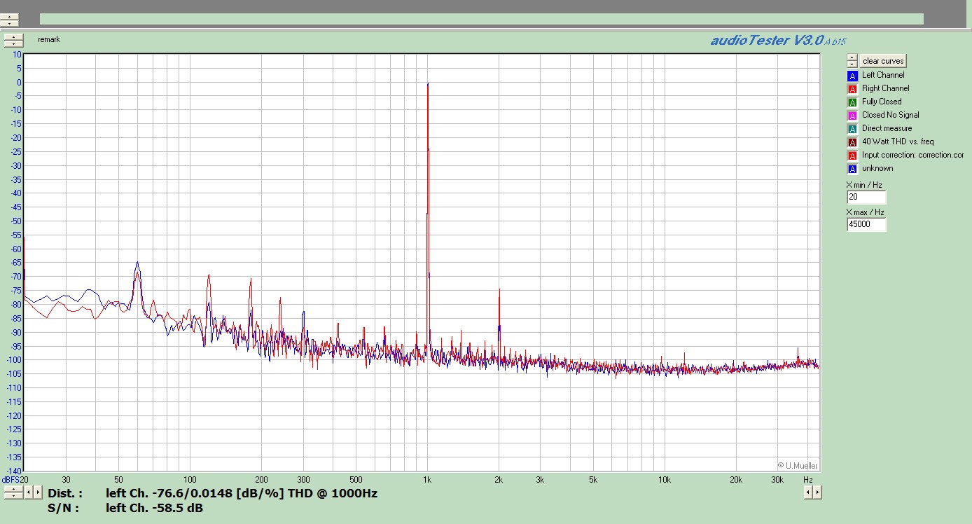

Glitch in correction file.
Here is the 1kHz FFT.
Gain is 57.9 dB using .3mV input which is also 0dB on plot
THD is down at 0.021%Right and 0.015% Left
Noise floor is up slightly, but both the internal and external box is open
Its OK. I had calculated G=58dB on your CCT with 8.8mA IDSS on 2nd stage. Its printed on it. Now THD is on target too. I started the questions after I saw odd stuff in you 3 color curve one. So we found the wayward guys. Where are the originally intended ones? In the PSUs I guess.

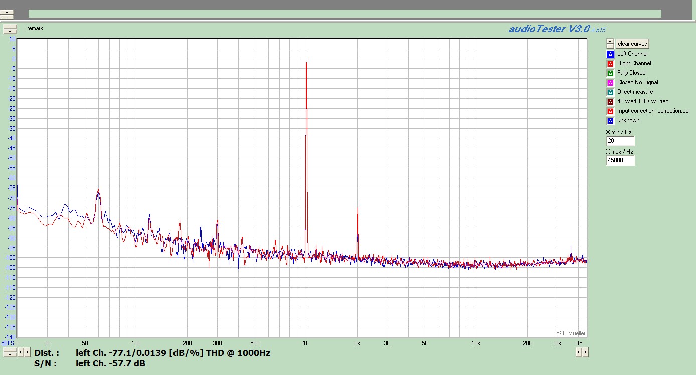

P.S. Can we directly compare the above graph with a new one, same standards, but all lids closed?
I need to finish my measurement pc!!! Still not bad though, even with low batteries.
I will give a listen as soon as the kids are done watching a movie.
Here is the graph with the lids on
The THD is great. This is no global feedback single ended, remember.
In your 3 color post, although the THD on the green curve was wrong due to the cuckoo 2nd stage fets you changed, you could display lower noise floor non the less. How that happened? Pressed some different buttons on the software?
