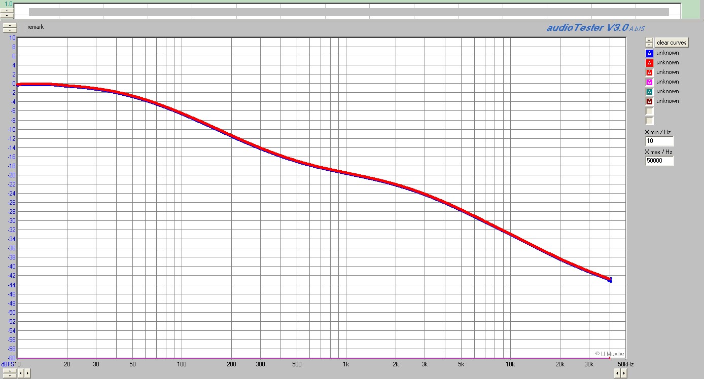

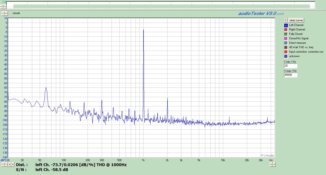

Okay FT-3 Interstage and Polysteyrene RIAA Caps installed.
Here is the RIAA plot and 1kHz 0dB=.3mV. FFT is growing grass again. Measurement setup isn't identical since I need to clean my bench.
THD is same as before at 0.02%
Merlin, mine does dance. If it had a pole it would be x-rated.😀

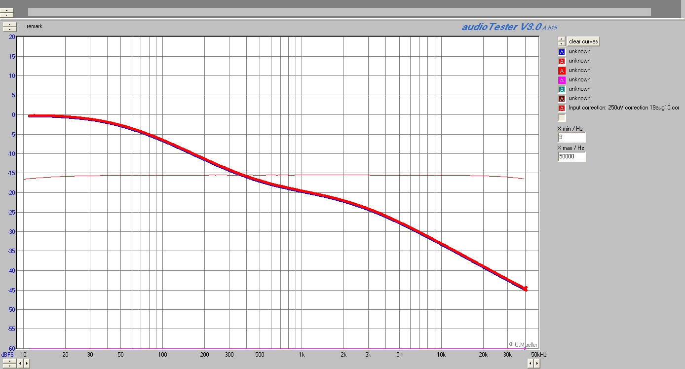

Yes. I think it may be the wrong one, now that you mention it. I see a lift at the high frequencies. I can't remember now if I restarted the program after selecting it. Audiotester doesn't recognize the correct file until it starts on it. Will have to retest tomorrow.
I will need to receck tomorrow. It is brighter sounding. Not offensive but there. I am not sure if it is just the new caps that havn't seen a charge in x number of years or a real artifact of the riaa. I am going to let it burn in a few hours tonight and try to test it tomorrow if I have time. Have to travel for the day
You had 15.7n PP testing caps, now 15n Polysterene. Which is the flat value, and a bit different tone from caps. Let it burn a bit, check on VTA see if you want to ''tweak'' the subjective HF. I use that flat alignment too. Never bright in my system, just alive in my perception. But its free to tweak by adding a bit on 15n in other systems. There are pF Micas for tuning.

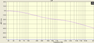

P.S. Reminding my curve.
