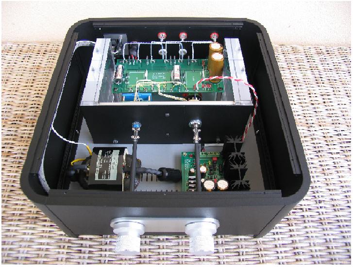

Pictures
Several pictures just for fun:
nude
rear
front
inside double box closed shielded with mu-metal/permalloy
closed ready to enjoy
Hey, that's top notch. Mu metal sub box, heavy R-Core double mono, Teflon caps even in Riaa, 500mA CCS, remote sensing, top dollar lytics, cables... Bravo. Expensive build, for sure. I hope you find it worthy VS other things phono you have listened to, because I feel a bit weird when people are pouring so much money and time over my ideas. Thanks.

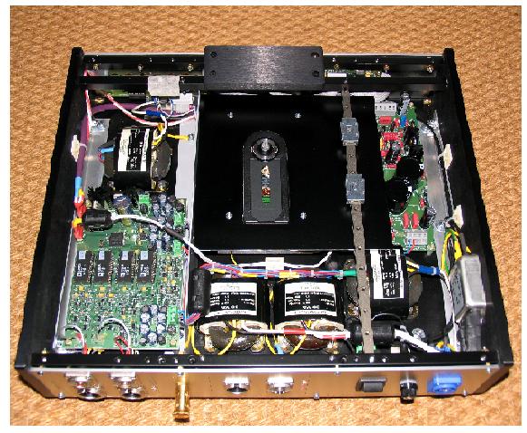

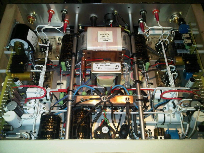

@Salas
Thanks Nick, now I changed the Koa & the Takman resistors for Kiwame & Caddock MK132 also the trimmer now is a Vishay 15ppm instead the standard Bourns, paralleled Caddock TF020 1Meg RIAA resistor, between PSU & regs power cable Cardas 17,5AWG, signal cables Cardas 2x24AWG shielded, Neutrik powercon 20A instead standard or boutique IEC connector. NO HUM thanks to double chassis, incredible low floor noise when no play music is really the SILENCE singing. I think that your design merit all these very good components, a lot of time of work, a lot of your patience, a lot of money, etc. But I'm proud & you must be proud also for this great phono preamp. Never will have enough words to say THANK YOU SO MUCH.
