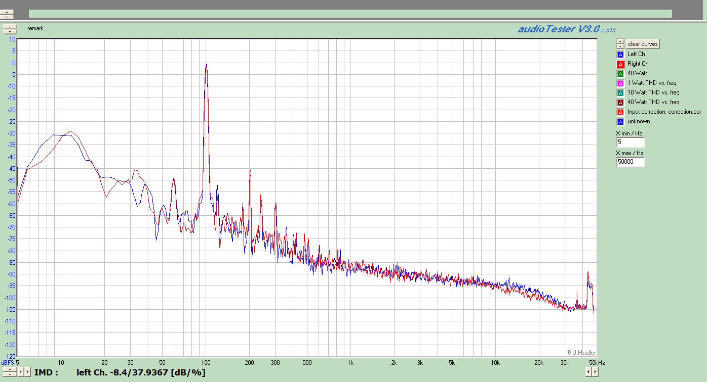

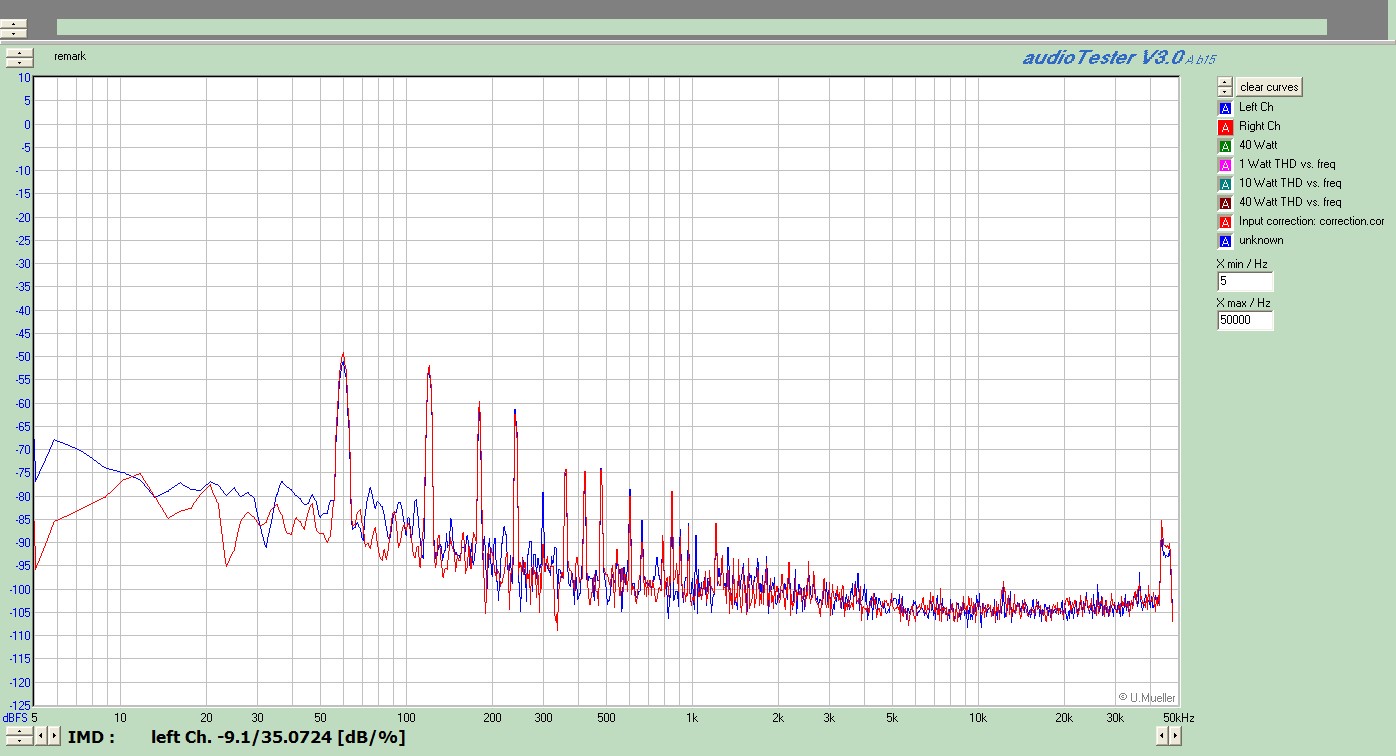

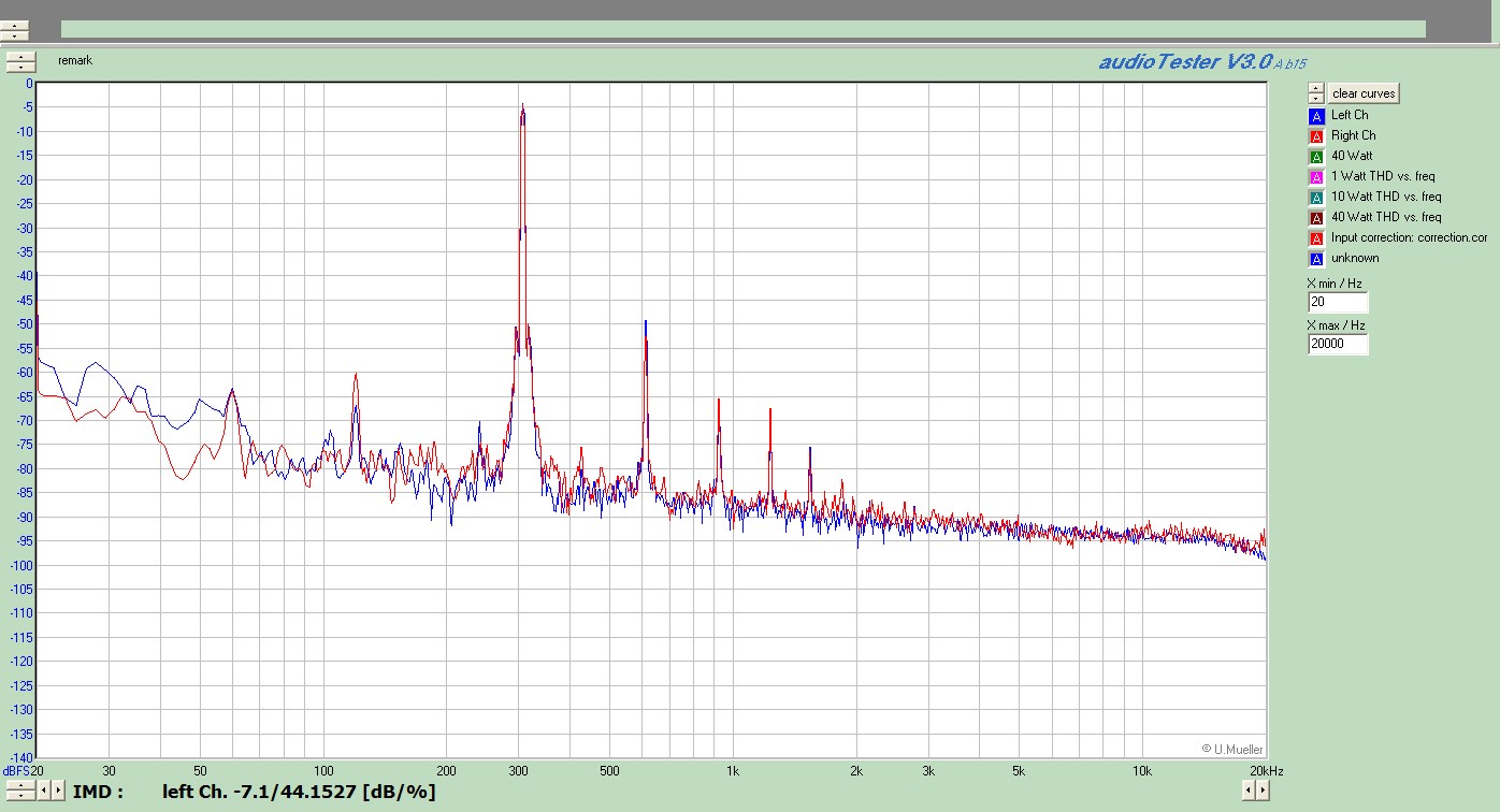

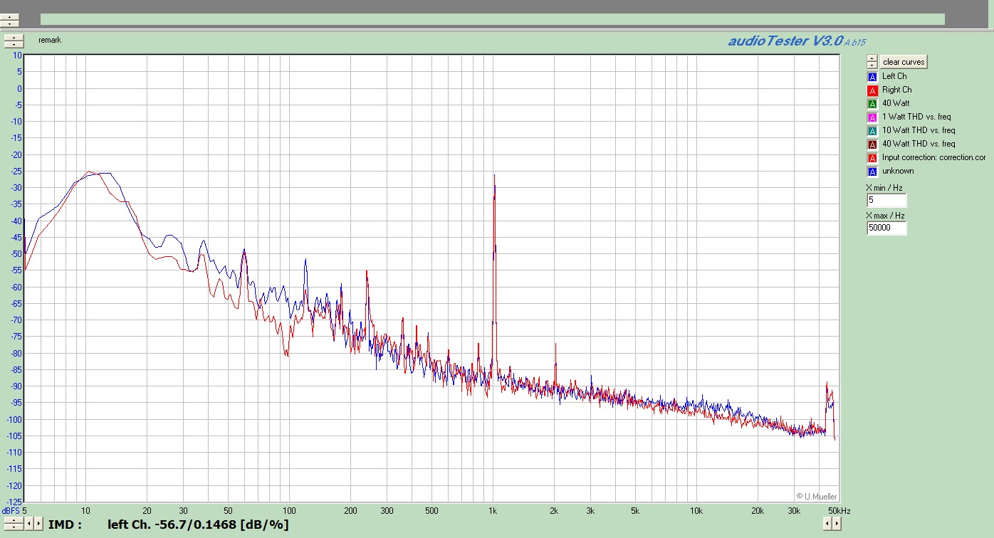

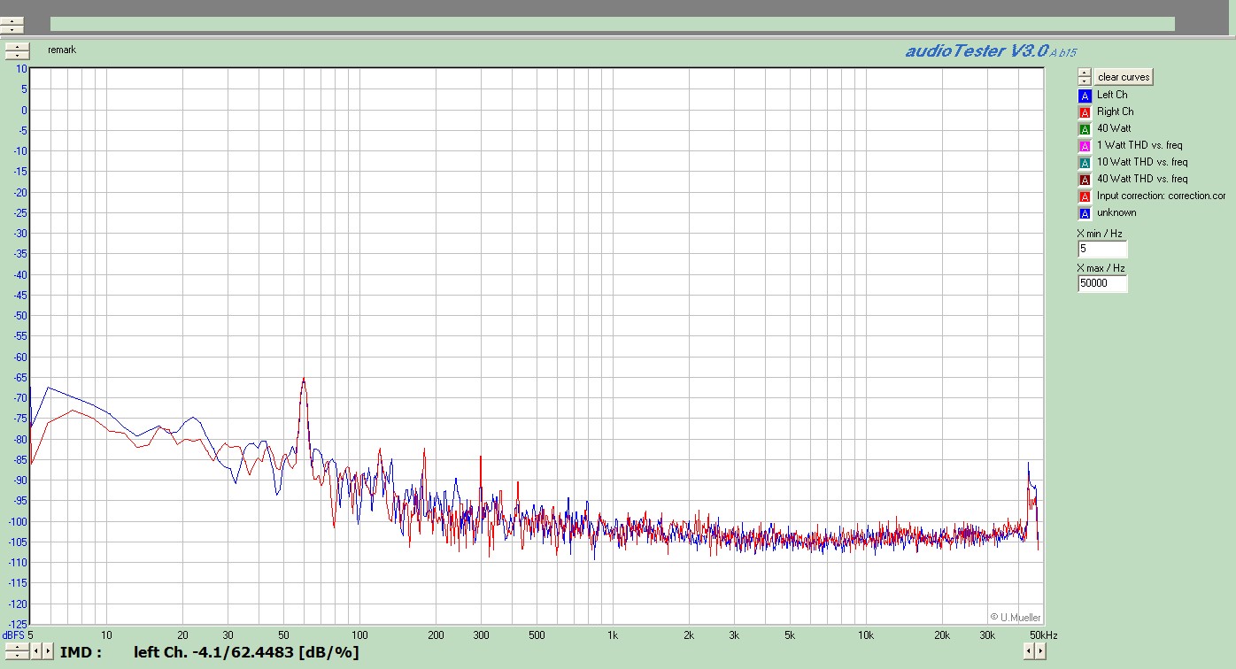

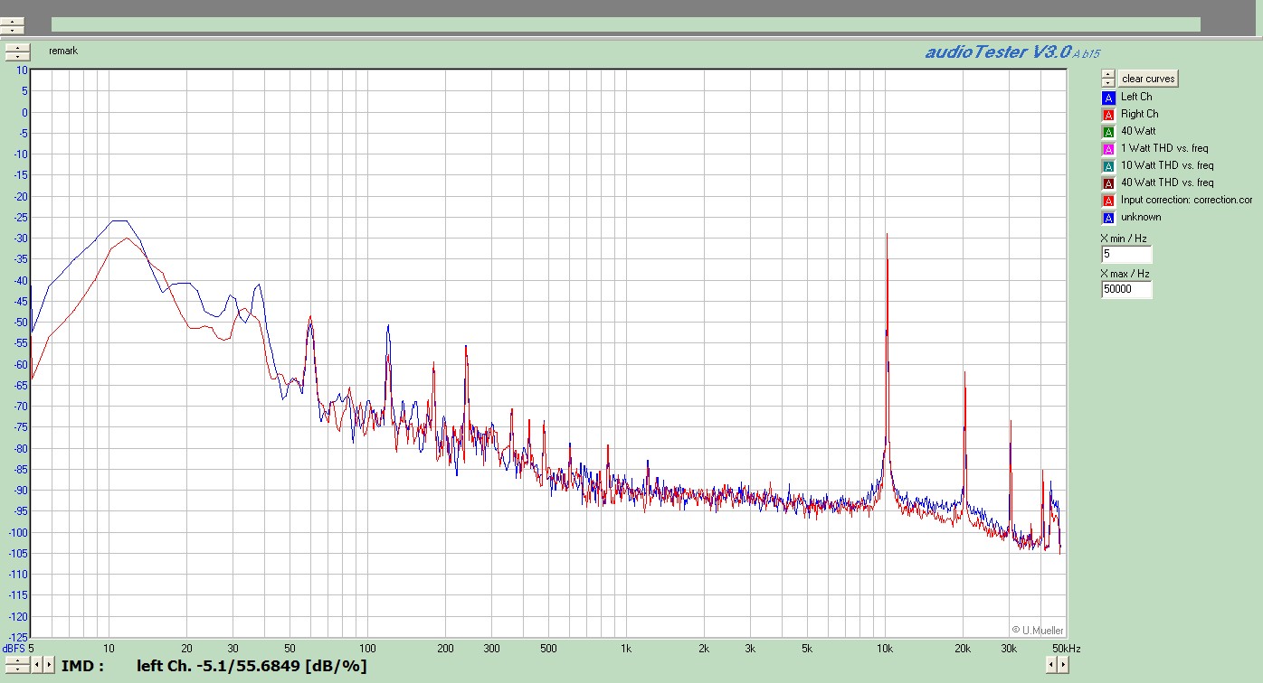

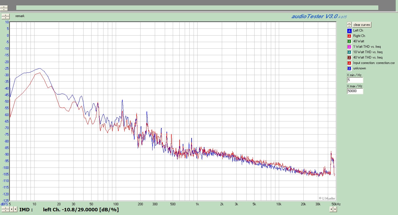

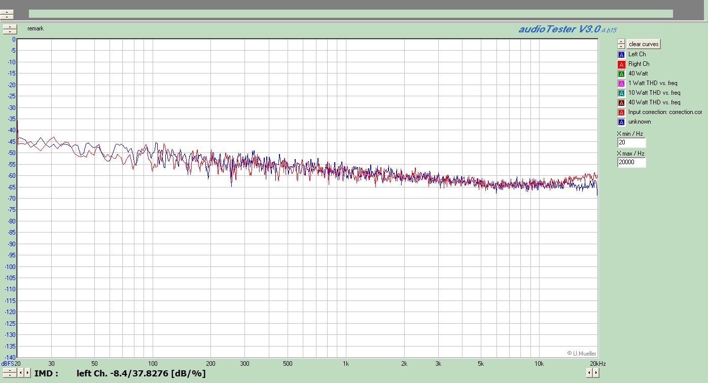

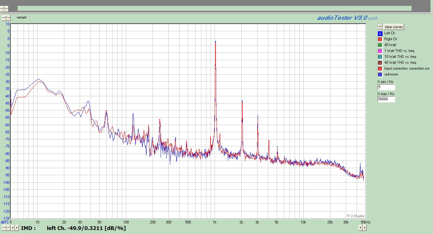

Finally got around to measuring the test lp today. In general I am not overly impressed with my isolation of 60Hz and associated harmonics. See attached. I'll let you judge and offer suggestions.
I can see that the Arm Resonance is 10.5Hz which was close to Salas predicition. I also see alot of rumble.
What I find interesting is that the 60Hz + Harmonics is not audible. Certainly measurable. I used the same basic set-up and cables as I did with the 12b4A preamp pesurements (which I had good measurements) so this time I feel it is related to the TT, Cartridge, and Head amp.

In all the plots I overlayed L and R channel. Very insignificant differences.
Now I need to get rid of the ground loops. P.S. I do have a gnd lug on preamp now and was used.

plot7 shows 40kHz passing right through the whole system. That, for me, confirms that the phono replay system must strive for a flat response to beyond 40kHz to keep all the different components of the signal in the correct ratios.
I also note the odd harmonics of the 60Hz mains frequency. I wonder if this is worth chasing further, or are you reaching the limit of what can be suppressed?

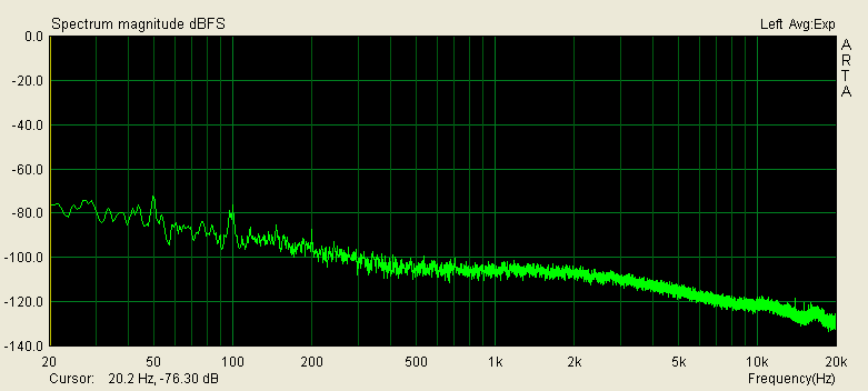

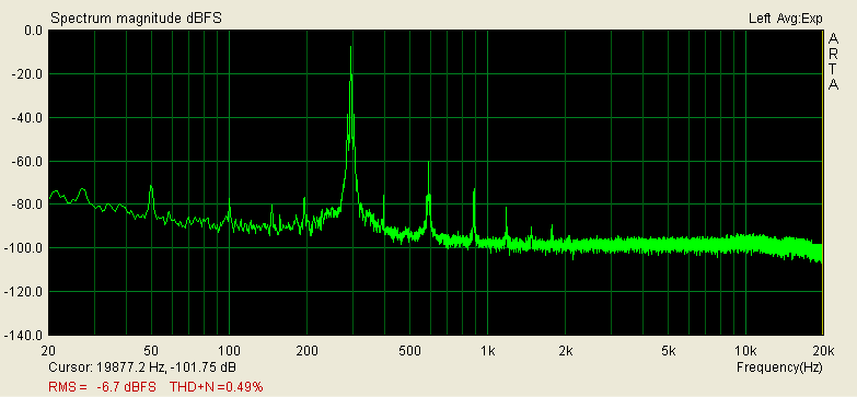

Here I attach a 300HZ +12dB modulated groove FFT with 103R on Mission 776 arm and Walker 58 TT. Gain=61dB. Also the residual FFT of the locked groove on track's end. Test LP is HFNRR. Phono & TT on rack, many different mains and signal feeds very near.
I first posted them in an interesting mini research for what's to get from a record in that thread. Interesting to read a bit further there and to see some more measurements and talk from some more members.
Now if such harmonic pick up as you show is really happening in the audio system or in your FFT test loop, I don't know, can't judge from afar.
Andrew, please ignore anything above 40kHz. That is an artifact of the test set-up.
I am not sure what you mean regarding the odd harmonics of the 60Hz mains. I would hope that this could be improved. I have never measured a TT system before, so my baseline is Line Level and amps. I am not sure what is good or bad.
There is no ''lost constant'' zero adding resistor thing in his CCT, its a straight Lipshitz RIAA so I would be doubtful about the filter passing that. Could be a card+software thing as well.
I can clearly see isolated peaks at 10, 20, 30 & 40kHz, before the rubbish comes in.
That to me seems like all frequencies upto 40kHz are passing straight through the reproduction chain. The rubbish prevents me seeing evidence of what is passing in the range 41kHz to 100kHz.
The odd harmonics of 60Hz are at 180, 300, 420, 540Hz. I can see them in addition to the 60Hz in plot1. Are there 660 & 780Hz in there?
You said they were inaudible.
That is what made me suggest whether they are worth chasing.

I would ask Scott if there is some octave scaling going on in the software for those charts?
P.S. On the last pic he actually replays a 10kHz tone.

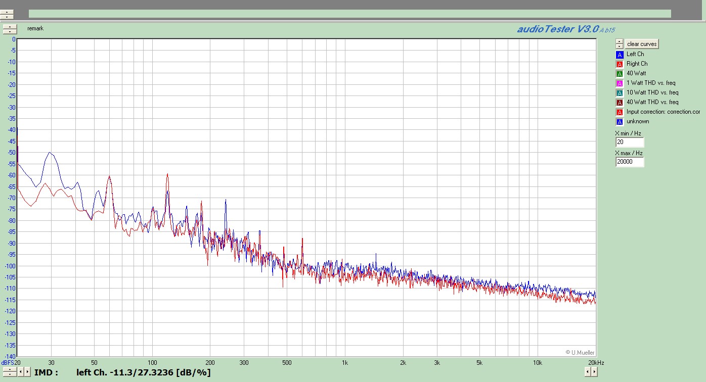

Okay here are some tests using the HFN test lp. Sames tracks as you posted Salas. In addition put the pink noise on as well.
I put the scales the same as well. I can creat the full range if needbe.
I do see a difference between channels using the pink. Right has little more pick-up in higher frequencies. That does compare favorably to my listening experience.
Those settings clean things up I see. Looks much more agreeable now. My 103R has more last octave HF hump on R than L too. But it best averages between L&R after being run in, azimuth and anti skating is reset for all 3 bias tracks spanning start-mid-end of the 2nd side of HFNRR test disc. TT levelling will play a role also. But see your 15n Riaa capacitors are surely matched first of all.
P.S. If I lift the arm the mains double harmonic isn't there. It passes on the record, must be the motor. Your TT is a bit fast, mine a bit slow the FFTs say.
