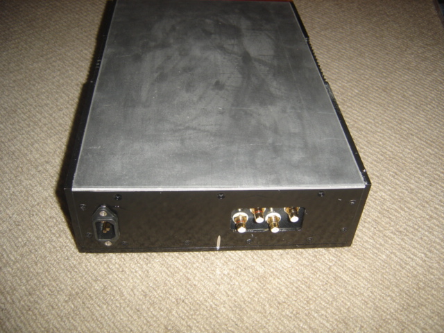

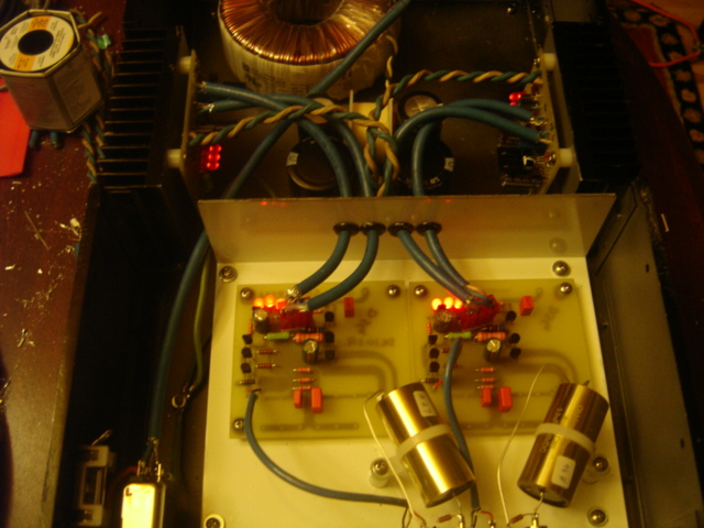

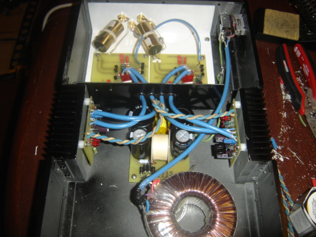

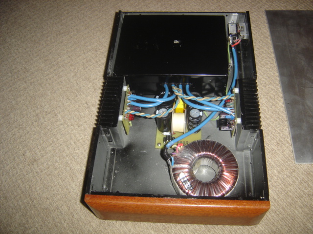

These are some photo's of the Salas Simplistic Head amp as built so far for the Denon 103R cartride. The external chassis is 1/4 inch aluminum plate, the shunt regulators are mounted on heatsinks integrated with the external chassis. Internally the RIAA circuit is fully enclosed in a two piece steel box. RCA jacks are mounted to the internal chassis and protrude through the external to keep the shielding intact. The output caps are Obligato 3.3uF. They will be bypassed with ft-3 teflon caps in the final stage. The build has no audible hum or noise. Even at full volume. As it stands now it is built with temporary RIAA and coupling caps. The "final" ones should be here next week.

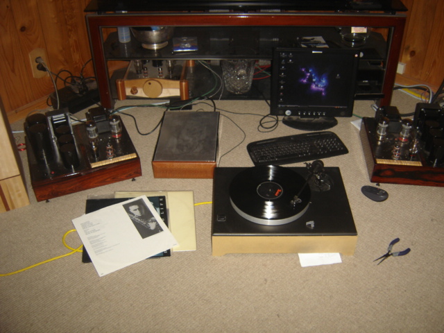

The turntable is a stupidly modified Ariston Audio RD80. Magnapan Unitrack I tonearm rewired with cardas shielded direct to the Simplistic. The plinth will be rebuilt shortly. For right now it is sitting on the floor during the testing.
I won't comment yet on the sound because of the final to do list and the fact that I am still in shock that I have not had a turntable in 20 some years. I will say that it is extremely detailed and I am happy even at this stage.
I also attached some photos of the overall system.

Splendid work. Lose the Wima interstage caps for FT-3 Teflon on first chance... They are the most influential. You miss a ground lag, or the arm combines chassis ground with signal return? Any close up pics of the DL-103R on the Magnepan?

DCin are red for right channel & black for left channel regs., both are AKG * NEOTECNICA * NEUTRIK Low Noise - High Quality professional microphone cable that don't use for signal but are shielded so for mine point of view perfect for DCin, the shield only connected in the regulator togheter the gnd cable, PSU only connected GND cable & B+ (shield not connected).
N.B. photo regs. DCin aren't connected for testing PSU voltage.
