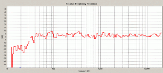

Some medium size two box towers of my design with PHL mid, Audax TW, and 2xTangband car audio oval woofers. Closed box in the lows, restricted flow vent in the mids. Here is their true room response with RTA (not windowed MLS).

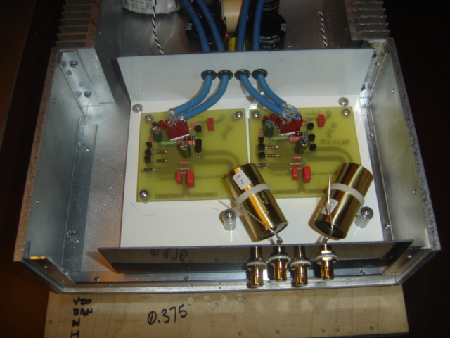

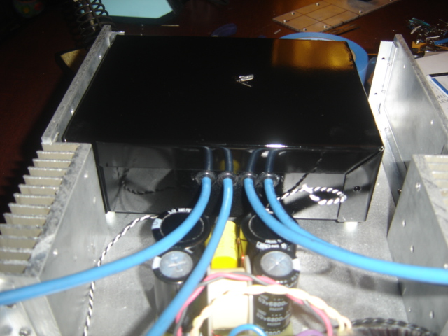

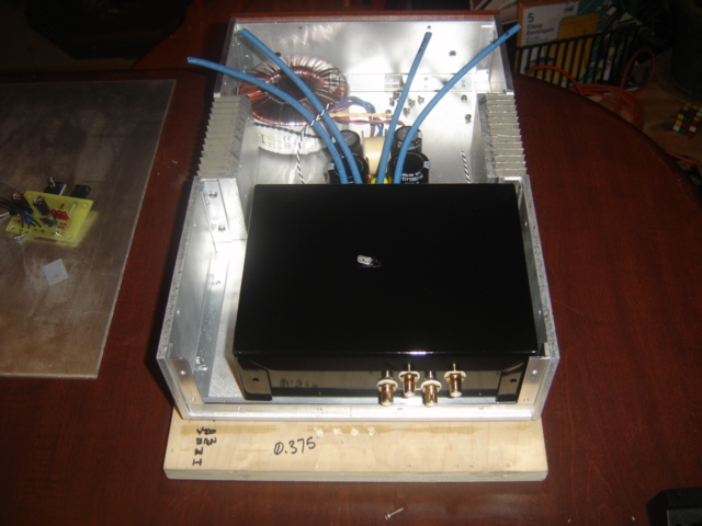

A little bit of update for peer review. Attached are photo's of the steel box mounted in the chassis. I soldered a ground connection to the top and bottom and intend to run it to the chassis ground stab.
Another photo shows how the pc boards are mounted in the box with the output caps leading to the RCA connectors. The blue hose is the Force and Sense that will lead to the shunt regulators. They will be mounted on the heat sinks. Initially I will use the toroid transformer shown earlier, but after reading up on the Rcore xfmr I have one on order and will switch it out at some point in the future.
In the photo, I do not have the rear panel attached as I need to mill out the opening for the RCA connectors to pass through and mount the IEC power conector. I still intend to run the AC mains in a shielded cable or in some steel pipe to minimize the pick-ups. I made the box big enough to be able to change out the pc board with new designs if need be.
Let me know what I could do to improve it. Thanks
P.S. I have some temporary riaa caps installed while for circuit testing, I hope the Russian ones arrive soon.

I say its a very nice job for housing high gain low level circuits no matter changes in the basic pcbs that might be or not. Including the minimum field R-Core and already having wide voltage adjustment range in the regs you are well equipped.
*Give it a go with the temporary caps to see if everything works without mistakes meantime.
