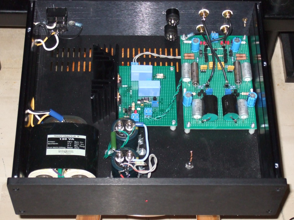

How about if I make the box from steel? The AC mains will come from the back corner next to the RIAA boards. The idea of a piece of steel between the heat sinks is appealing as it is very simple but I am afraid it may not shield it from the power line noise.
The AC mains is dangerous for inducing hum. Even if its near enough to the TT cables outside the box. Use steel plates for the sub box to enclose the phono preamp, even at the bottom. You can also mount the toroid perpendicularly if the height of the box allows.
The safest approach by my experience is 2 half width boxes, even one next to another on the rack looking like a nice full width combo. One receives the mains and has Tx, rectification, filter. A DC cable* goes to the main phono box that has the regs and Riaa preamp. The AC power all the way far from the side that TT input cables come in.
*Using XLR cable, shield connects the 2 chassis, the Tx & filter chassis is mains grounded.
** I use single chassis too, but I arrange across width, the mains are coming in as far aside as possible and an R-Core is tolerated. A toroid is offensive. Even with such measures always at least one channel will pick 5-10dB mains on FFT. Don't know if not if there was a steel sub box too. Me I don't mind a -90dB or -80dB single hum band even on my 95dB speakers, I know it will pick up probably when in the rack with the TT cables coming in near other mains feeds and equipment anyway. But FFT is your friend, just don't carve the box design in stone before you got all your parts and you are sure about the Riaa PCBs are dead quiet also, leave slack for changing your practices before final assembly. Low noise-high gain, is a bugger.
Ok. Thanks for the picture. I have a little room to play to keep the AC more seperated from the RIAA. At some point I will build a second enclosure for the Tx and PS board. As you suggested, I want to get the circuit up and running first, learn from it and then move on to better optimization. Ultimatley I would like to have seperate tx and PS boards for each channel if this really does sound as good as it claims to be;-).
In the meantime I can make the internal steel enclosure large enough to give room to play and as a secondary precaution twist and shield the AC mains in "conduit". The IEC connection is already shielded so I just have to be mindful of the mains wiring itself and properly bonding the shields. The RCA in and out can be kept on the other side of the chassis to keep it as far from AC as possible.

Just rearranged the riaa layout to minimize loop area... look at the pdf 🙂
It is better than ever but still sensible to the "opening the lid" effect.

Say the LF noise is at -110dB to -100dB relative to 0dB=1VRMS output depending on gain and psu etc. and then you got a mains 50Hz or 60Hz hum band picked up by a field or a loop in the box or outside and that pokes at -90dB.
The lid must be always closed in a phono.
