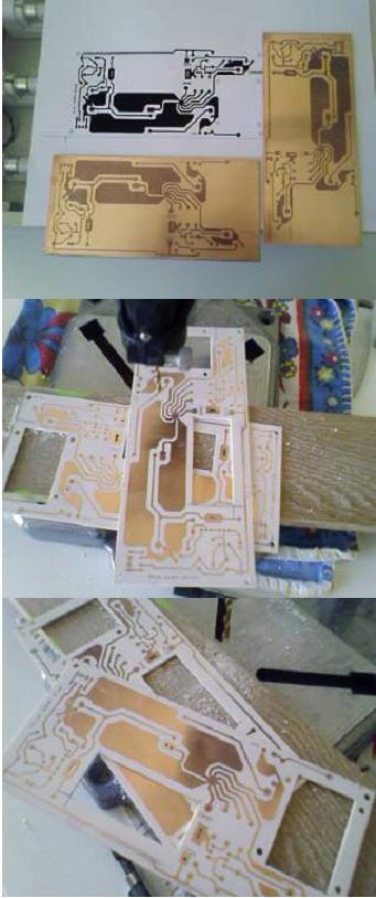

Please post some pictures of the pcb (after you etch them).

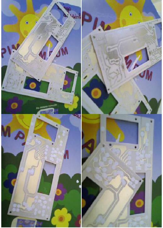

Right now I only have this pictures (from a mobile phone).
First set of pictures, etching and drill.
Second set of pictures, silver plating and preparation for varnish.
Output capacitor and FT3 will fit on these square holes

I see what you mean and I believe you are correct, but when I draw this PCB the main goal was to provide a ground plan ( I'm not sure about the english designation) to those big silver mica capacitor's, later on I extended that to other small parts in the PCB.
I don't know wich is better, probably get more damaged than benefits, I don't know.😕
Next time i will take that on account!
P.S. I only do electronics on a hobby basis, mechanics is my main goal.🙂
Yes, it looks good.
But a comment to the grounding: afaik it is not good to change from wide traces to narrow traces and vice versa.
Specially not when currents are flowing, what is the case for the grounding, specially between the bypass caps.
Franz
/Edit: try to explain (afaik): different size of traces is resulting in minimal differences of conducitvity eg. resistance. When currents are flowing this will produce voltage differences on the grounding traces. And this is to be avoided. Better use one trace width, as large as possible.

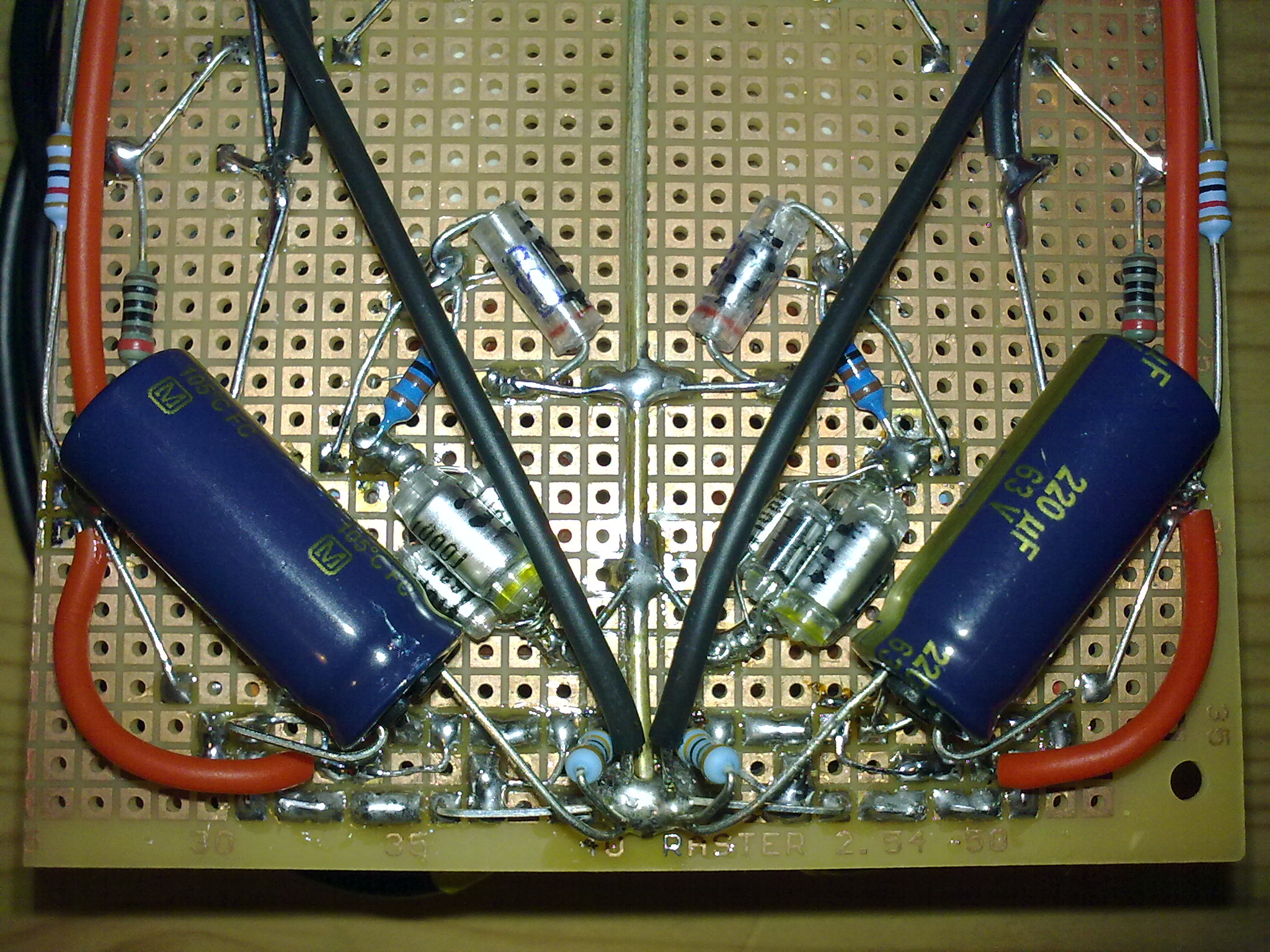

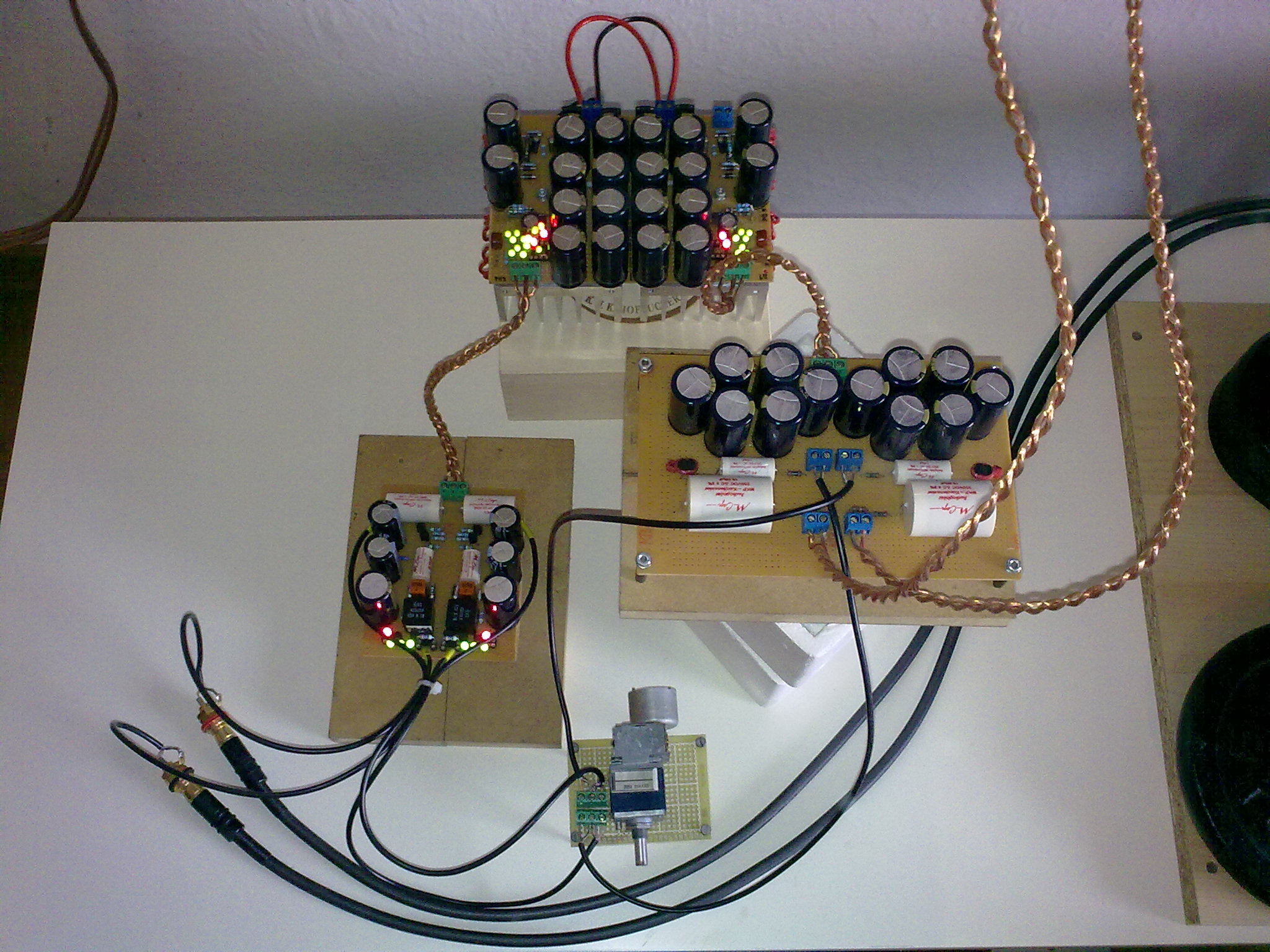

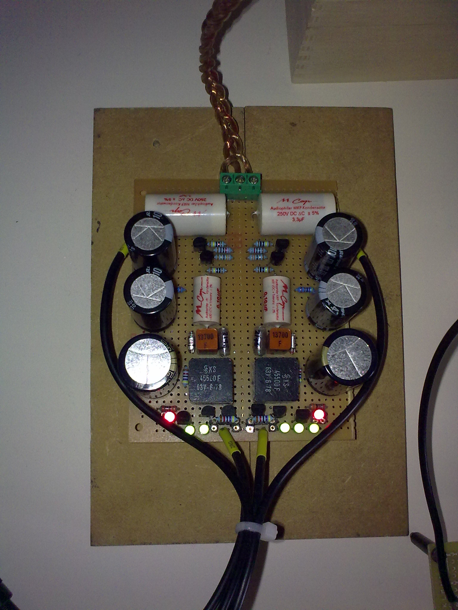

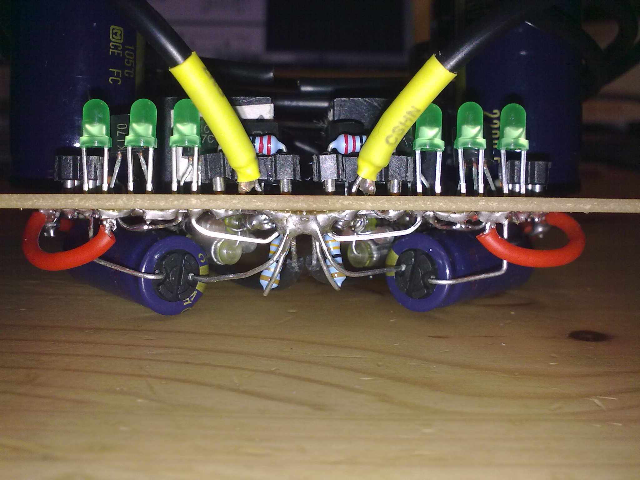

I have been away from this thread for a year or so...but since then I have built the 48dB version of the NJFET RIAA. It's for a complete system I'm building for a friend of mine.
Construction...The coupling capacitors are Mundorf MCap, all resistors are 50ppm/°C metal film (matched to 0.1%) and the RIAA caps are NOS Siemens&Halske styroflex, paralleled with smaller styroflex to get the final capacitances required. I was lucky to have access to a component bridge.
The JFETs are matched L/R and all within together 0.2mAvor so. The input JFETs were measured at three different currents to match them for linearity as good as possible.

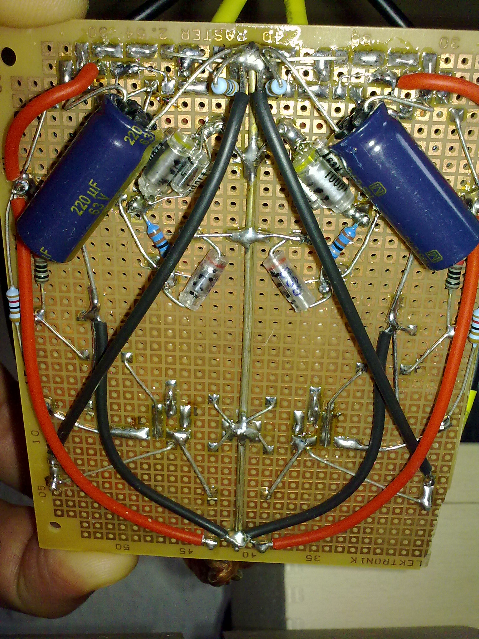

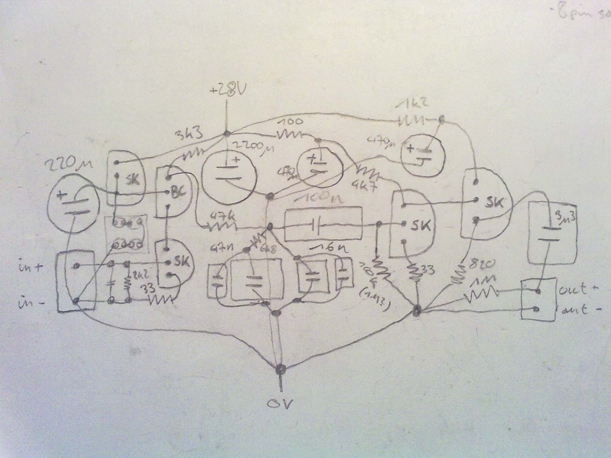

From the schematic I drew a layout for P2P and started soldering. I employed a mixture of star grounding and ground-follows-signal, with the input being the central ground point. The whole board (stereo) measures 10x8 cm.
For the bootstrapping I used a BC547C, currently operating with 7.96V/7.93V base voltage (L/R). The supply voltage is 27.20V/27.20V.
System...The output high-pass (3u3 and 1M) is designed to have -3dB@12Hz when it sees a 25k load. I run the RIAA into a B1 with a 25k pot at the input. The main amp is a Mini Aleph working into FE108ESigma horns. The TT is the only non-DIY piece of equipment. It's a Pro-ject RPM1 with a vintage (read: older than me) Shure M75 from my mom's old TT.
Noise...With no record playing and the volume all the way up (mind you, it's a B1) I can hear some noise and hum from the speakers, which is most probably picked due to the open design. At normal listening levels I have to put my ear right next to the speaker to hear it.
Sound...Well, what can I say, it's the first time I'm listening to vinyl outside of a club, and compared to any digital equipment I have heard so far, it's just lovely. It flows, it's just right there. I account a big part of that to Salas' RIAA.
That's about it, many thanks to all you guys for developing and pushing this design!
Dave

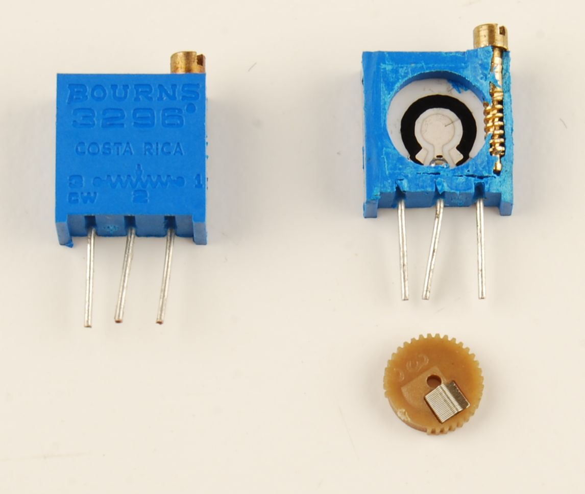

Hi Salas,

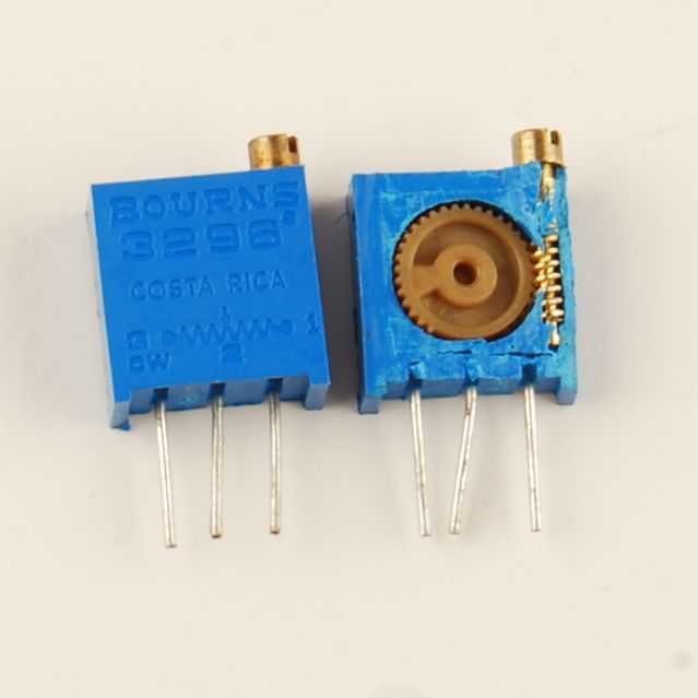

I see you're using multiturn pots in you design. Here's how they look inside.
Personally, i don't like them (they sometimes creep). But honestly, I love the vuvuzelas, from a distance at least...
Hey, thats nice DIY! Congratulations. It certainly needs a box to be sure about hum residual isn't field pick up or needs some grounding tweak. Multiturn trimmers are mainly problematic when there is some appreciable power on their wiper, its good to sub them with resistors after finding the best value for bias by watching THD in experimental builds.
P.S. Since you got your 47k cart load resistors on mini sockets, try 68k and 100k also for your Shure, maybe there will be a finer combination or not. Its easy to test.
