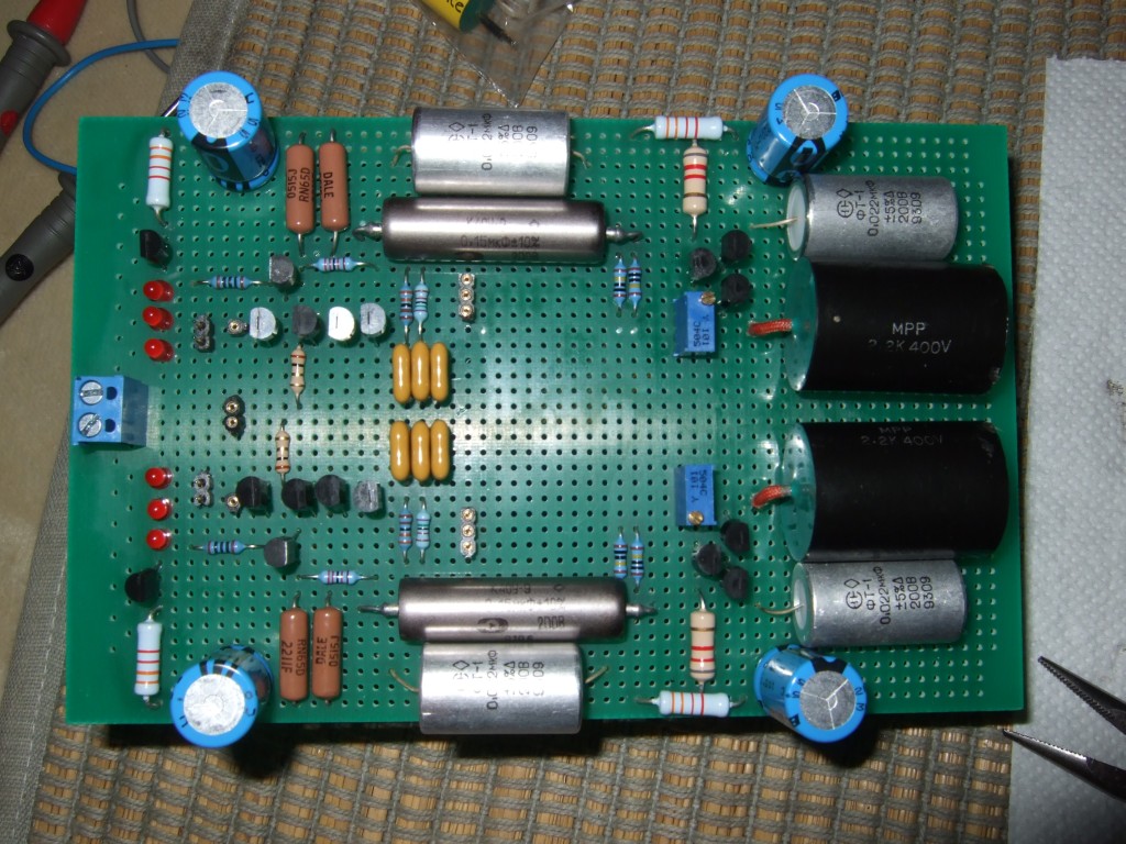

Imagine the BIG change BG does that now I have to adjust the value for C2 RIAA capacitors: after 16nF024 now 15nF977 & possible will finish 15nF930 or less.

Just finished my main PCB according Salas instructions.🙂
I attached files for main, copper and silkscreen in PDF format.
Right now I gonna prepare my self to etch my first PCB.

Yes, it looks good.
But a comment to the grounding: afaik it is not good to change from wide traces to narrow traces and vice versa.
Specially not when currents are flowing, what is the case for the grounding, specially between the bypass caps.
Franz
/Edit: try to explain (afaik): different size of traces is resulting in minimal differences of conducitvity eg. resistance. When currents are flowing this will produce voltage differences on the grounding traces. And this is to be avoided. Better use one trace width, as large as possible.

In your pcb I don't like IN gnd + RL gnd not referred with thier own track to star gnd. If you connect them to D4 gnd and R2V gnd, you mix up Signal gnd and Power gnd. Not good at all.
Take example from OUT gnd and R8 gnd: correct routing.
Plenty of space to fix this problem....

I forgot thanks for advice I will do "a la llauna" catalan typical foot🙂

Nice sovjet caps on your board 😉
Bypass or also for RIAA?
