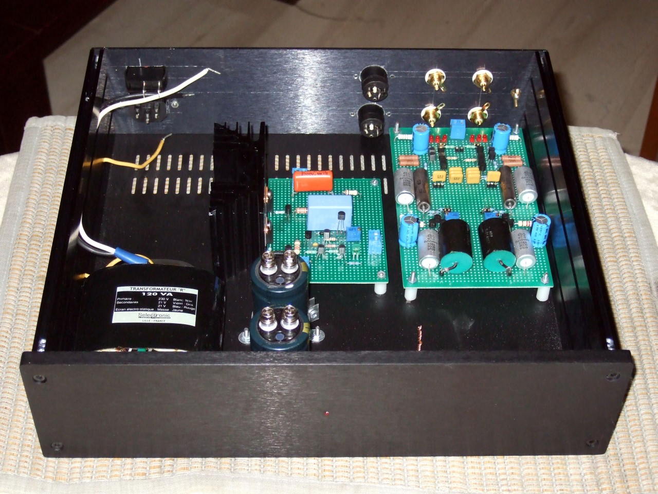

Riaa upgrade
@Rcruz
The last buy to upgrade RIAA:
0.047uF / 1000VDC Obbligato teflon😉
@Rcruz
@Rcruz
Is that SCR Teflon & tin foil, or just Teflon?
Hi Merlin..... I am looking forward to read your comments on this upgrade 🙂
FS: 2 caps silver mica 47nF 500V news 16€00 special offer 8€00 each + paypal + shipping fees😀
I had the blue Teflon only, very early SCR samples don't know if techniques changed, was resolute but not as smooth as FT1-2-3 CCCP, was rather bright to me. Lets see if this one is a different animal. Teflon and tin is V-Cap too.
Blue are teflon metallized, now mine foils are in break-in process, it's really a different animal: nothing to compare vs Obbligato polypropypelene aluminium foil, I suppose teflon foil break-in is very similar to BG: initially a lot of difused bass & final break-in dep & tight bass & ultra hig-resolution mids & highs, all film & foil caps as experienced needs a very long break-in process I assume it's due to itself construction, Obbligatos polypropylene aluminium foil the break-in was also very long but the sensations was opposite to teflon foil so without mid-lows & lows & only giving mid-highs & highs extra smooth so was the initial reason that disagree, now are after the break-in sounding vey well but isn't teflon. I chosed Obbligato because are 1000V with very good relation quality-price I bought in Teflon Tin Foil 0.047uF 1000V | Diy HiFi Supply 35$ each the Reliable TFT Capacitors only arrives till 600V.
Do you know RIAA cap 47nF the frecuency range because it seems I hear changes in lows, mids & mids-highs so I suppose affect till 4.000Hz or a little more....
Resuming teflon film & foil is like BG the big difference is the mids & lows without loses highs resolution, nothing like human voice to test the differences between BG & teflon foil & the others lytics & films & foils.
Mine first choice for teflon was copper foil but V-Cap 101.03$ each it's a lot expensive, also are expensive the V-Cap teflon & tin foil 69.28$ each, I don't know Aura teflon from Auricap if are metallized or foil, I suppose are metallized like polypropylenes.
One question for the other RIAA cap will be enough 15nF? V-Cap have teflon tin foil at 58.78 $ each a little bit expensive, Aura have a teflon at 26.92 $ but I don't know if are metallized or foil if are foil will be mine 1st choice.

The 47n interplays directly with 2187us & 318us Riaa points, i.e. from lows to mids. Indirectly its relation to the smaller shunt highs cap plays a role in higher tones.
Thanks is where are more difference between SM & teflon film & foil.
What about to use 15nF for the other RIAA cap?
I'm looking for a USA surplus teflon & foil caps I will let us know because the price is very good 15$ each 15nF 200V 1% hermetically sealed metal case non-inductive extended foil with glass ends seals, I am waiting an answer about kind of conductor: aluminium, tin, copper, etc.
You have some custom idss and values, link me to the specific cct I don't remember your resistors, and I will tell you about 15n.
