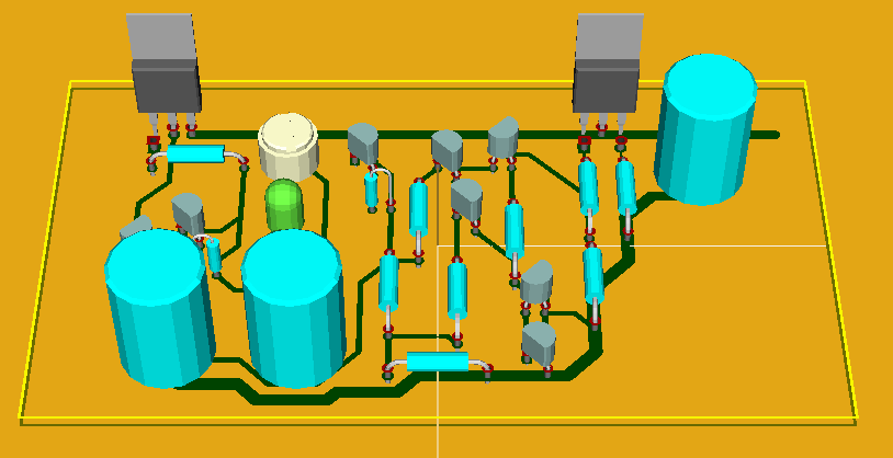

If you allow me a quick OT, I was working lately on a new shunt, which is besides the point really, because what I want to share with you is a little program that I really like. It's called kicad, and it's open source, freely available for windows, linux, etc. It is a schematic capture and pcb design program. It took me about a day to get up to speed with it, but it seems to be powerful and very capable of nice results. I know it's not eaglecad, but I think I like this one more. It even has a 3d view thingy, see attached 😀
