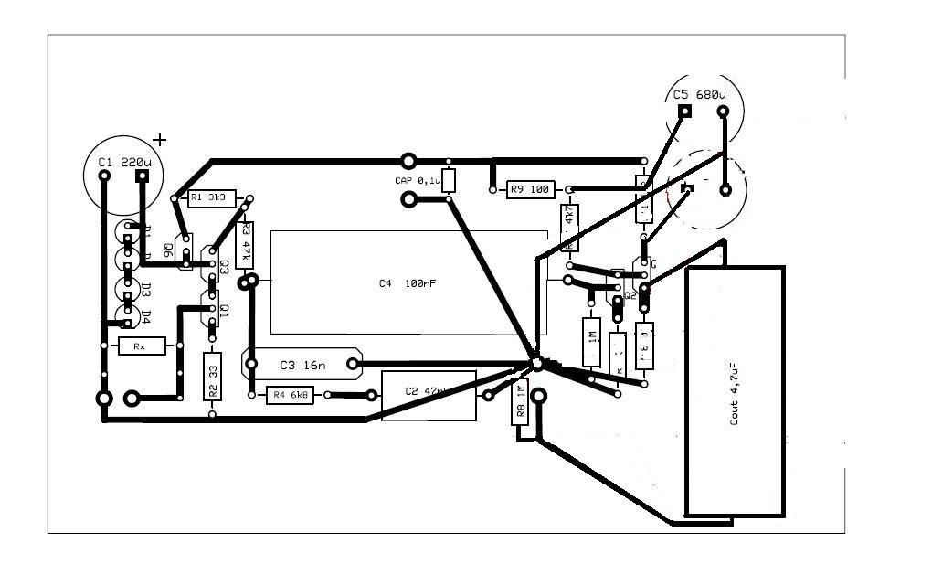

Rcruz- do you have dimensions for your pcb layout posted in post #2180 ?
I will include it in my next revision. Is this OK with you ?
Hi Pete
It is not a pcb... I used it to guide me in a p2p riaa.
There is a last version and the measures are exactly as in the pdf (10 x 16cm)

It is worthwhile, and much audible in this case. It controls the overall voicing tilt. You can overshoot to 16n1, but don't let it be under 16n.
Also, be aware of a small offset introduced by the probes and wires. My Fluke 87 indicates 0,4nF without a component attached.

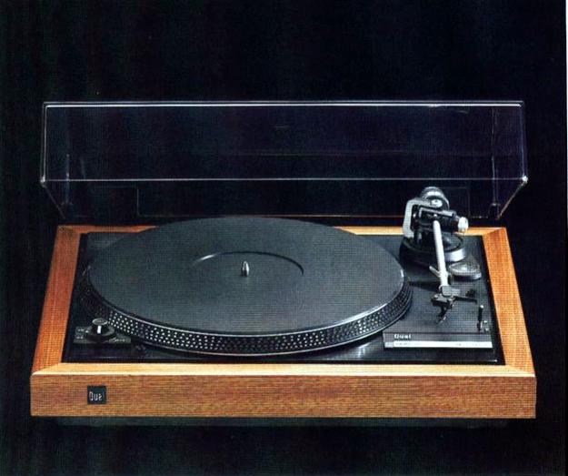

NB Nice tonearm Salas. Lots of praise still after so many years since introduction. Does your player have a heavy platter? The Dual 505 has a flimsy one :eek:
Not too heavy, 2kg, but it is non metallic, ''Tufnol'' as well as its sub platter, some very dead to knock on Scottish composite material. The whole deck is made out of organic materials, has wooden beams T cross three point sprung sub chassis. Its a Walker CJ58-MK2 that it was donated to me in wretched condition before hitting the dumpster. I have resurrected it from the dead with the invaluable help of my friend Michael. The arm got in to pieces and back, DIY arm lift, and finger lift, rewired with Cardas, it was hanging like a dead man's head when we got it, and we added some mastic around platter's bearing well after fixing the suspension. Luckily the motor and pulley were silent & intact, as well as the main bearing. I found that my best mat with that platter was an am antistatic, although I have even tried drummer's practice 12'' silencers and carbon fiber B$ high-end mat, among others, and of course VS directly on Tufnol. Its the mosquito plane of the 80's British decks and I love its feel good sound. It certainly took some zing out of the mix after replacing one of my full metal jacket SL1200 MKIIs. Technics has a greatly practical arm, precisely built, VTA arm base ring, and is dead pitch stable BTW, sounding robust and resolute with an MC cart. It matches the DL103 well too. I want a VPI HW19 IV with an SME IV and a cleaning machine when I grow up, so Nicoch will stop nagging me about my dusty vinyl records.:D
I used to have a Dual 505 MKI with 881s on a special arm head shell adapter when I was a teen, it does not have ballsy lows but it is open and resolute. Its due to carrying too light a metallic platter you know. Maybe you can dampen its platter underneath and try some mats.

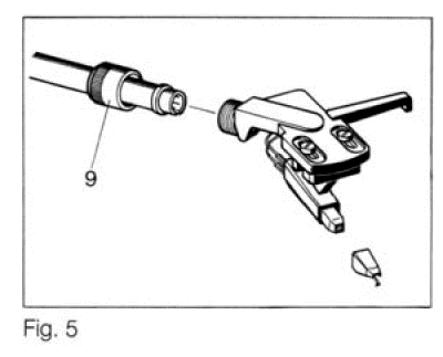

The first 505 had a special head shell for accepting only its OEM Ortofon. It could lock or release easily with the cue lever and used surface contacts at its top between the cart and shell. Like those in PC memory chips. It was probably thought out for having ultra light cart as well as arm without discontinuity or mounting and geometry hassle on factory assembly. That was a low budget deck that had a very decent well adapted MM cart for mass and compliance. Non the less there was an original Dual flat sub shell spare part that had aluminum wings and you could mount other carts. Alas, with heavy enough carts it could hang a bit at its tail and make a silly contact. The deck proved so good and popular that they did the decent thing with the 550-2 and included a removable head shell with rails as normal, so enough people could attach the cartridges they fancied, still coming with its very good MM. This is the Dual deck you got. They even had a deluxe veneered chipboard plinth 505-2. VTA can play enough by changing mats of different thickness. Each mat will sound different for its mass and material. Damping the platter from inside, will prove very influential. Worth investigating.
