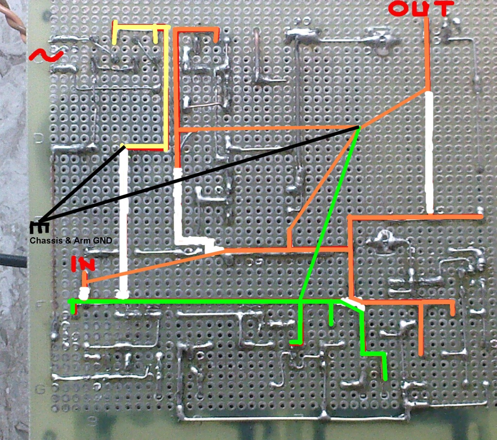

The big blocky redish are Lemco Silver Mica 47nF and 16nF 2% (purchased from a seller from GB on Ebay. They are 47,2nF and 16,2nF) than there is one Ft-2 100nF and the output cap is another Russian cap, K73-16, dry mylar.
About the hum: if the transformer is near or far the board the hum not vary. now the transformer is 1 meter away from the board. I think that the problem is the layout of my board. I have hum also with open input.
http://img29.imageshack.us/img29/1576/spa1282.jpg
if i separe rectifier and shunt from the riaa board may vary ?
Trace me the rectification GND, shunt GND and Riaa GND with yellow, green, and orange, I want to see if there is a loop.
Don't separate, it isn't field inducing, its better they are tight, good for shunt's output impedance and RF. I will see if there is another way to relate the 3 GNDs. Your caps are close enough for now. I don't know the quality of the output capacitor. Have you evaluated it before? I have only read that it can be a bit treble etched at times besides being very good in general, so the 16.2n maybe balances it by shaving off just a tad more treble than intended with a suggested 16-16.1n.

I compared the output cap with mundorf m-cap PP (white cap) and audyn cap Q4 and i like the sound of K73-16. Open, clean... i must evaluate more, also adding a Ft-2 as bypass. If i got a good working riaa i can spend some extra money for the components. The gnd: i don't see a loop; i did a test, i disconnect in and out gnd from the riaa. In this case don't work, the riaa has a cyclic beat (oscillation?) and the led's flash on-off (riaa's and shunt's leds)
http://img19.imageshack.us/img19/1576/spa1282.jpg
Salas you are a genius as well as being a kind person.
Now the hum is gone, only with the volume at max I hear a slight breath (shhhhhhhhh). And I'm listening through headphones.
When i build the second channel i must connect the star ground of the second channel to the star ground of the first ? star ground for me is where rectification GND, shunt GND and Riaa GND are connected together
No, you will have to make a chassis star earth using screw and nut, where you will connect 2 + 2 black lines from the channels. The black earth symbol I draw in other words represents that point. Also the tonearm grounding post with a wire there. The mains earth you will connect near the IEC socket to the chassis. When you will have stereo and will listen more, and play with your TT set up, VTA etc, tell me more about the tone. Maybe you will need just a couple of Shinkoh.
