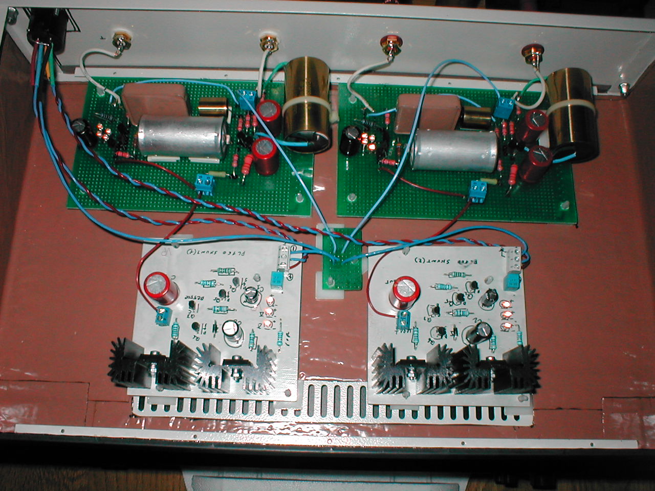

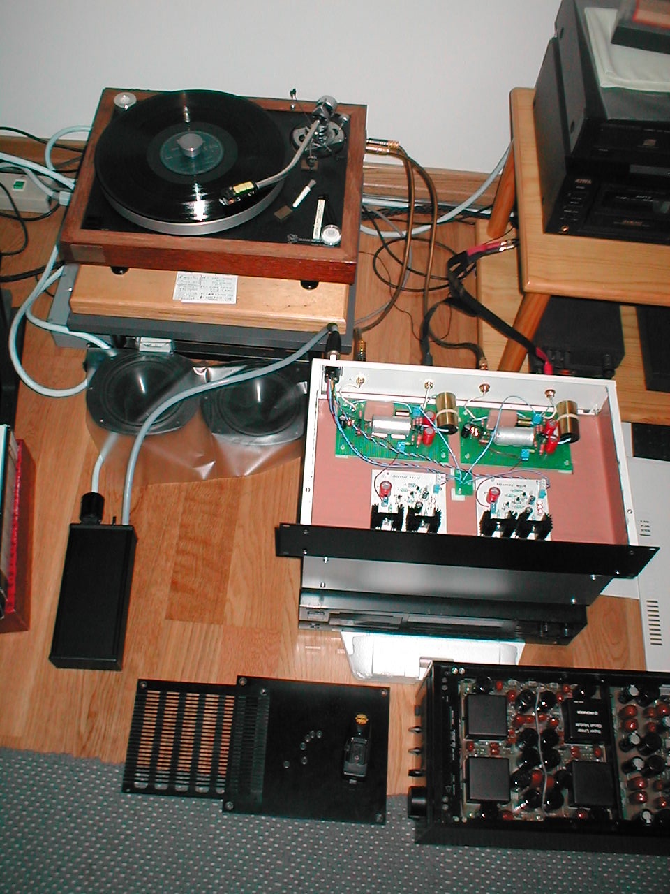

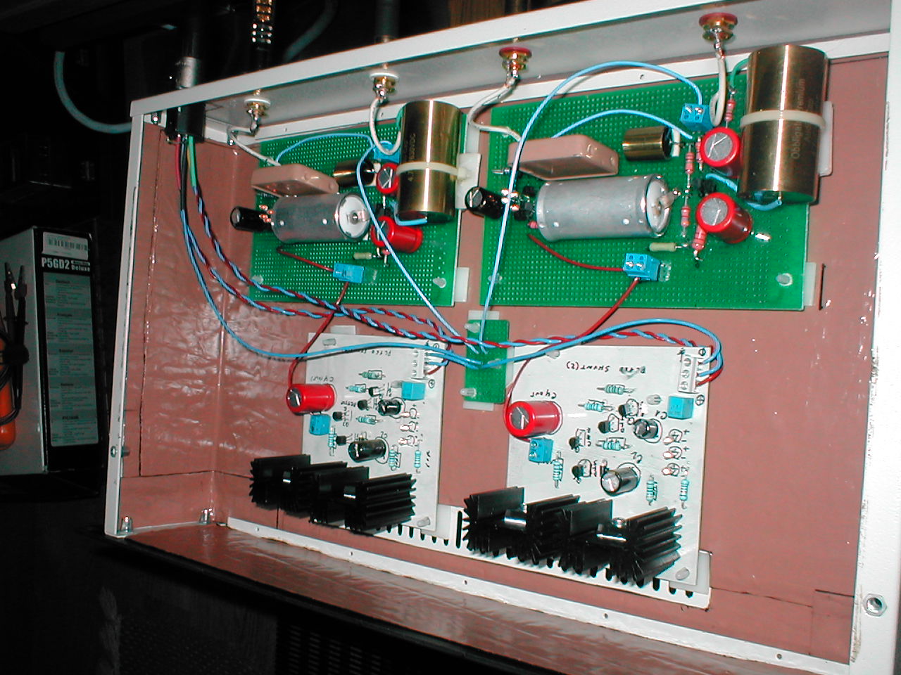

Some pics... excuse the bad image quality 🙂

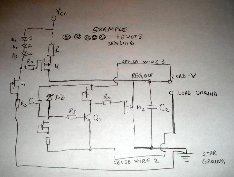

Looks good, but I would rotate the shunt 90 degrees and mount it so that its output is right next to the input of the phono stage. Right now you have quite a long wire between the shunt and phono stage. I would also connect the ground of the phono stage to the output ground of the shunt, those are like sensing points. In the other thread we talked quite a bit about how to wire the shunt output if its farther than 2-4cm away from the load.

I did not rotate the shunts because of the fins in the case... althou this one does not heat as much as the first riaa, the heatsinks must be placed near the vents.
The other idea is very important...
Must I create an output gnd on the shunt first or can I use the existing one near the shunt input ?
And If I connect the riaa gnd to the shunt, than I should connect the input / output gnd to star gnd right ?

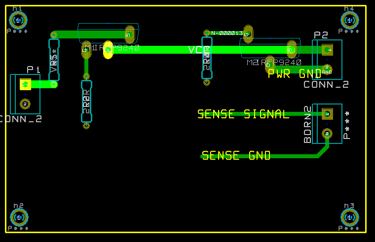

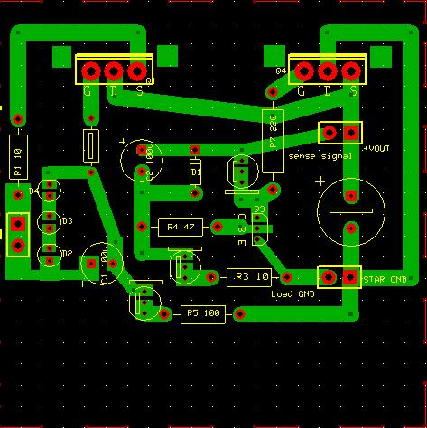

I'm not an artist, but this is what I mean. By the way, there is no need to do it if you're happy with the shunt as it is. I'm posting this to help anyone else who might have no way of avoiding long wires between the shunt and the load. Ideally the two remote sensing wires are twisted together and about the same length.

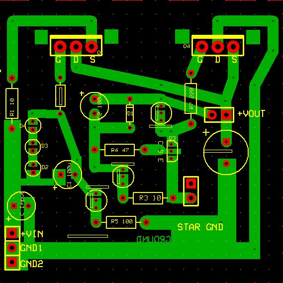

Ricardo, the track between drain of first mosfet and source of second mosfet is good to be straight, and short if possible. Depending on your heatsinks, something like this might work, see attachment.

Thank you for your attention ikoflexer 🙂
