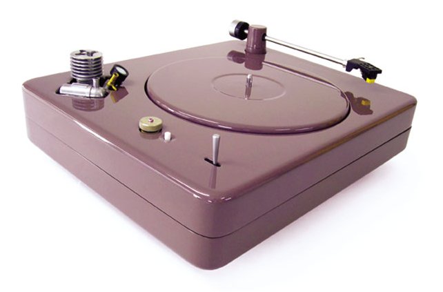

Wow very great TT !!! put an MC on the baby🙂

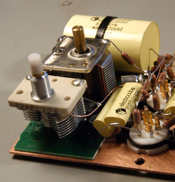

I see that there are some crazy boys ,and report that AM aircap (pf range) sound better than styrene :scratch:
look
