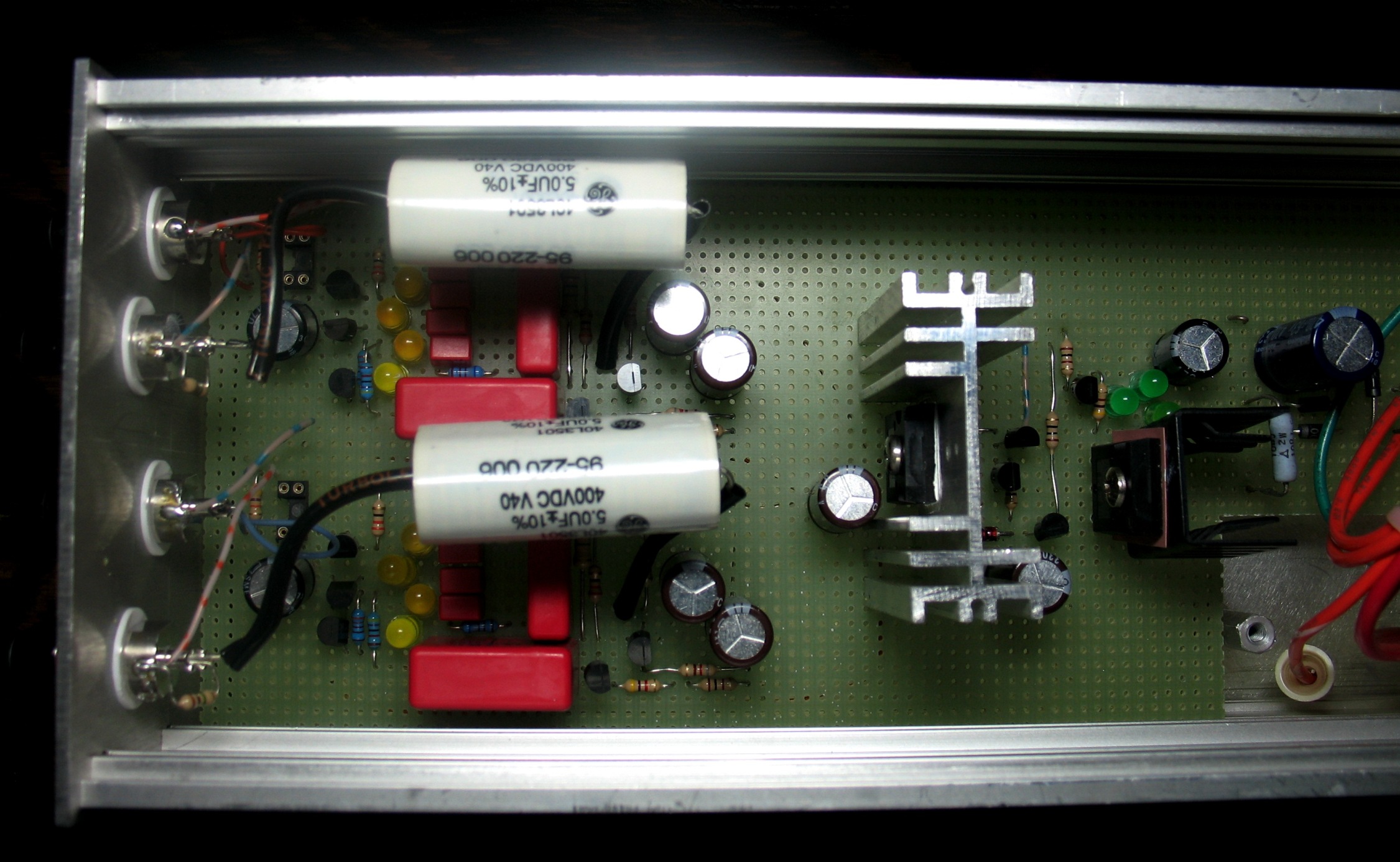

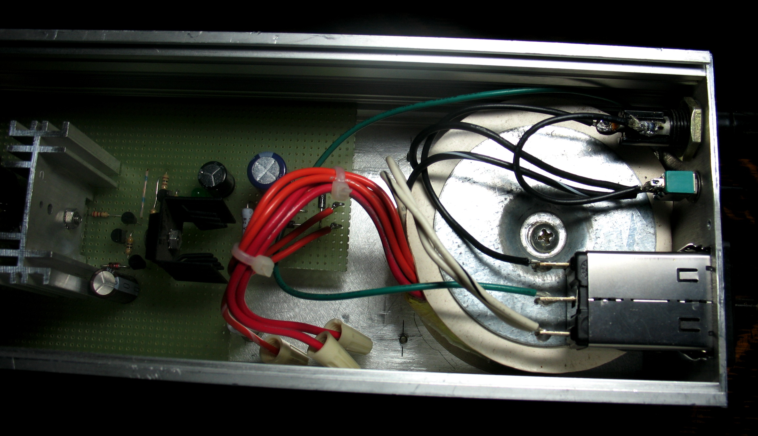

Hi all,
Haven't posted in this thread before, but I've been watching and I completed my build this weekend. Just got to listen tonight. Having fun so far. I think I need to do some work tracking down a very low level buzz. I've got to get the volume control turned almost to max to hear it. Thanks for all the effort so many of you have put into this project.
John

My signal ground is isolated to the circuit board. Ground from the power cord is only to the chassis. Do you think I should connect signal ground to chassis ground through a resistor or capacitor? The buzz is very low but I'd like to fix it. I'll experiment with different things and report my results. I didn't use a large filter cap in the raw power supply, only 470uF. The raw supply has about .6v ripple on my DVM but the 27V DC at the shunt has no measurable ripple with my meter.

No I haven't listened with the top on yet. I've only listened for about 20 minutes and then pulled out to take a few pictures. I'll try it with the top on next. I will also try connecting the grounds. My turntable doesn't have a separate ground wire but I can connect one to the turntable chassis, or try a clip lead for starters. I'm sure this can be remedied. I just need the time to work on it.

Sure, only make one expreiment at a time, so not to lose track. Your 0.6V ripple the shunt eats for breakfast, the buzz isn't on the power line, the main filter value changes the juice supply rate and has some impact on your final tone. Will be interesting to hear it with just 470uF when you get it debugged. Is it for a high MC cart? What is your setup?
