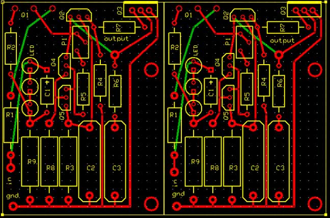

sesquialtera, the pcb you design is base on Salas' shunt reg is for sale or personal use? if you make it.. i would like to have 2 pls
I was planning on ordering only a few pcbs for personal use. If you want some, you can order a batch from http://www.expresspcb.com and use the file I have attached in a previous post. Be warned that I'm a newbie to this and have not real-world tested it yet!

Board size changed to conform with expresspcb's Mini board service.
That is so nice. Then its just to order it at express pcb
is it correct that you get 3 boards on that service??

Yes, that's my understanding.
Yep, you will get 3 boards delivered to your door for $60.85 in the US. I'm not sure what the costs are in other countries is, but the Express PCB program will tell you.
A trick to do on the mini board service is to add the component designators to the top copper layer to help with placing components. Also, you have a lot of space on the board. You can most likely scrunch the parts together on half the board, then copy/paste a second image of the board on the other half. Then you get 6 boards for the price of the mini board service. Just takes a pair of large hand shears to cut the boards apart.

Thanks for the great suggestions. I was able to scrunch the component placement to fit 2 on a board. Any issues with proximity of traces or thermal concerns (with the mosfets and the 5W resistors closer to each other?
Can you avoid double layer by routing the green traces differently?
