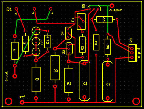

Simplistic PCB
I am thinking of trying this shunt regulator and have taken a crack at my first pcb layout. I am using the ExpressPCB software. I would appreciate your comments/corrections.
I am a bit unsure about the how much space to allow for the heat sinks - I have them mostly hanging off the sides of the board. My application will be for ~72 ma @ 250 volts output.
Thanks for any guidance.
Gate resistors R2,R7 must be very near to the gates and better be carbon composition. If there is enough copper track between them and the gates, the track's self inductance defies their purpose.
You are going to run the CCS for 72mA, but how much will your actual load consume? Deduct that from the constant current and multiply what is left with your nominal Vout. That is your final dissipation that defines the shunt Mosfet sinking needs. The first CCS Mosfet will dissipate (Vin-Vout)*ICCS. Use 300V DC input. The difference to your 250V out is enough, more is going to create extra useless dissipation on the CCS Mosfet. In general I would keep the Mosfet pads very near the edge, on a common side, and full apart, so I could bend them for a big common heatsink parallel to the PCB or attach them to various upright sinks, common or individual ones. Also if the box is metallic with rather thick material, it may well serve the heat sink purpose, in moderate dissipation situations. In one of my low voltage NJFET RIAA boxes, which are small and thin, the box floor serves that purpose for 6.5W in total and it just gets very slightly warm. Off course we are talking high voltage here in your case, and I am not sure about the Mosfet insulation back pads security in the long run. If it is guaranteed and there is a fuse maybe OK. For total safety it is maybe better to use purpose heat sinks that don't touch the case.
Salas,
Thank you for the very clear explanation and suggestions. I had forgotten the the function of R2 and R7 were gate stoppers - I've moved these closer to the gates.
Interesting options you have outlined regarding the layout and positioning of the sinks. Given the voltages involved, I'm inclined not to use the chassis as a sink. I'll fool around with the layout a bit more.
In calculating the dissipation of Q3, would I use 250v*72ma.
Sorry about the newbie-ish questions, and thanks again for the help.
What is that 72mA? The actual consumption needs of your circuits to be powered? Or the current that you are planning to run the CCS? In general, set the CCS current at double the actual audio channels consumption needs. That will contain the dynamics OK with conservative dissipation on the PSU Mosfets.
