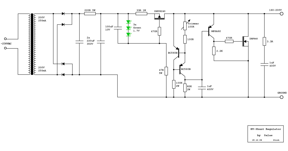

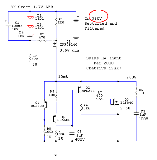

P.S. Is this the preamp you are talking about? If yes, the PSU examples that you see here are overkill for current, dissipation - heat sinking. So, I instruct you a tailor made power scaled schematic if I may. You can see it attached. A 230V 100mA transformer and 4X UF4007 arranged as a bridge rectifier feeding a 220uF/350V capacitor is all you need for Vin. Also 2X rudimentary 3W heat sinks like those they mount LM317T regulators on.

Salas I am confusing myself. When you say I will need a 230V transformer, do you mean with 230V secondaries?
According to the personalised schematic you prepared for me 😀 don't I need a trafo with 320V output ???
Here in the UK we have 230V mains, therefore I will need a trafo with 230V input, 320V output right??
From a quick look in farnell I can't find any suitable trafo. Did you wind your own trafo ?
230V primary and 230V secondary, happens you need 1:1 ratio in this case.

I see.
I was confused because you specified 320V (in red circle) in the schematic attached, so I thought a trafo with 320V out was needed.

320V indeed but rectified DC, not AC. Its a regulator, needs DC. You will get over 300V DC when you rectify your 230V AC secondary.

I can't find BC560B's here in the uk, only BC560A or BC560C
the difference is in the hFE value
A is 110-220, B is 200-450 and C is 420-800
does it make any difference if I go for the BC560C ?
I have one more question, last one hopefully
It will pull a little more current for the C version, will make an even better current source for noise, it may give more V out voltage. Keep in hand 110R and 120R resistors for R5 along with the original 100R, so to practically use the one that will get you nearer to your target voltage. This voltage reference is based on transistors and a resistor and there will be thermal effects in the first 5 minutes until everything warms up and the voltage will stay stable a bit lower than at the power on moment. It's non the less much better than using a Zener. Plus it can be easily trimmed.

I took the freedom to redraw Salas' schematic for better readibility, and he encouraged me to post it here.
This will be for a spud headphone amp (very much like the ones
you have lately seen here on diyaudio 😉 ) the project so far just being on paper of course...
