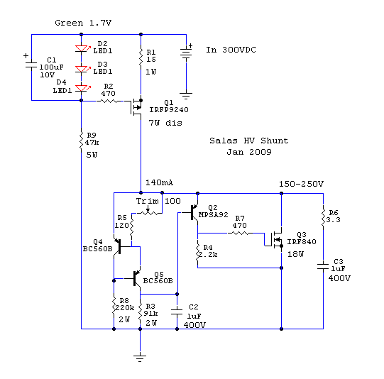

That will be nice. Remember to use a hefty mains transformer, about 200VA(W). 140mA constant current is going to challenge a smaller transformer in practice, it will drop and heat enough. What kind of circuit application are you going to power, that needs 72mA idle current? 2 channels?

Your resistor is going to drop I*R. I=CCS current. That constant current is good to be set at least twice the one you will really use in your audio circuits so to contain dynamic demands. More CCS current is good in general for psu quality and ease, but in a high voltage application as the one we discuss here, it creates significant dissipation and you have to be conservative. In case you consider heroic heat sinking, then the sky is the limit.😎
salas said:What kind of circuit application are you going to power, that needs 72mA idle current? 2 channels?
My application is a version of Dave Davenport's differential preamp using 6h6 set at 18ma per triode.
http://www.raleighaudio.com/figure_18.htm
salas said:Then set the CCS for 140mA. Your sinking needs will be 18W for Q3 using your intended load circuits and 7W for Q1. I would find a nice 30W sink and bolt both on it.

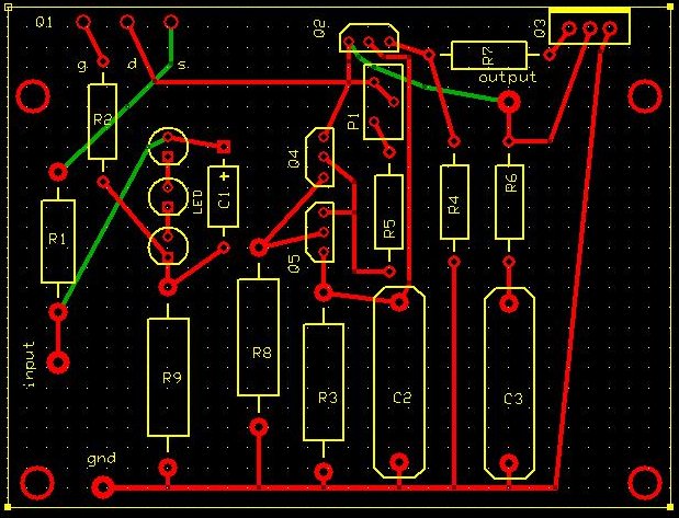

Attached is an updated pcb layout incorporating Salas's suggestions. Being a tubes guy, I do not have much experience with large heat sinks. If I were to use a common 30W sink for both mosfets, do you have any specific component suggestions? Do you see any other layout issues?

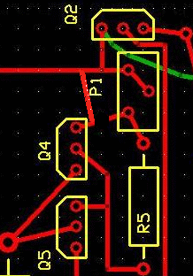

For heat sink, 1C/W will do. Something like this one. Check the orientation of Q4 & Q5, I think they need to be turned around for correct positioning. Also Q1 pads spacing looks wide. Is it really so wide?

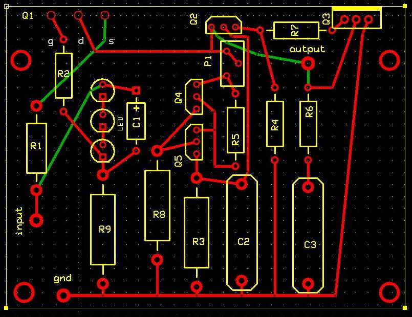

Thanks for the heatsink suggestions and for spotting my errors! I seem to have mis-read the dimensions on the TO-247 datasheet...
Attached is (hopefully) a final version.
Looks good to me, but double check before you etch.
