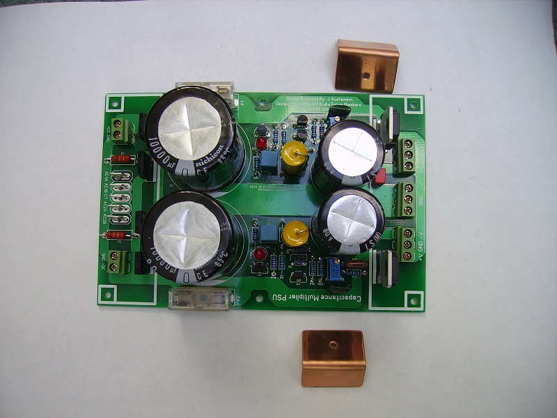

Ok 🙂 Have My PS board.. completed?
(under ordered a few wee caps so had to substitute from on hand, same values tho)

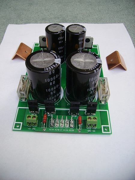

Couple of small questions:
What size Fuses ? (240va 28 v Torroid) ooops just read the above: 6-8 amps then ??
Is there a diagram for connections to the myriad wire attachment points?
Not wiilling to simply guess , hope and risk...at this point 😱

Hi Bare,
The connections should be pretty straightforward. Hardest part will be proper phasing of a dual secondary transformer. As I recall you got an Antek that has dual secondaries and should also have colour coded leads and a connection diagram, so it should be straight forward compared to some.
The end with the pass MOSFETs has three sets of euroblock connectors (spades could be used there if desired). Two sets are labeled as +V GND -V, and are meant to power the amplifiers. The three GND connections in the middle are just for added flexibility in how you return things to the PSU, some have very specific ideas on that.
The input side has two euroblocks (or again spades could be used) labeled +V GND, or -V GND. They can be used to feed DC out to something else that doesn't need to pass through the capacitance multiplier, or alternatively, they can be used to feed the circuit from off-board dual rectifiers. Once again some added flexibility.
The main AC inputs are set-up to accommodate either dual secondaries or a centre-tapped secondary.
For a centre-tapped secondary the connections are AC1A-CT-AC2B.
For dual secondary the connections are AC1A-AC1B and AC2A-AC2B, with the 'phase dots' (same colour leads) located at AC1A and AC2A. The CT connection can be again used as an auxillary ground point.
For your specific transformer brand, if I recall you bought one from Antek:
AC1A - Green lead from either secondary
AC1B - Blue from the same secondary as AC1A
AC2A - Green lead from the other secondary
AC2B - Blue from the same secondary as AC2A

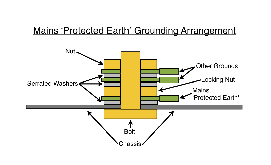

Hi Bare,
Yes the primaries are connected in parallel for our region in the world, ~115VAC mains @ 60Hz. Red to red and black to black.
The purple shield wire should be connected to the main chassis ground, right where you should have a bonded mains ground wire to the chassis. I usually use a longish brass bolt and put the mains ground connection at the bottom with appropriate washers and a nut. Anything else that should go to the 'protected earth' gets connected on top of that. Quick diagram attached.
Is the purple wire the interwinding screen?
The screen's purpose is to conduct interference to "Earth".
This is done by inserting a low impedance connection from the internal screen to the Chassis and then capacitive coupling from the Chassis to "Earth" (that big round ball that we all sit on while listening to out music).
For a low impedance connection, the wire link should be short. If the wire link is long then it will have higher impedance due to inductance of the longer wire.
Take the screen connection direct to Chassis at the point that the screen wire exists the transformer insulation.
If one does not do this, then the HF and VHF and UHF components of the interference will see a high impedance connection to Earth.

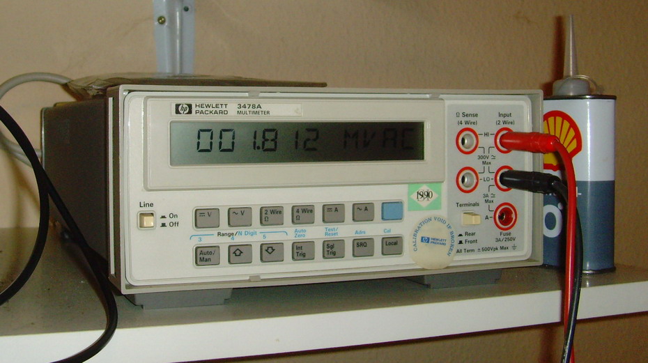

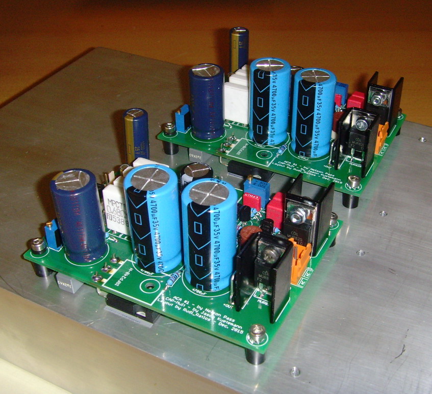

Gentlemen, I have equipped the Nelson Pass ACA#1 - PCBs of my current 4-channel ACA - build, being used for the high- and middle tones of an active speaker-project,
with onboard Jason's CAP-multiplier (image1).
I have adjusted the ACAs (using a 4x20VAC/300VA custom wound torroid - image2)) to an operating voltage of 24.5VDC and an ACA "bias voltage" of 12VDC.
I am measuring an incredibly low ripple of <2mVAC (image 3) on the output voltage.
In my eyes (ears): Jason's CAP-multiplier (which is even adjustable within a small range) is a real gem, and you will get hooked on the ACA's sound.
Why should you ever go for any other PSU, giving you a "small" (about 1.4A) current?

Glad you like it and I appreciate your kind words.
Of course, the design is just my spin on the work of MrEvil. It looks like the concept, as re-worked by Rudi, suits the ACA well.
Congratulations to you Rudi and I hope the others who have benefited from your efforts enjoy it too.

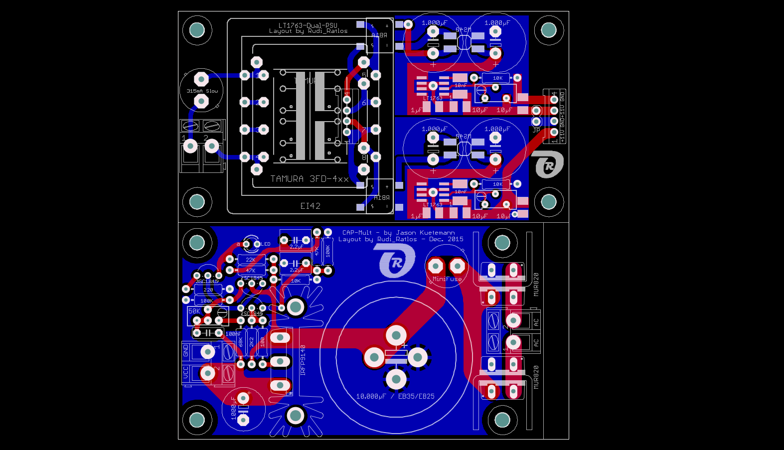

I have done a layout for Jason's PSU and ordered a couple of PCBs (together with a dual LT1763-based PSU on the same PCB - I will cut the PCB).
The PCB's sizes are:85x50mm (Jason's PSU) and 90x50mm (the LT1763 PSU).
The PCBs will arrive in 2-3 weeks.
I can offer you one (more?) of these PCBs.
