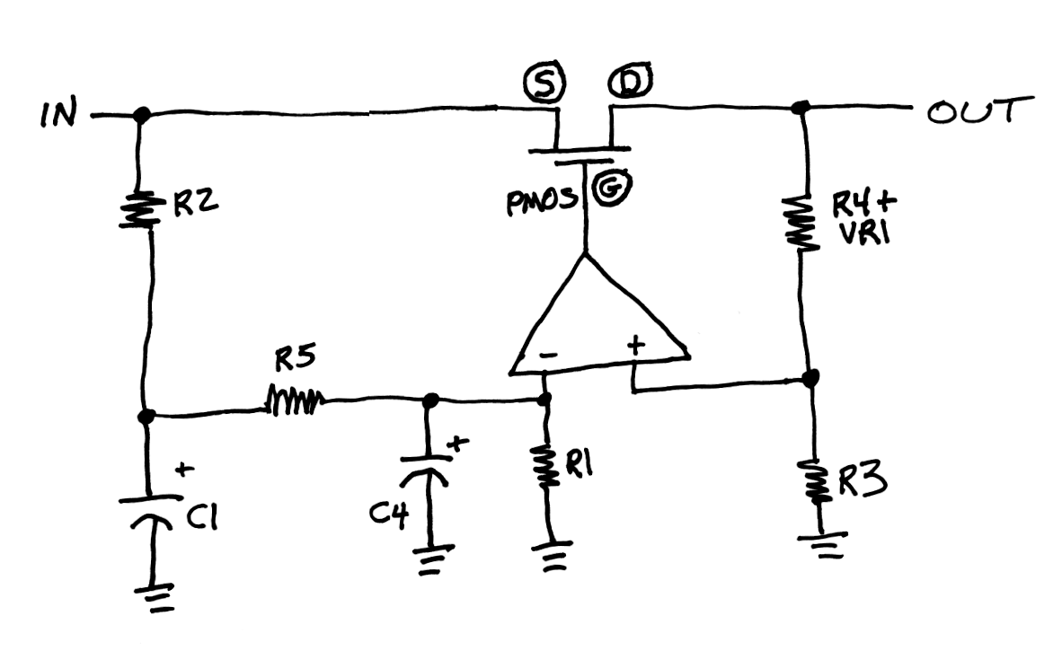

I am using this circuit now and it seems that it takes a 3.7v drop in order to sustain 3.7amp draw with low ripple and I have 22mF bulk capacitance.
The setting was confirmed with oscilloscope - before this I set it at 2.5v drop thinking that was sufficient but about 240mV of sawtooth was leaking through.
The more I look at the schematic, the more it looks like a pass through voltage regulator and not a capacitance multiplier. The usual dropout of a 78xx regulator is about 3.5v if IRC.
Which cap is being “multiplied” here? The 2.2uF C1? Usually the cap being multiplied is circa 220uF.
There doesn't seem to be a reference voltage, just the RC filtered input voltage,
so it isn't a voltage regulator. The R1 would have to be a Zener for the circuit to regulate DC.
The general rule is: Diffamp_IN_+ == Diffamp_IN_-
[R1/(R1+R2+R5)] * Vin
is (by negative feedback) made equal to
[R3/(R3+VR1+R4)] * Vout
Notice that a 10% increase of Vin, produces a 10% increase of Vout.
It's not a "Voltage Regulator" because Vout is not independent of Vin.
Notice that it is a 2 stage amplifier and both stages have considerable amounts of voltage gain, but there is no explicit frequency compensation circuitry to guarantee stability. Minus fifteen points to Slytherin.

I know it doesn’t regulate to an absolute voltage - so maybe a ripple reducer - but I don’t see the cap that is being multiplied unless it is the tiny 2.2uF cap C1.
