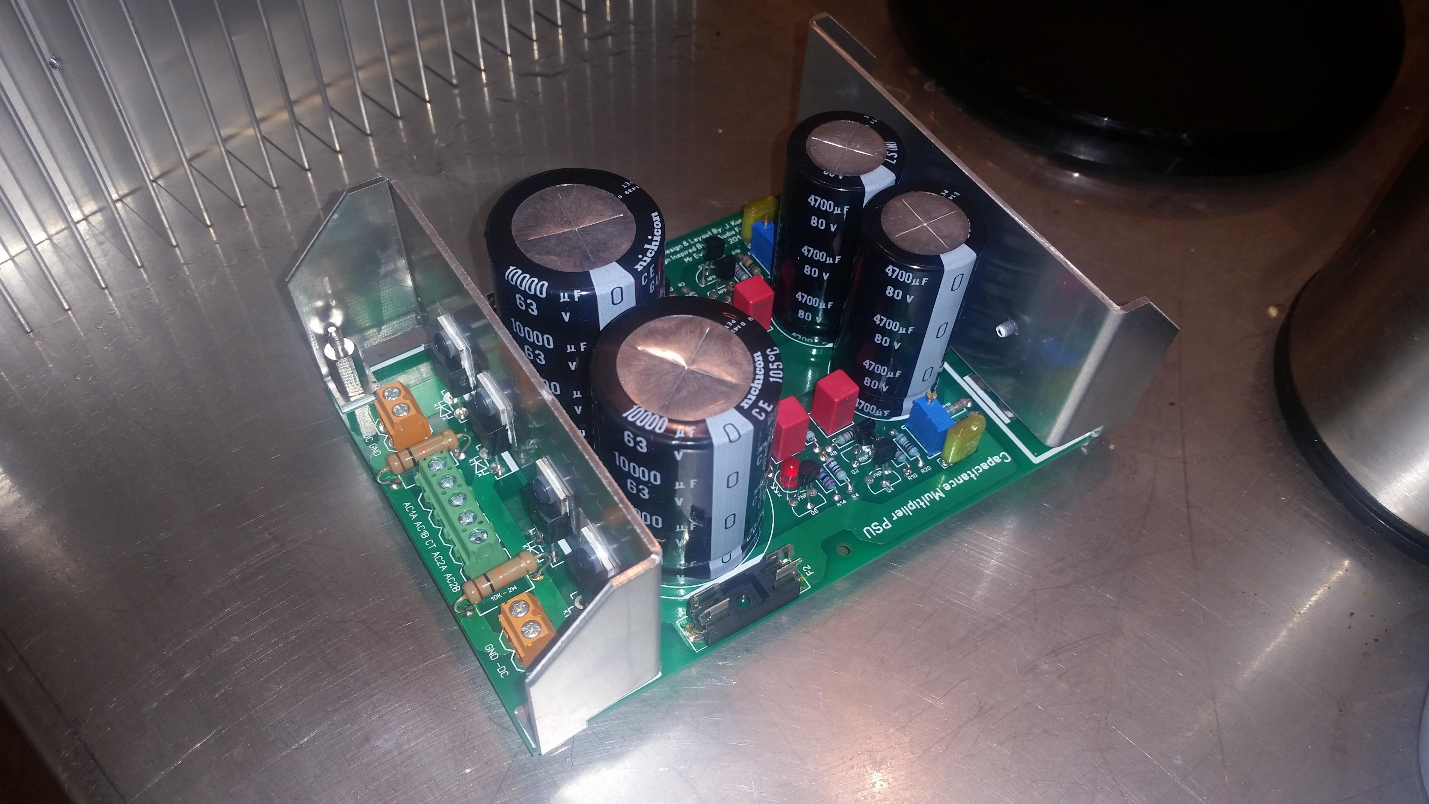

Can I use IRFP 9240/240 for pass mosfets?
Do you know a Mouser part number for a suitable heatsink?

You could, though the IRFP140 / IRFP9140 might be a better choice with similar price and availability. Basically go for the lowest Rds-ON specification you can get that will tolerate you planned voltages. In the case of a VSSA / PeeCeeBee build, that would have you shopping in the >=50V Vds category. It is also rather unimportant that the devices be 'compliments', so you don't have to constrain yourself as much when selecting devices.
Heat sinking requirements are rather light. I'd just cut a piece of aluminum sheet / angle about the width of the board and a little lower in height than the capacitors and mount the MOSFETs to that. The pass devices only drop about 2V or so, which means dissipation is low much of the time. Worst case is full power sine wave testing, where the devices might be asked to dissipate several watts.
The LEDs are best if they have a Vf about 1.6V, so old school GaAsP red LEDs are perfect, though a little higher Vf won't hurt anything. Worst case means selecting a new resistor value for the current sources.

About the aluminium bar - that stuff from AKI (windows aluminium) is OK?
What about this: Aluminium Flat BAR Width From 10mm TO 25mm Choose Size Length | eBay

Many hardware or hobby stores sell aluminum or brass sheets or strips that would be suitable. Linked here is an example of what I have done with another project and envisioned much the same with this board. The metal is fairly thin, it is really surface area that matters most, no so much the thickness or mass.

How did you cut the aluminium in so perfect straight lines? Did you use some kind of naife?
No special tools, just a really old and rather large set of tin-snips. The bends were made against the jaws of a bench vise. Member jwilhelm does much the same , but he has access to a shear and box-pan or break press.

I just ordered from eBay a 0.5mm tick aluminium sheet. Is it too thin? I was going to order 1mm but I tought it was too tick for easy bend. Now I don't know if I made the right choice...😕
That will be just fine. I ran mine at a 2V drop for a few hours with a pair of VSSA on it playing comfortably loud and the MOSFETs were just warm WITHOUT ANY heat sink on them at all.
