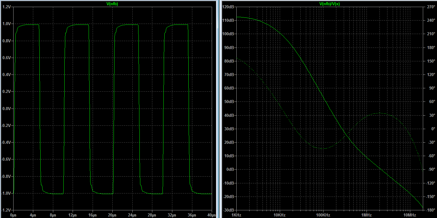

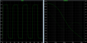

Simplicity and elegance, feedback wanted!
  • Lateralbal.zip
    Lateralbal.zip
amplifier in balanced mode, which really is a requirement for me.

I'm not worried, please allow me to explain.
First of.
Balanced straightly demands for precise balancing all signal path including PCB traces resistance, solder joint resistance, mechanical jacks resistance, wire resistance. Although some of them are out of your control and can't be redesigned in the right way. So the one possible way to workaroud this - is to have fairly high input impedance which in case will minimize all other imperfections.
If you look at the schematic once more it is clear that only the input stage is balanced, the rest of the amplifier is single ended. If I wanted to make the entire amplifier balanced it would be a bridged topology (like the ExtremA) but I don't see the benefits here, partly because of the output power requirement not requiring such a topology and the fact that I want to keep the design simple. Please take note that moving to a bridged topology not only means an additional output stage, but also circuitry to keep the common mode in check.
Second of.
High voltage anyway will provide you with a higher currents, which in case will heat and disturbing resistances. But fairly precise resistances are the cornerstone of the common-mode rejecting. So the one possible way to workaround this - is to put dedicated differential receiver with a dedicated precise resistor network like LT5400.
There's no need, the input LTP is the only thing balanced about this design. If I wanted to improve on the CMR I could use a simple dual opamp at the input configured as a instrumentation amplifier. If I opted for that I would also choose to share the gain (20x) among the opamp and the discrete amplifier to further reduce THD+N.

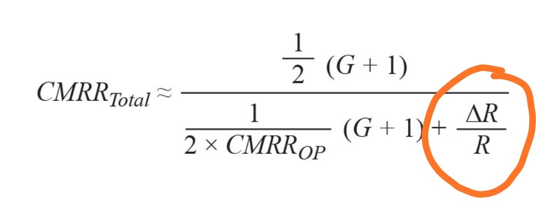

If you look at the amp as an operational differential amp, these things will matter imho. Resistor networks on inv and non-inv inputs should match precisely to yield max CMMRR - which translates to PSRR as well.
Question is, how much CMRR do you really need ?
An amp with an SE input has no CMRR at all, where you should keep in mind that CMRR only counts for a receiver when the source also has a balanced output and yes in that case it's better to have a balanced high input impedance.
Much more important IMO is the feedback resistor R10 because of the high voltages on this resistor where non linearities are taking their part.
The least one should do is to take a 0.5 Watt metal film resistors for R10 & R12 from the same (RN65) series.
You would be surprised how much distortion an improper feedback resistor can produce, IMO a more serious problem as CMRR.
