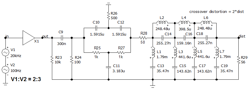

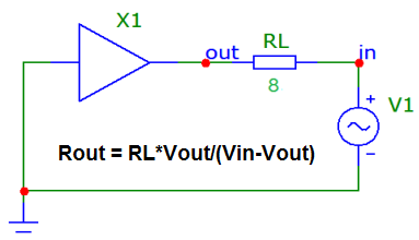

1. Ssassen_Rout graph - filmed by applying a signal to the amplifier output through an 8 ohm resistance. This is the common way to measure the output impedance of an amplifier. Output impedance is calculated using the formula: Rout = RL * Vout / (Vin-Vout)

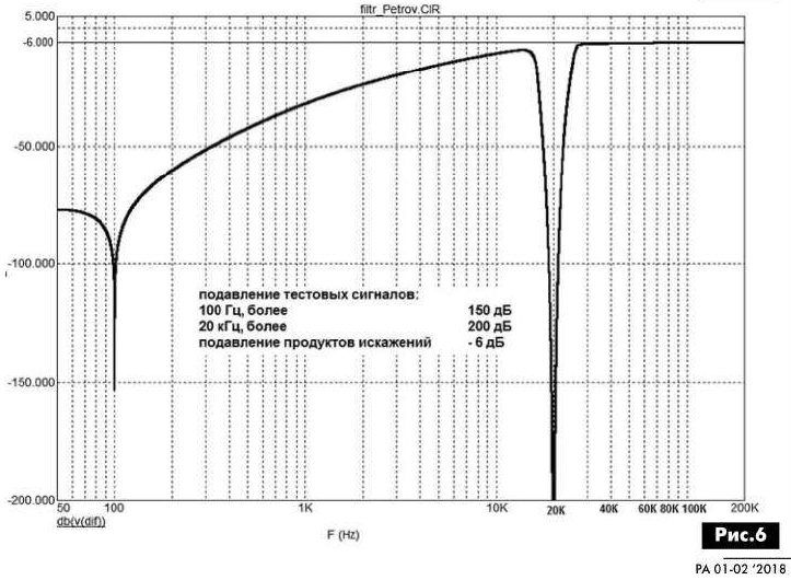

2. 2. Switching distortion is measured using a specially designed filter for this purpose. A complex signal of 100 Hz and 20 kHz is fed to the amplifier input. The filter cuts out these signals and at the output of the 50 Ohm matched filter we get the distortion products as shown in the Ssassen_cross-dist graph.
3. 3. Graph Ssassen_20kHz-spectr - the result of measuring the spectrum in the fourth period.
Alright, but as I have never generated these type of graphs before, what's your verdict? As I'm sure you have compared a wide variety of amplifier topologies judging from the other topic?

The formula: Rout=RL*Vout/(Vin-Vout) is certainly not incorrect per se, but I would make two remarks: Rout can be useful, but for general information Zout has more value.
In the case of an amplifier, the numerical values of Rout and |Zout| can be quite different for a number of reasons. For a SS amplifier for example, the NFB often results in a mostly inductive Zout.
The output impedance can be derived more easily with: Zout=Vout/I(RL), and if needed Rout can be extracted by looking at the real part of Zout
Or since you are looking for the small signal Zout, short the amp input to ground, use an 1A current source to inject in the output node (this is also the phase reference), do a AC sweep, V(out) is exactly Zout. Plot Re{Zout} and Im{Zout}, done, aren't simulators convenient. This is a direct result of the superposition theorem, no other assumptions.
