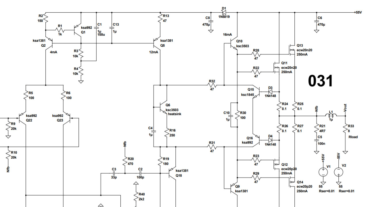

In some cases the use of TMC produces a sharp increase in loop gain in the middle of the audio band. This peak can be eliminated by the inclusion of a 10n cap in series with R20.
Gotcha, thanks! but to my understanding that peaking midband is a problem with TPC, TMC doesn't have that problem.
Thanks BesPav, that's very elegant indeed, thanks for the suggestion. See attached updated schematic.

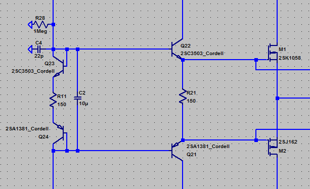

I'ld take your OPS and put it somewhere here:
Opamp + Common base
This will add something like 40-50 dB feedback depth at 20kHz with conservative unity gain freq in range of ones of MHz or even more if you allow your amp to be High-frequency transmitter in the range of tens of MHz.
Also i'ld try famous AD844 as inout stage and pick it's output signal from their supply pins. Again, up to 50-60 dB feedback depth at 20 kHz.
Am i need to draw?

How do you control output offset without using a dc blocking cap in the NFB circuit ?
R7+R8 will be a trimpot, so I can set offset after the amplifier has warmed up, I'm seeing uVs in the simulator, if that turns out to be too optimistic and I see large (10s of mV) in practice I might opt for a DC servo.

Please see attached, is this what you meant with connecting Q6 as a diode?
Draw faster than write, so i've attached.
Ah yes, of course, thanks!

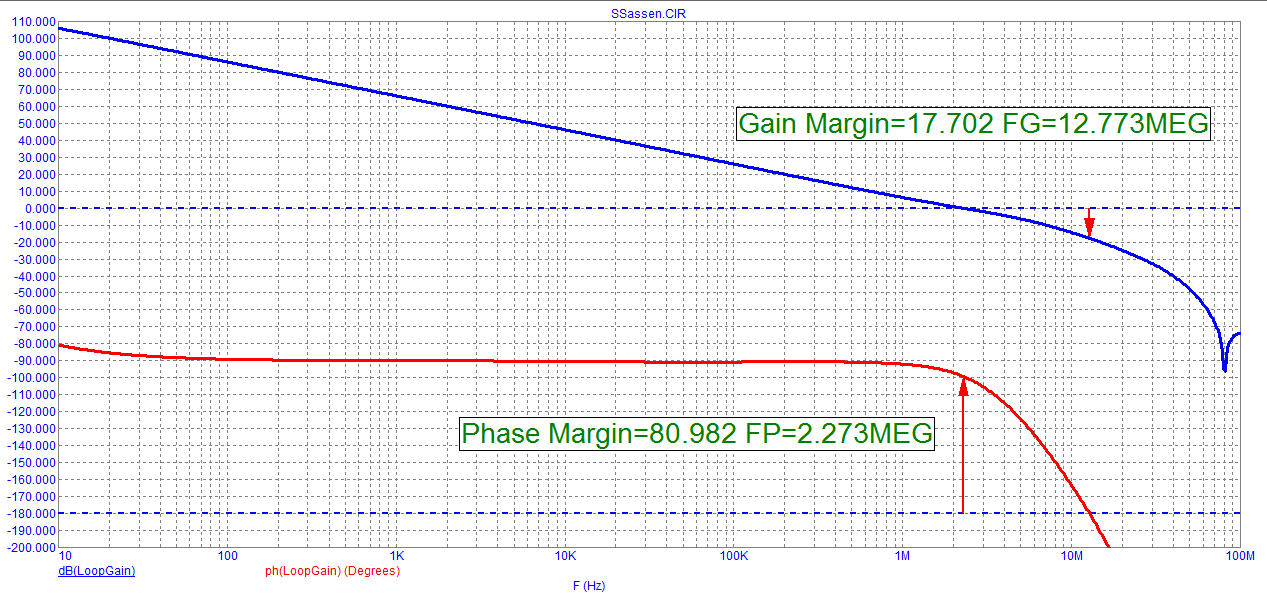

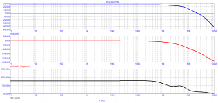

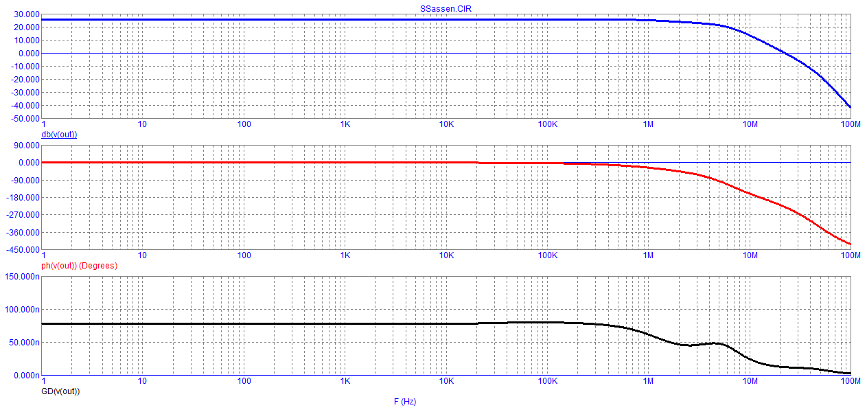

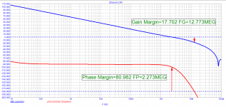

just check the Bode diagram and look at the Group Delay to say that the parameters of this amplifier will be at their best
Thanks petr_2009 for taking the effort to simulate the design, much appreciated! Could you perhaps illustrate what these graphs mean? The loop gain/phase and margin plots are self explanatory, but the others have me scratching my head a little, what am I looking for in those?
strange parameter
These are models from the Fairchild website, as I’m using exactly these transistors. Not sure what that parameter means exactly.
I agree. I found the charts confusing. It's not clear to me what they represent.
collector current at which the base current transfer ratio begins to decline (high-current roll-off corner)These are models from the Fairchild website, as I’m using exactly these transistors. Not sure what that parameter means exactly.

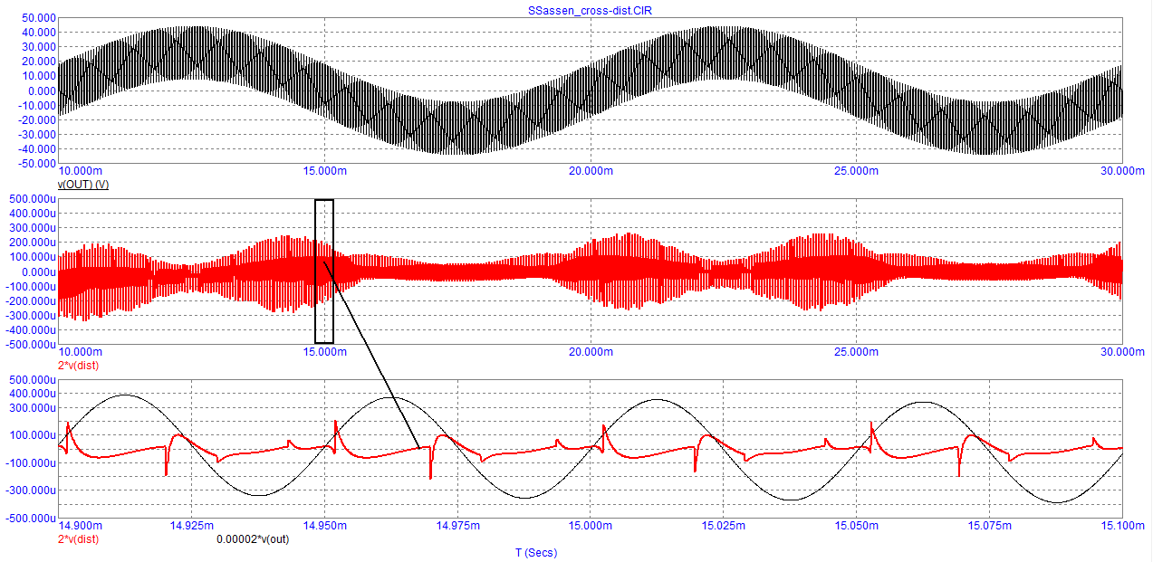

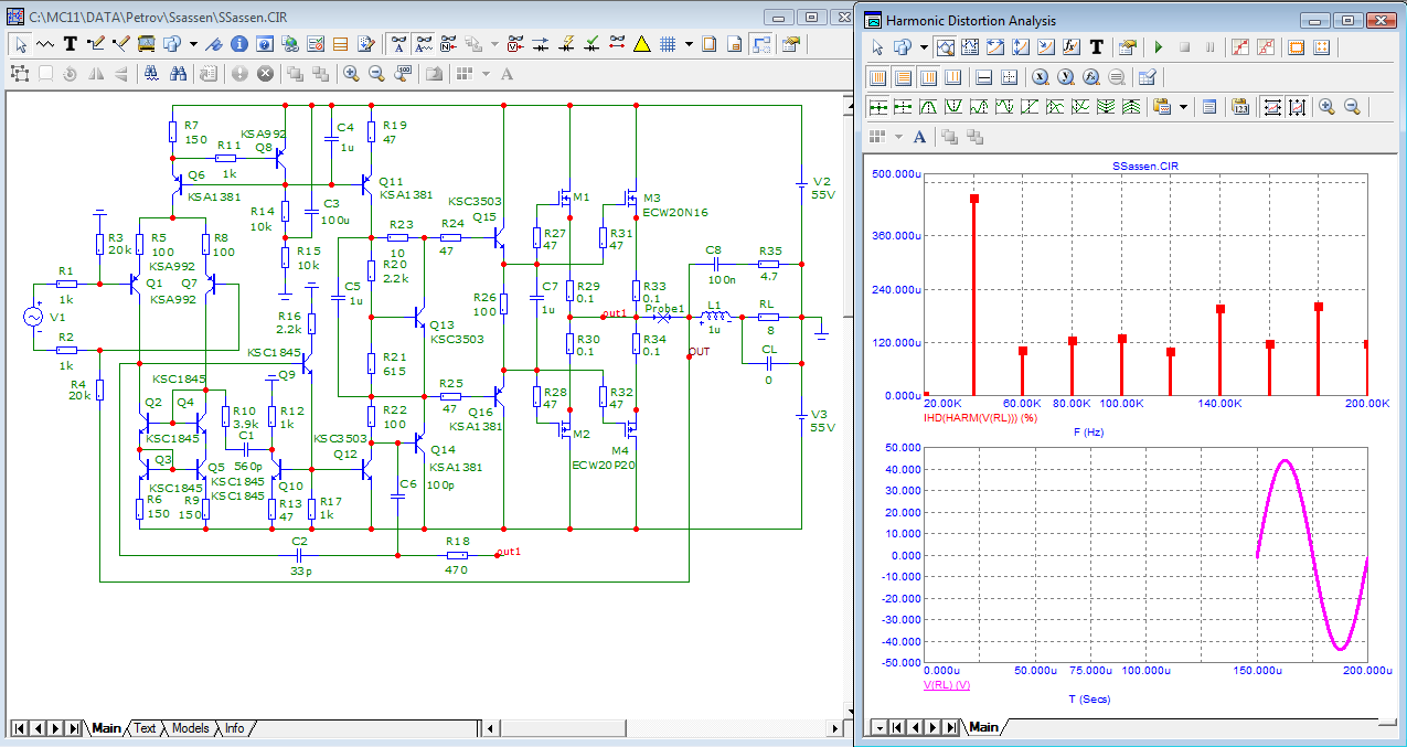

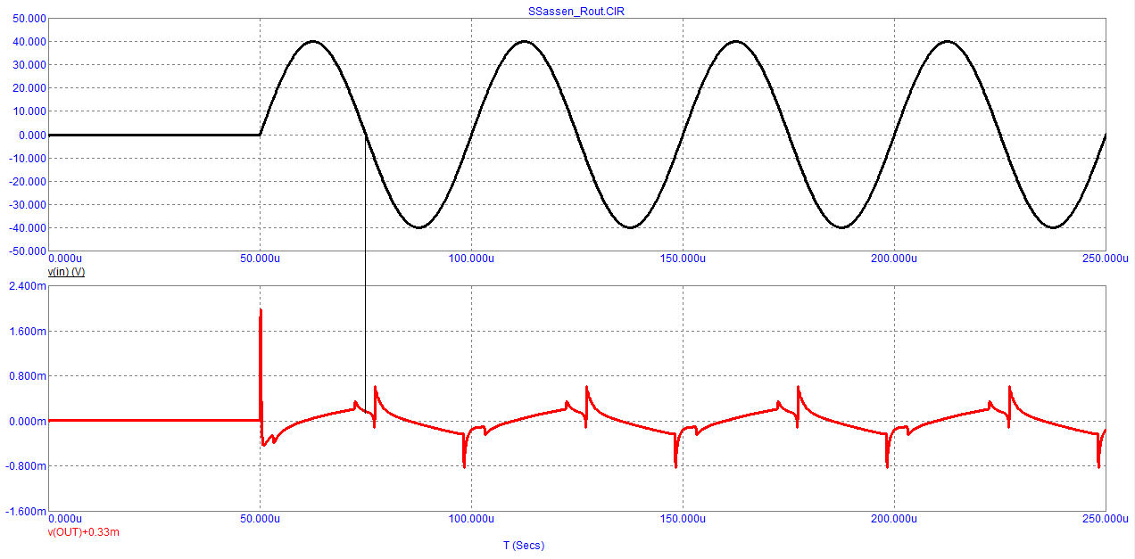

1. Ssassen_Rout graph - filmed by applying a signal to the amplifier output through an 8 ohm resistance. This is the common way to measure the output impedance of an amplifier. Output impedance is calculated using the formula: Rout = RL * Vout / (Vin-Vout)

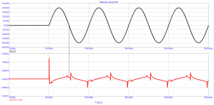

2. 2. Switching distortion is measured using a specially designed filter for this purpose. A complex signal of 100 Hz and 20 kHz is fed to the amplifier input. The filter cuts out these signals and at the output of the 50 Ohm matched filter we get the distortion products as shown in the Ssassen_cross-dist graph.
3. 3. Graph Ssassen_20kHz-spectr - the result of measuring the spectrum in the fourth period.

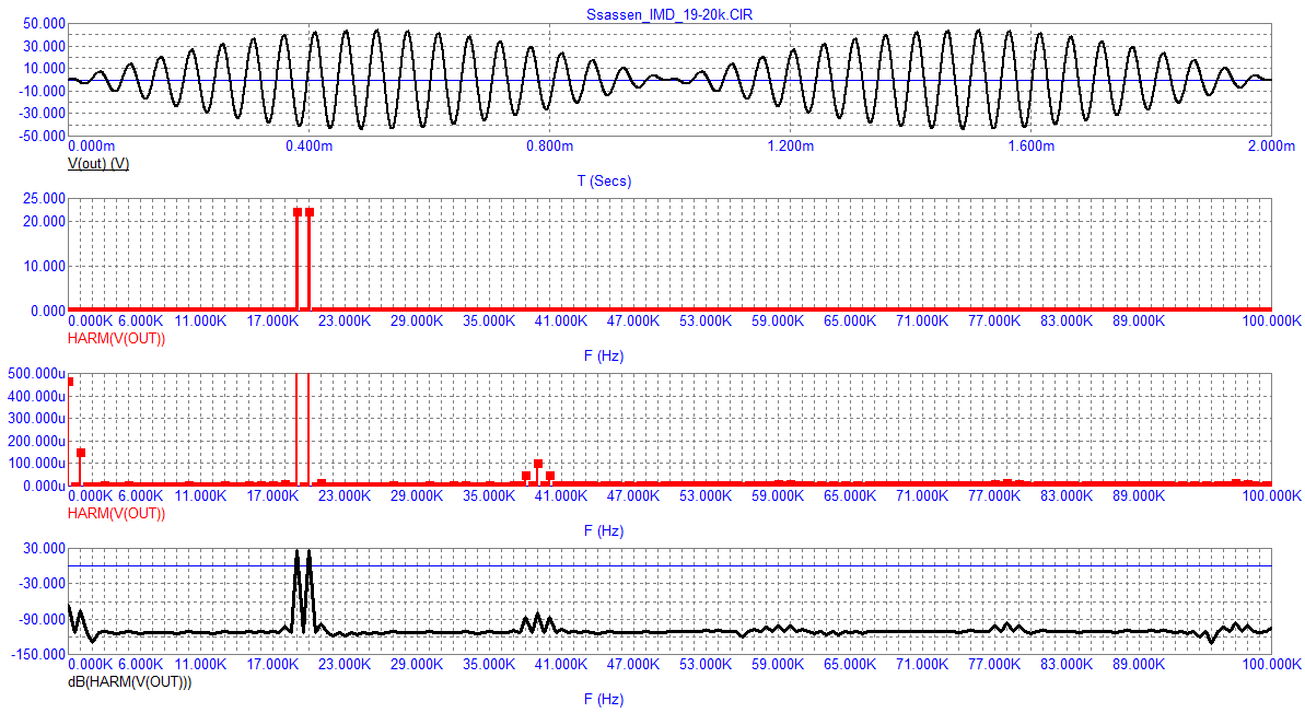

I hope that the IMD measurement graph does not need comments
