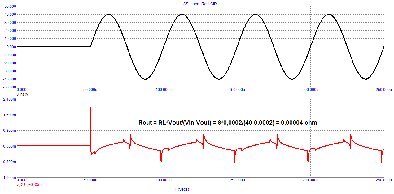

The formula: Rout=RL*Vout/(Vin-Vout) is certainly not incorrect per se, but I would make two remarks: Rout can be useful, but for general information Zout has more value.
In the case of an amplifier, the numerical values of Rout and |Zout| can be quite different for a number of reasons. For a SS amplifier for example, the NFB often results in a mostly inductive Zout.

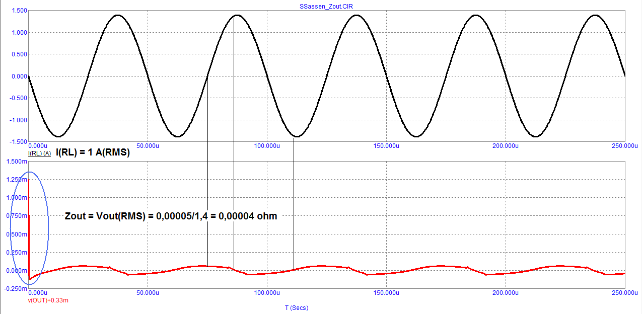

The output impedance can be derived more easily with: Zout=Vout/I(RL), and if needed Rout can be extracted by looking at the real part of Zout
Here is the result of measuring the output impedance using current.
What new information did you get from this test?
The output impedance is measured to calculate the damping factor There are several ways to measure the output impedance (impedance) of an amplifier.
bucks bunny:
“With a stereo amp just drive one channel that feeds the output of the other channel through a low inductive dummy resistor. No need for a specific current source. “
You're right!
This method is suitable for measurements both virtually and in hardware.

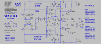

This method can be very useful while designing inherently stable output EF-triple.
Just remove all unnecessary in this case feedback loops, create needed bias with working DC point and add realistic inductances of pins and traces.
I do not have any problems with 2SC1845E_kq/2SA992F_kq models in this amp. The simulated THD is identical to yours, 0.0003% 20k/100W/8R. It's equipped with vertical mosfets (much cheaper than laterals) and TMIC compensation. Powerful, fast and simple.
