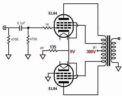

There's so much offtopic here.
So anyone built this minimalistic creation?
I'm looking to build at first a guitar amp and would definitely want to try what a guitar sounds like through such minimalism, that's why saturation wouldn't matter to me. The simpler it is, the better, I'd just like to try push pull and make it amplify sound.
As I can see, yes the preamp is missing. Would it be okay to take any guitar preamp and connect it to that power section as is?

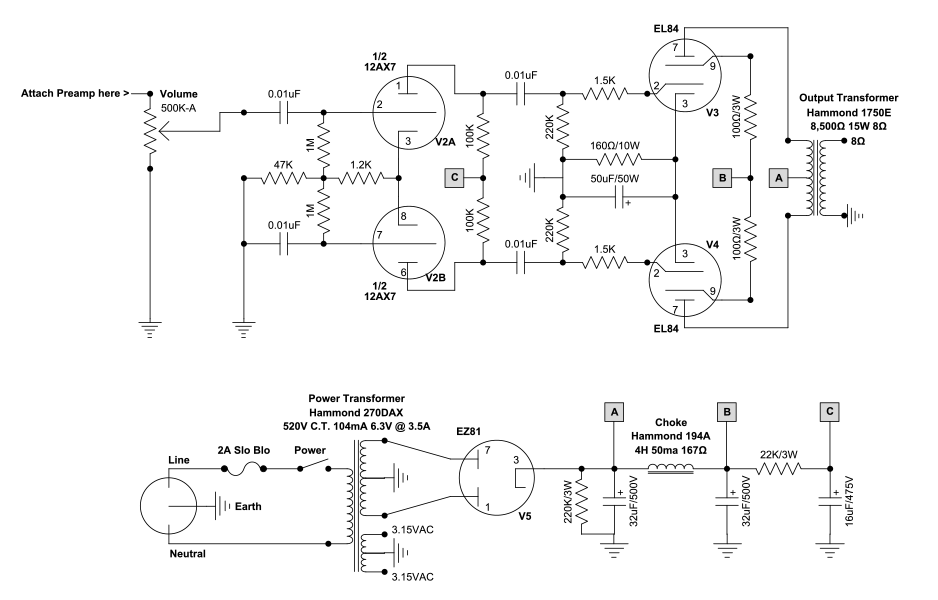

I believe there are a number of persons that have built the amplifier you presented in Post #1.
Of course, it has to be built with the input stage that others mentioned, like in Post # 2.
300V B+ should work well.
Depending on the output of your electric guitar, you might find that the input stage does not have enough gain, so you might need one more stage of amplification ahead of that amplifier's input stage to get reasonable volume, otherwise it would be a nighttime practice amp.
And, depending on the efficiency of your speaker, you might not have enough power to be able to play as loudly as you would like, but at more moderate sound levels should work very well.
I wish I had the parts and the time, I would build that amplifier just as in the complete schematic that includes a current sink of the two output stage cathodes, instead of the resistor.
I would probably use a choke as both the current sink and self bias for the EL84 tubes.
Depending on the B+, and the choke DCR, It might need a series resistor between the choke and the cathodes to get the proper bias voltage and cathode current.
Use a resistor first to get the proper bias voltage and cathode current. Then replace that with a choke, and a series resistor so that the choke DCR and series resistor are equal to the resistor value you used that gave the proper bias V and cathode current.
I liked the choke current sinks the best on the self inverting amplifiers I built. Simple and effective.
Be Sure to use very well matched EL84 tubes (Eurotubes.com extensively re-tests all the JJ tubes that they get from JJ in Slovakia; and the matched tubes are Very well matched). Eurotubes does ship to many countries outside the US.
JJ makes the ECC99, it is a dual triode, so if you need more gain, you already will have the triode for an input stage.

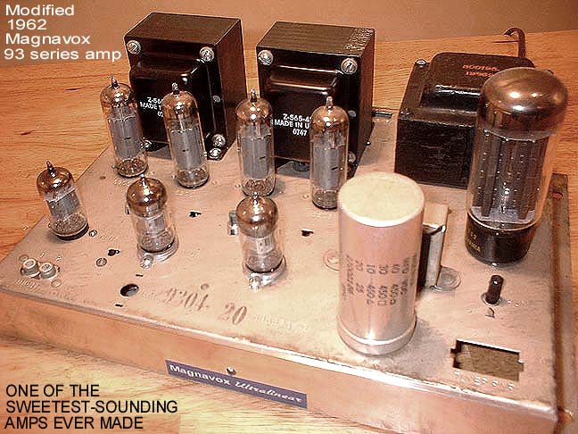

I see nothing bad using a steel chassis.
My re-designed Magnavox 9304 amp chassis (schematic above) is on it's original 8x12x1.5" steel chassis.
And for decades amps and tuners were on steel, even high-end models.
My amp has absolutely no issues, dead quiet ear-to-the-speaker.

Yes, this is just about the simplest push-pull circuit you can build. Yes you can take any preamp you like, and hook it up to the power section.

Simple is good, I've preached that many times.
However, that circuit, having an ultralinear tap in use with a grounded grid design, goes against traditional designs.
It's like putting cheap tires on an expensive automobile.

What I see is the topmost EL84 cathode pulling the bottom of the primary up, and the bottommost EL84 plate pulling the primary down (through a 135 Ohm resistor).
I do not believe that I understand that topology very well.
It does a push and a pull, but perhaps from different impedances.
Since there is very little DC through the primary, perhaps it can be a push pull transformer, or a special transformer. (those two types of transformers do not have air gaps; instead interleave the E's and the I's; in order to get the most inductance given the number of turns and the size of the laminations.
The only DC current through the primary is the topmost EL84 screen. If the transformer will not saturate with the amount of screen current, then the laminations do not have to be air gapped.

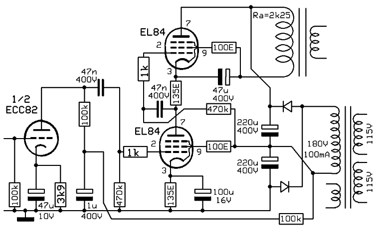

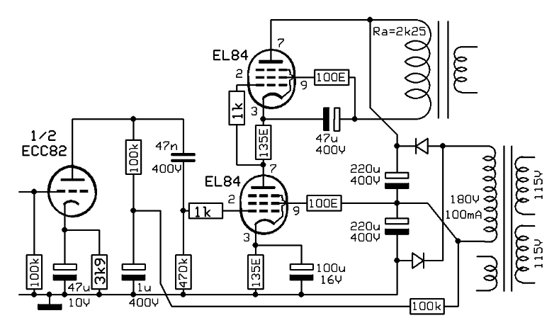

Well, it's an SRPP but with pentodes.
The result is that the cathode current of the top tube is less then the bottom one, the screen current of the bottom tube is missing. So, perhaps the cathode resistor of the top one should be a little bigger (150Ω ?).
Or making the AC and DC conditions of the top tube independent, like this.
