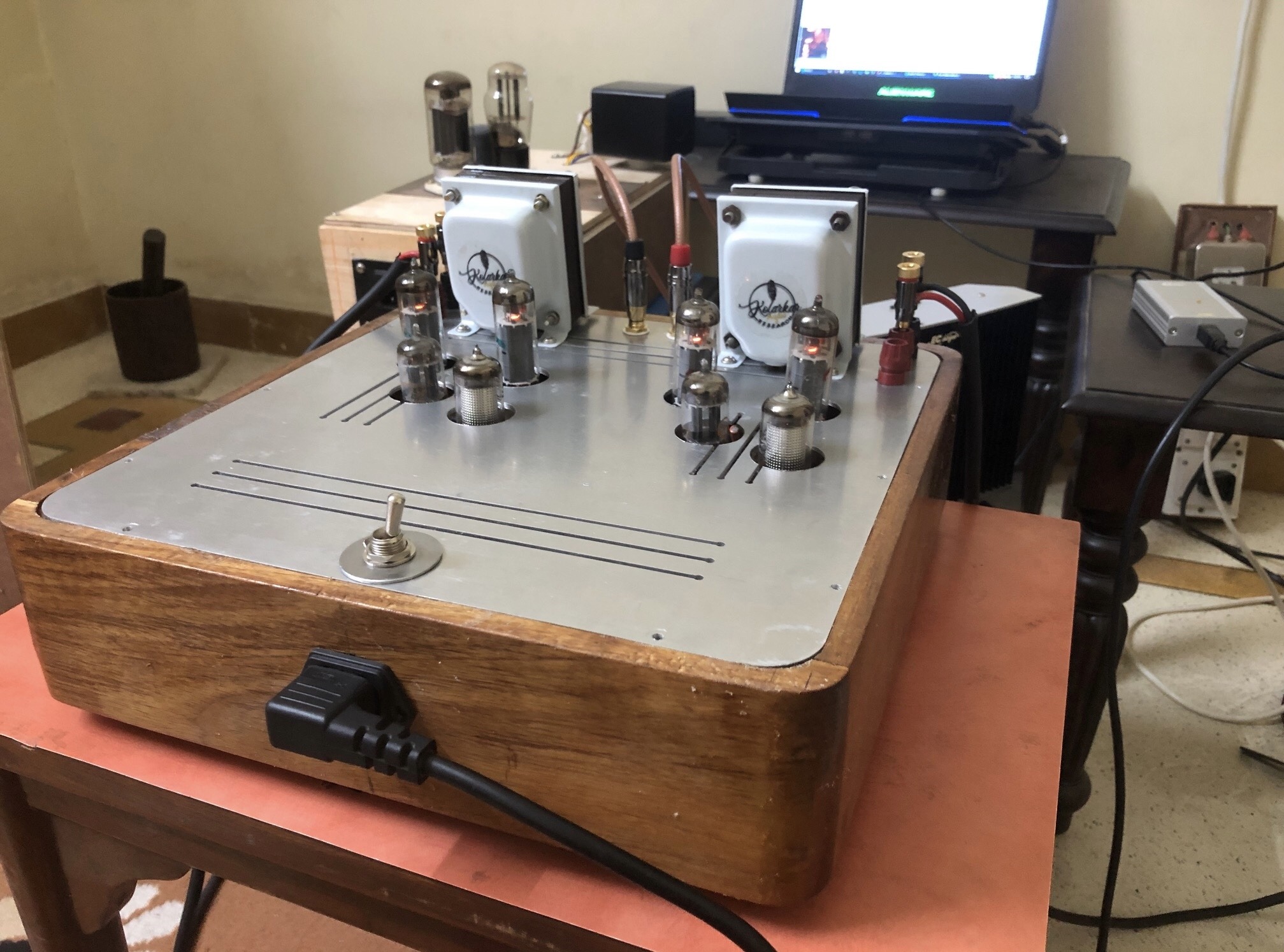

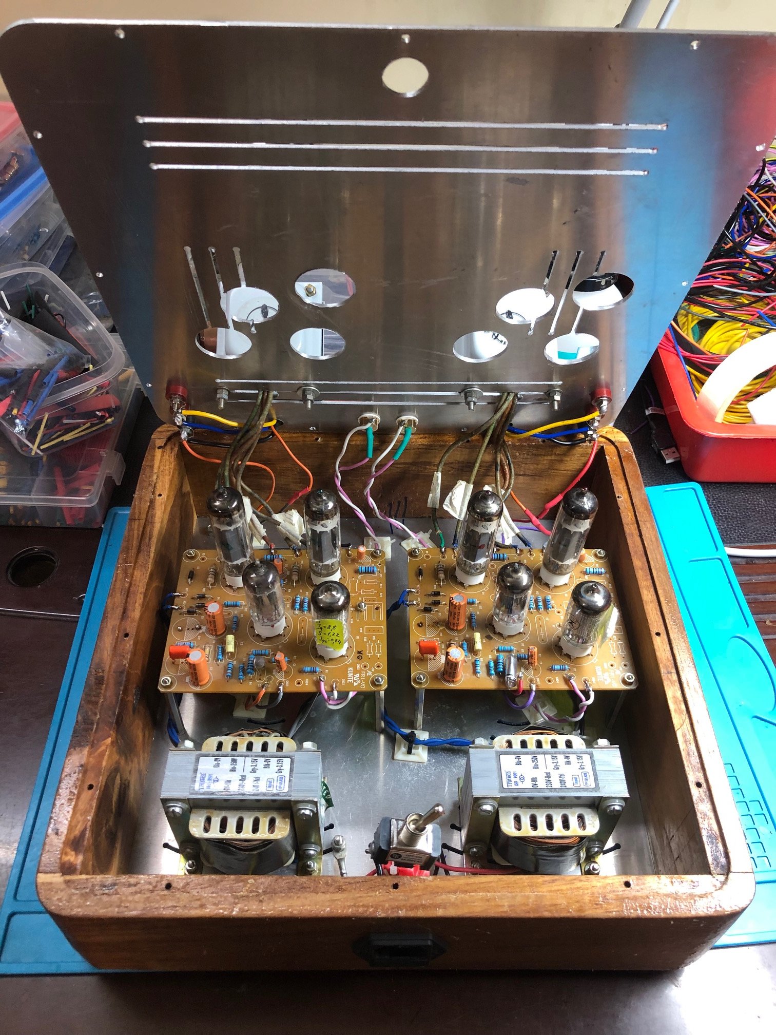

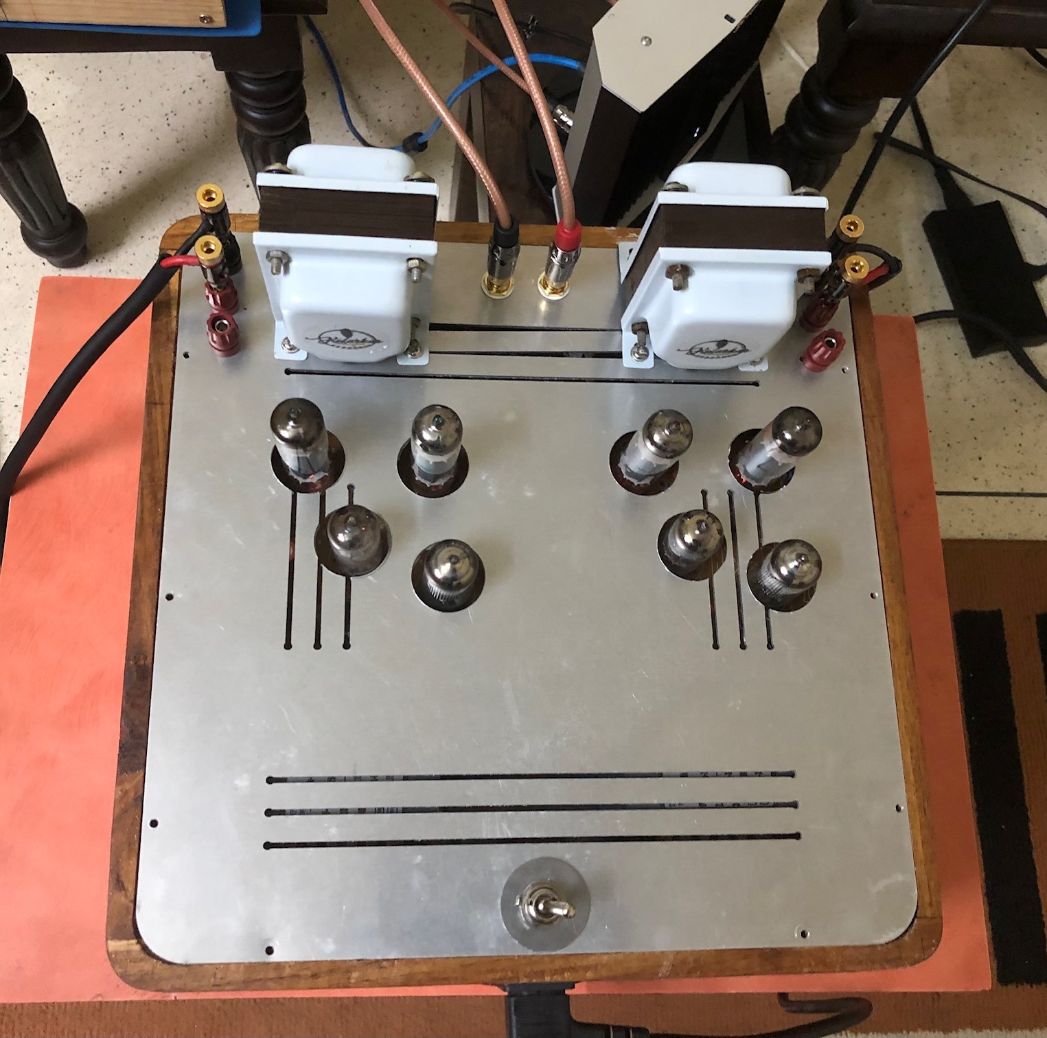

Based on Mullards 5-10 with handwound 0-4-8-16 ohms tap OPT, fully dual monoblock design, just completed. Runs dead silent on 105dB speakers:
(Sorry, not so great looking, it’s my first attempt at DIY chassis using only the Bosch hand drill. Have built many tube amps but all bare bones and this is the first fully dressed up)
Will be adding the 16 ohm terminal soon.
With no other tool than a handrill not easy to accomplish what you did, congrats, nice work Yogi!
Pete
Pete

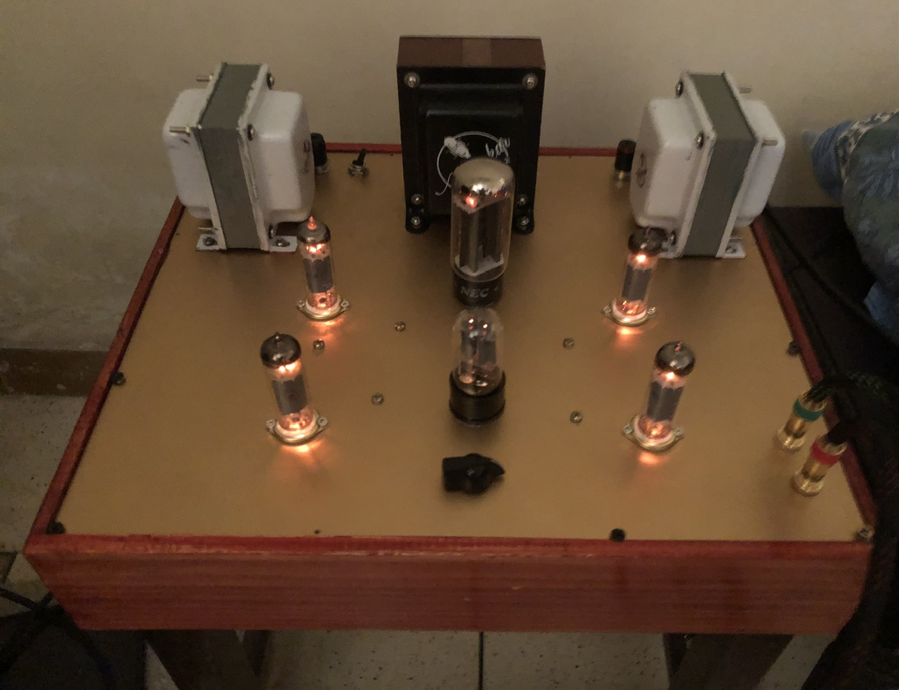

Thanks Pete. Building another. A single ended Pure Class A, super triode tube rectified 6BM8. Will share pictures soon.
Again, just the Bosch hand drill and jigsaw.
You’re able to get those parallel slots that straight with a jig saw?? And not scrape the surface to death?
N
Those slots were already there on the top plate. It was intended to house a DAC but I decided to try it as the EL84 amp top plate.
But this would be changed too, to accommodate larger and better OPTs coming in soon. Better low end at higher wattage.
Oh no. Jigsaw is used on current 6BM8 build.You’re able to get those parallel slots that straight with a jig saw?? And not scrape the surface to death?

Latest build. (31st in last 3-1/2 years)
EL84 PP, tube rectified, 6SN7 at driver, no feedback. Interstage. Total 8 number of iron, 5 under the chassis. 9 watts per channel. 4, 8, 16 ohms. Dead silent. PSA-2N Electra Print Audio design. All iron handwound by Kolarkar Audio. Awesome tonality and details.
