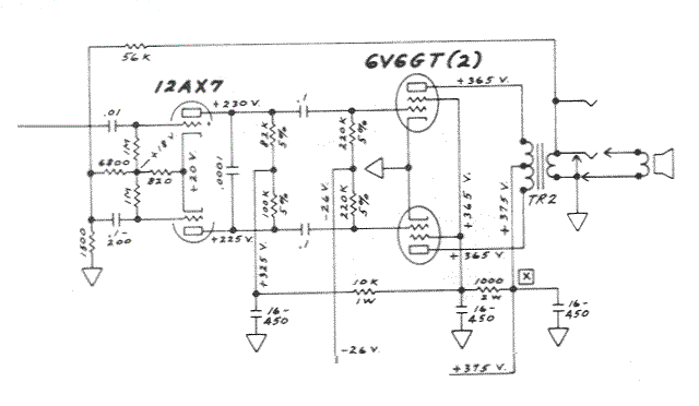

I don't think there's anything simpler than following the good old Fender Deluxe Reverb output stage (12AT7 LTP, 6V6 pentode outputs) which could easily be adapted to 12AT7 and EL84, or even 12AX7 and EL84.
Indicentally, that Fender Deluxe output stage is really close to the Vox AC15 output stage. So if you like the AC15, I say that's a good way to go too.
As I can see, yes the preamp is missing. Would it be okay to take any guitar preamp and connect it to that power section as is?
Within reason, yes, any guitar preamp should be able to drive such an output stage. The LTP will have high input impedance. You may have a problem with too much gain (depending on your guitar tone tastes) but that can be dealt with by applying a bit of NFB around the output stage, Fender Deluxe-style.

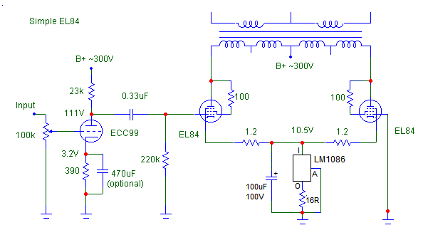

Well, in an effort to be helpful and to conform to your opinion on the matter, I'd say that the originally posted schematic is about as simple as it can get, and it will work with a minimum of tweaking.
I'd also say that triode-wiring the EL84s will be more likely to result in success than UL operation, as it will not absolutely need negative feedback to sound pleasant. In my experience, running a UL stage with no global NFB results in a kind of raw-edged sound (in my opinion).
Here's something that I think is as simple as can be done, and should be easy to get working well. Power supply not shown, which will be important too.
OP is building a guitar amp. Triode operation and CCS tail are not ideal for guitar.

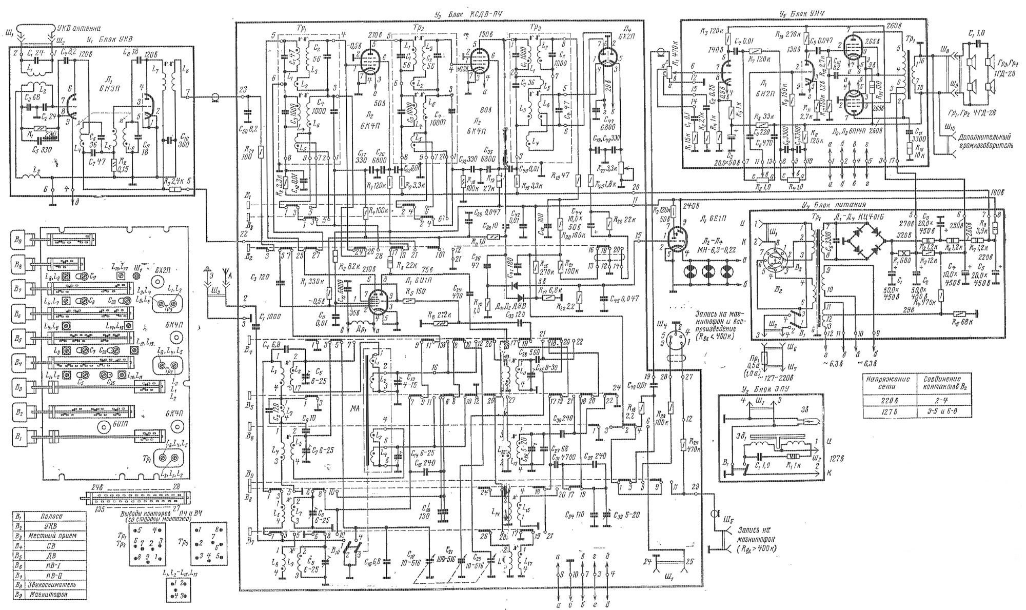

What I have at hand for donor is this:
Reactions: jcalvarez
It may look asymmetric, but that’s probably just because of where the taps were on the schematic symbol. Looks like bog standard ultralinear to me based on how it’s connected. I’ll be the taps on the trafo are really just at 40% on either side of CT.
As far as the simplest possible solution go back to post #5. Triode stage-concertina-EL84 pair. Doesn’t get much simpler or foolproof than that. Use the UL or not - user’s choice.
Is not bog-standard output stage. Л3 g1 is grounded, they may have been playing with the output transformer.
It will be interesting to measure it.
