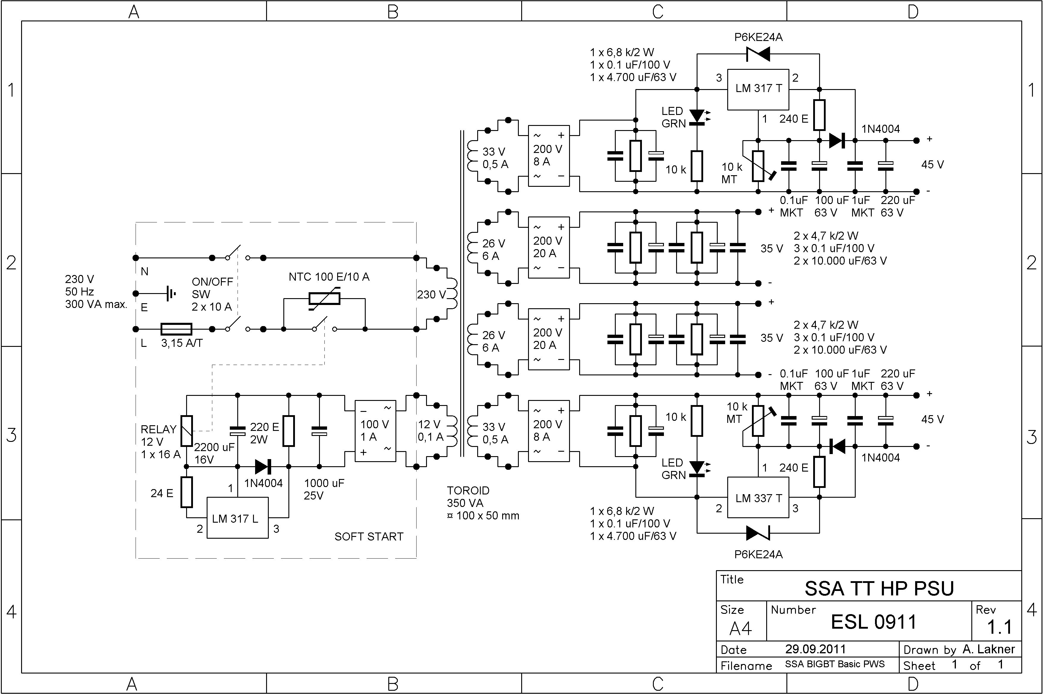

Hello Lazy cat ,
Could you please verify if this schematic posted here in post 347 is valid
SSA Thermal Track High Performance + Power Supply Unit
A little more complex but surely very realistic version for you.

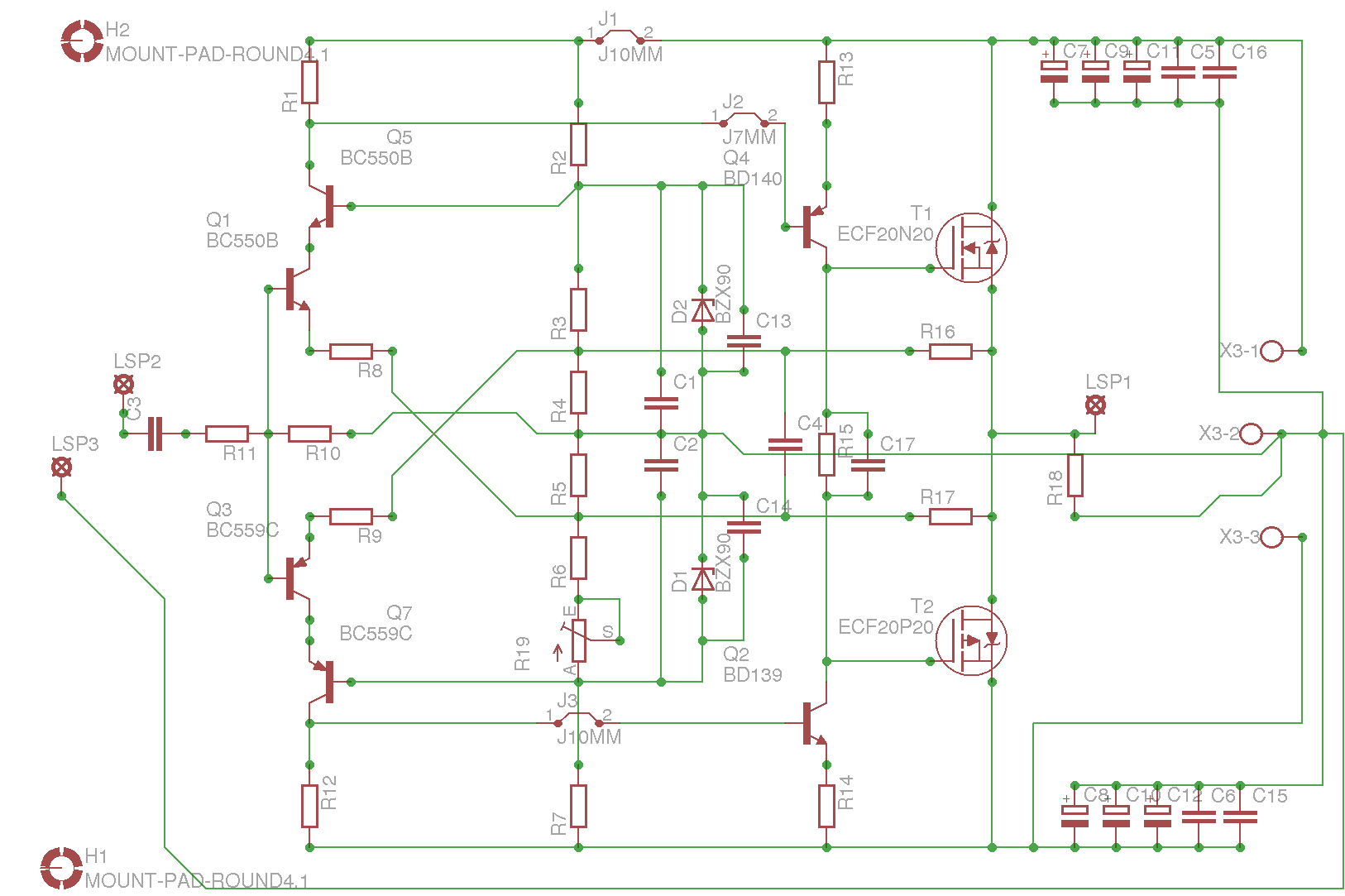

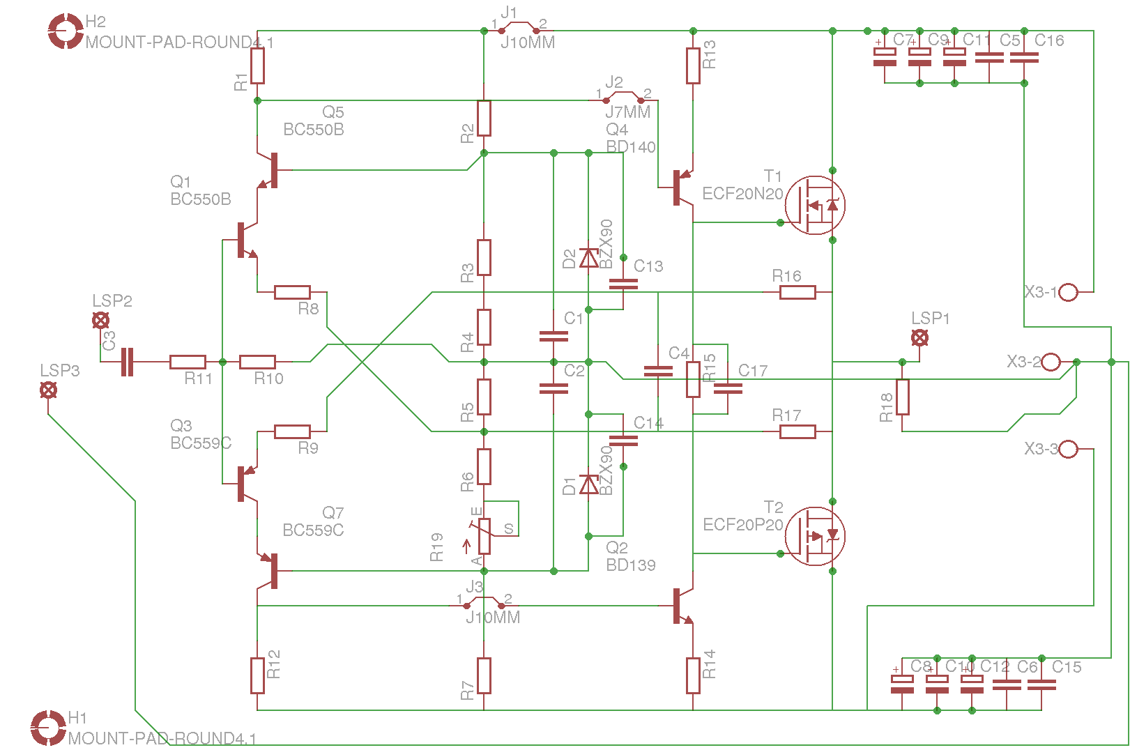

just wanted someone to check through my work and to share it with you all.
i know there are no values on the res and caps but i can play with that later as ill take them from the many posts and play with the averages.
thanks for looking, any comments thanks in advance, steve.

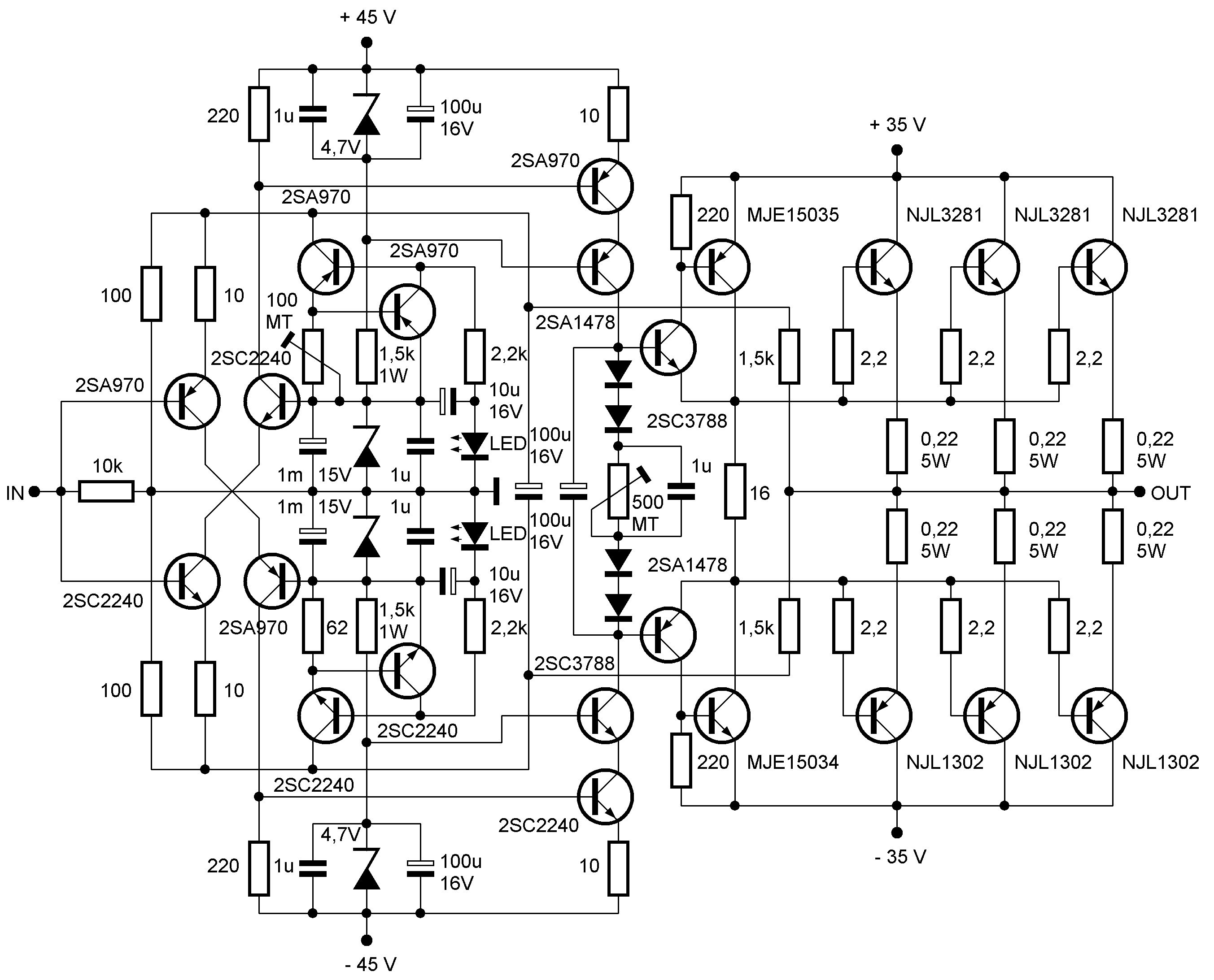

Hi a.wayne
SSA schematic is different, as some compensating caps were added.
You need 1000W on which impedance? In accordance to current level and SOA, the number of output BJTs and supply voltage can be calculated. Output stage current gain is enormous so there should be no problem driving it with proposed front-end.

Hello LC... goal is 600-800 watts/ch into 1 ohm or 20 amps capability per channel.can i substitute the NJL outputs for MJL , is there a difference ...?
Hi psychosteve72
Please make some little corrections to your sch - some junctions are missing. Recheck the sch and than we can say things related to PCB.
Otherwise nice work, TO3-s looks great on PCB, congratullations.
a.wayne no problem
For the power 800Wrms/1ohm, peak output voltage will be 40Vp, and peak output current 40Ap. Output transistors behave normally up to Ic=6-7Ap so you would need six pairs of the outputs, +/-50V supply voltage for the output stage and +/-60V for the SSA front-end. Some components values have to be recalculated and I can prepare this especially for your specific case till tomorrow.
