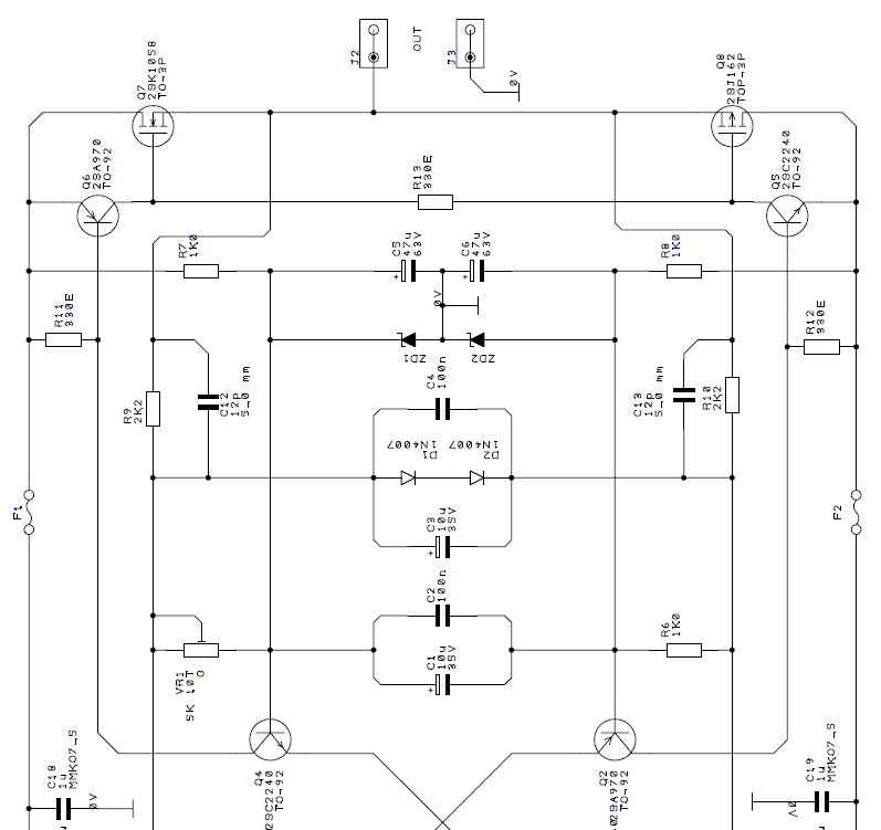

Basic test result: Iq is very stable. No overheating anywhere. VAS bjts are equally warm.
Offset is NOT. Dancing like balle dancers... seems to have a mind of its own... sometimes +10mV, the next moment -80mV, then -2mV! I can increase the offset from 5mV to say 150mV just by breathing over the input BJTs. I guess the mains AC variations is the main culprit here, as I had the hFE of each input BJT matched before construction. Also I curse the single-turn pot; life is hell with it sitting there. I don't want to use a regulated supply with SSA, so, maybe I'll use my trustful servo with it. We'll see later.

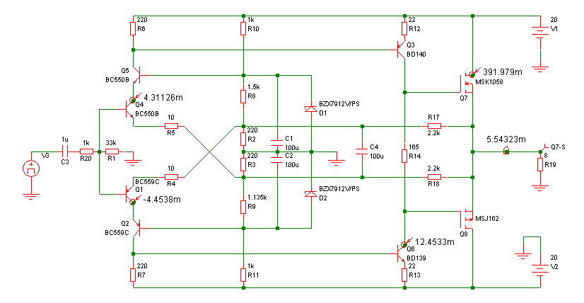

If this is your sch than:
- R1 should be 10 kohm
- R2, R3 should be 100 ohm
- R9 should be multiturn trimer (one fixed value resistor + multiturn trimmer)
- R10, R11 zener supply resistors must have current set to 15-20mA so the zener potential is fixed
- R14 should be coupled with 100 uF
- C1, C2 should be 1000 uF
- D1, D2 also coupled with 0,1 uF
- Q1, Q4 thermally coupled
And your offset will be normal. ;)

Update: Offset variation is a little better with Iq of 300mA; at the time of last post it was about 170mA. But now I have a little humming in the speaker. Ground loop may be, I'll check.
Shaan, the little humming on the speakers are probably due to the power supply now rippling a little. I had that problem but decoupled the front end with diodes in the power supply, this removed the hum significantly it is barely audible on headphones. My bias is pretty stable after about 10 minutes, but I run the amp in "near class A" at just under an amp.

Offset is NOT. Dancing like balle dancers... seems to have a mind of its own... sometimes +10mV, the next moment -80mV, then -2mVI don't want to use a regulated supply with SSA, so, maybe I'll use my trustful servo with it.
It is absolutely normal with an amp flat from DC with no servo. And will have no consequences, as Nico says, as long it is in the 150mv scale, OMHO.
I highly recommend you use a dynamically filtered power supply (Simple emitter follower, like the one i had suggested in this thread), It improve the sound on transients and noise of all amps as much than the amp itself. Cost a power trans or two and a zener by power line. + additional electrolytic capacitors where huge is never enough ;-)

Shaan, that verobuild is pure art, underside especially. :up:
Nico, what is the Iq in the output lateral Mosfets, and is it stable enough, if I will follow your schema with 2SC2240/2SA970 compound driver and 330R R13? Also when you say decoupled the front end with diodes, just those, or an extra cap to ground on the node also? I was thinking of simple capacitance multipliers there even, since the cascode is certainly exposed to ripple.
Hi Salas, a Capacitive multiplier would do the job even better than my diodes but my PCBs was made a few weeks ago and I opted for the minimum modifications I can get away with. My Iq is about 800mA, yes I run them hot but I find hot is good for two reasons 1) temperature is more stable and 2)harmonic distribution is a nice roll off starting with H2.

It is absolutely normal with an amp flat from DC with no servo. And will have no consequences, as Nico says, as long it is in the 150mv scale, OMHO. I highly recommend you use a dynamically filtered power supply (Simple emitter follower, like the one i had suggested in this thread), It improve the sound on transients and noise of all amps as much than the amp itself. Cost a power trans or two and a zener by power line. + additional electrolytic capacitors where huge is never enough ;-)
http://www.diyaudio.com/forums/atta...16209035-simple-symetrical-amplifier-alim.pdf
Replace zener with Tl 431 or so... Are-you sure there is no very HF oscillation too, hum can be often the sign of it ?
Yes I know that this much of offset variation is nothing. But I have read through the thread... the best results has less than +-10mV. I want to achieve that. Maybe I will use the cap-multiplier, but first I have to modify the main circuit a bit, as LC suggests in his last post. There is no VHF oscillation(my radio receivers are alive :) and both supply drawing equal current.)

Nico, you may take a look at the opamp type SSA I posted on page 78. I built it, in its imperfected state. It sounded FAR from cynical and not transparent, and it is still playing. It has symmetrical mirrors and is running at less than 10mA bias in the output FETs. :rolleyes:
Shaan a ground loop sounds like 100Hz half wave rectified, power supply ripple is a sawtooth in appearance and sounds quite different, it has a sharp tone added in.
In my case the hum has audible buzz. It is definitely PS ripple. :(

Here is what I did:
R1 is 12 Kohm(Don't have 10Kohm in stock)
R2, R3 is still 220ohm. I don't want higher gain and replacing the 2K2 feedback resistors seems to make too much mess, but IF necessary I'll do it later.
No multiturn trimmer available. I use a single turn 2K2ohm trimmer.
Zener supply resistors reduced to 440ohm.
R14 is now with 100uF.
C1, C2 is 1000uF.
Diodes are still alone.
Q1, Q4 eternally kissing each other since the beginning of time.
Offset is totally stable at +-5mV!!!!! Thanks.
BUT
Now I have a LOUDER hum+buzz from the speaker. As if I am using 10uF caps in supply filtering.
Although music is still playing. :( :wchair:

OK nice. Well offset by this amp is auto-cancelled out because of symmetrical design from the input and its DC referenced to the GND only, so normally if everything is done properly there will be only few mV around GND potential.
DC servo is not needed by this design.
Shaan regarding 100Hz hum:
- check the rails ripple filtration, try dual-mono supply arrangement
- rearrange GND connections, you have GND currents interference
- if possible start with only one channel (other off) to cancel hum, than both
I'm sure you will find the way to get rid of hum because at my SSA BIGBT there is only silence at speaker output. :cool:
I am from the beginning testing only the right channel.
Ripple filtration is Ok for a class-AB amp. I have used my conventional LTP based class-AB amp with the same supply and same output FETs, it's dead silent with the 15000uF caps.
I'll now isolate the feedback ground from the diode/caps ground. Hope this shows some light. :eek:

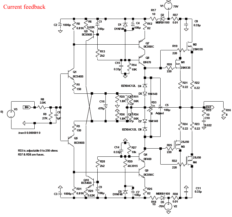

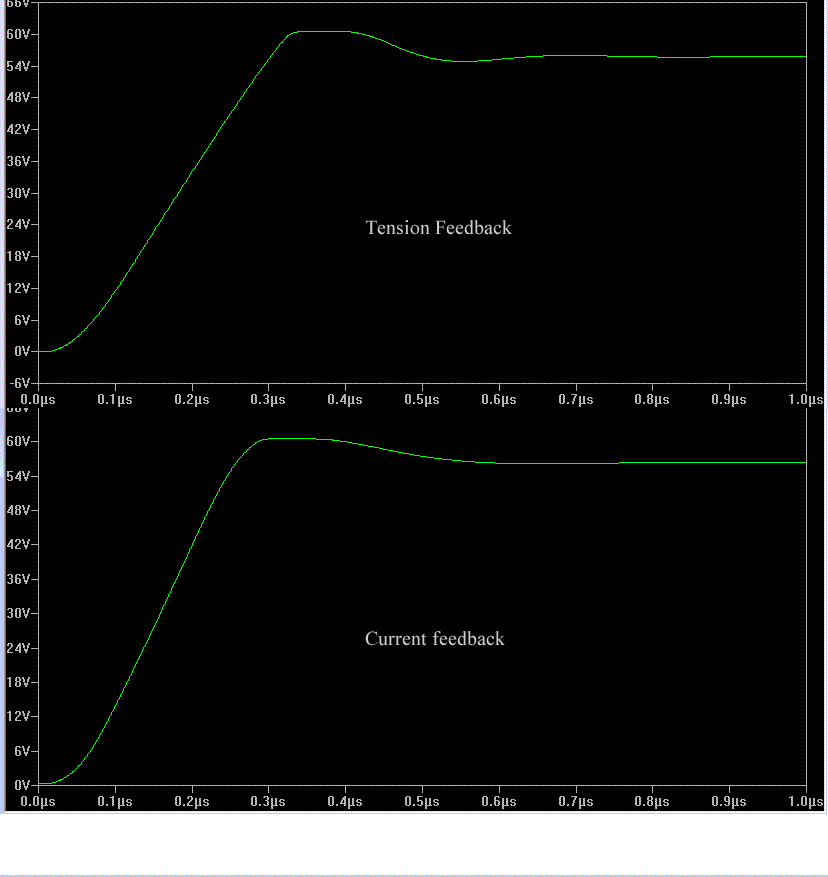

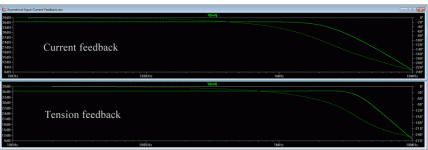

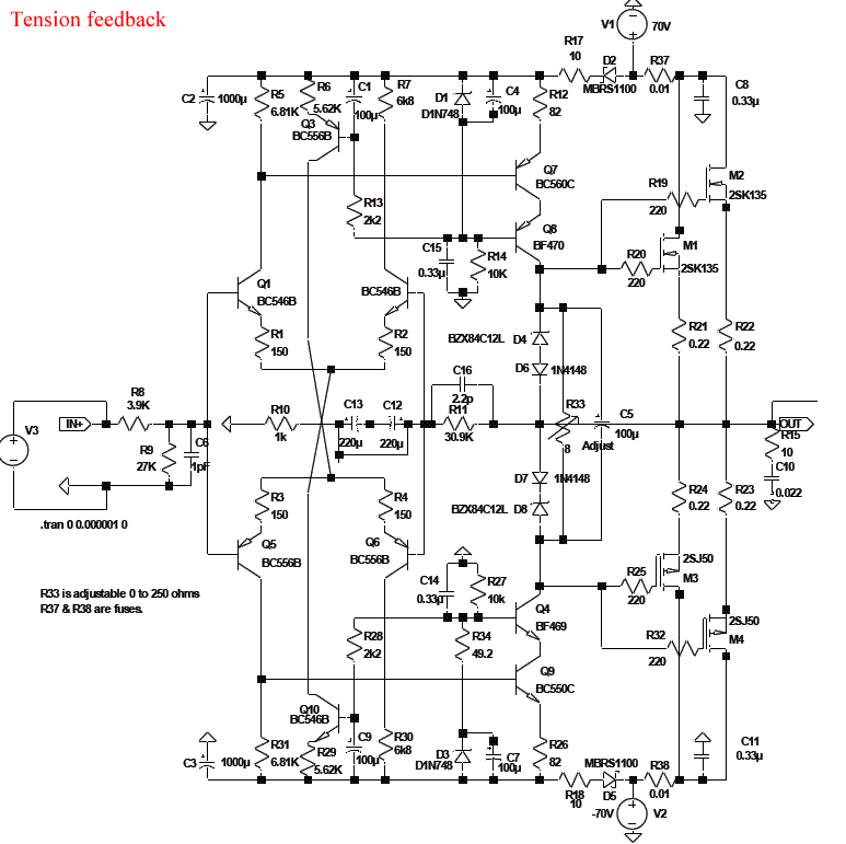

Comparing tension feedback to SSA curent feedback
Simulating one of my (pretty good) amplifier with a modification according to SSA schematic gives interesting results.
The bandwitch is higher on my tension feedback amp (4Mhz @ -3db) but with a less linear and more rapid slope. 12db/oct for SSA, 18db/oct for Tension feedback. The SSA goes 2MHz @ -3db, and both are the same level @ 10Mhz.
SSA increase the speed from 225V/µs to 250V/µs.
The winner is... SSA !
Attached the two Lt files with models, comparison response curves from 10KHz to 10MHz, and comparison of transients.
Lazy Cat, the values of feedback are far from those indicated by you for my schematic, as the bandwidth, with your low values are something like 1KHz !!!! I had optimized them as you will see on the LTspice files you can play with.
http://www.esperado.fr/SSA/Asymetrical-Input-tension-Feedback1.asc
http://www.esperado.fr/SSA/Asymetrical-Input-Current-Feedback1.asc

Nah... SSA is playing music so well that I am having the 'cant-stop-listening-to-prototype-amp' syndrome like Nico.
But, the hum is still there. I think I have some notoriously faulty parts... Or maybe leaky capacitors. I'll do a complete replace of the parts later and update the status! :(
ps. LC, I have decreased the value of the zener feed resistors in my old opamp-type SSA too. It stabilized the offset variation in that amp too. Thanks again for that tip.
