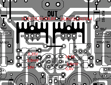

Still, the bias could not be set (in the simulator), and after changing these resistors it could. For as far as I can see, these resistors are parallel to the bias regulator, if the voltage does not rise to the required level (over the bias regulator) I figured that raising the value of these resistors might help (and it did, in the simulator). Probably due to the 10ohm emitter resistors? If I am wrong then please explain why, so I can understand your design better.
Frans.
Here is the voltages on the input transistors, but I am no shure are they in written order
It is not 15V rather measured 14,7V?
Look Josip, zener diode is not a voltage reference, its voltage potential is also zener current/production dependent, so across zener diode you should measure something from 14,5V to 15,5V (15V+/-0,5V). 😉
But until you won't have both zener diode potentials correct, it is no use to measure other points potentials as well. 🙄
P.S. This is completely basic electronic knowledge, so I am afraid that you will have to look to some books or wikipedia too. 😉
