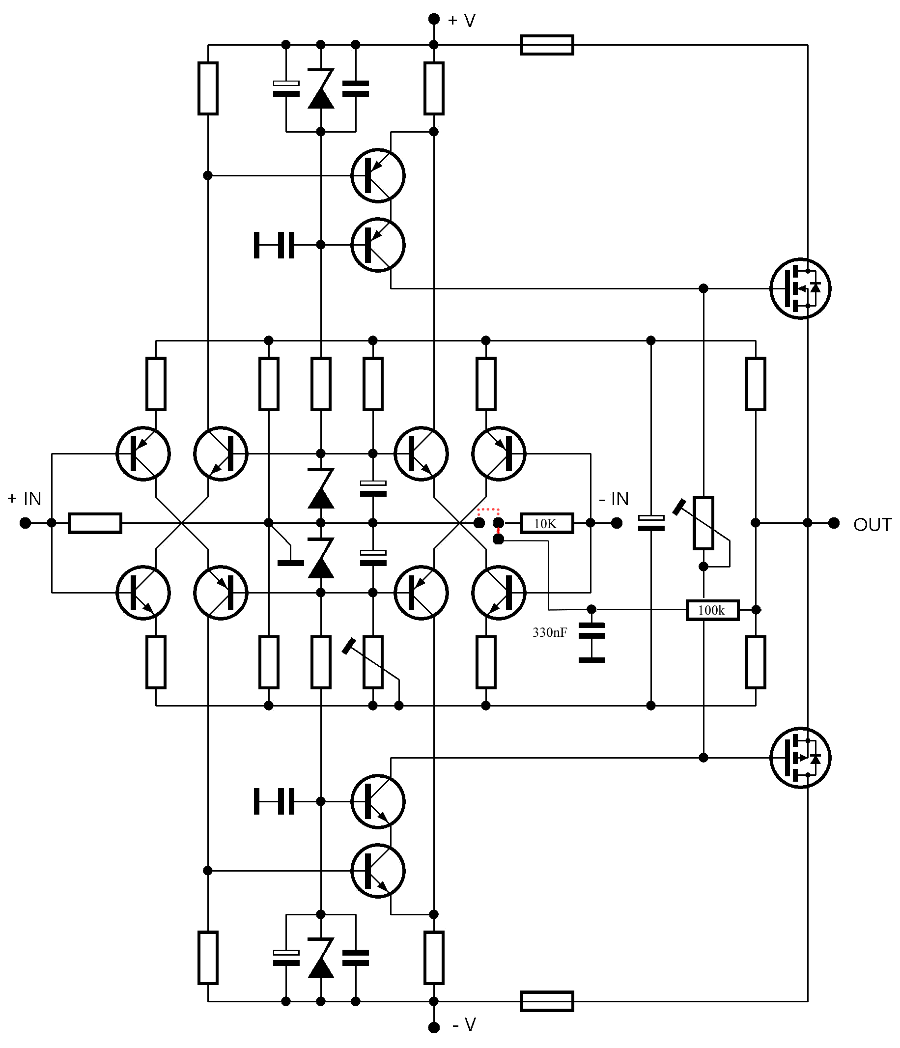

DC servo is realy not needed here at SSA. If you make all the steps correctly: hFE match, input BJT thermall joint and proper connections according to schematic, than you will get +/-10mV max offset variations below 1Hz, which is negligible. 😉

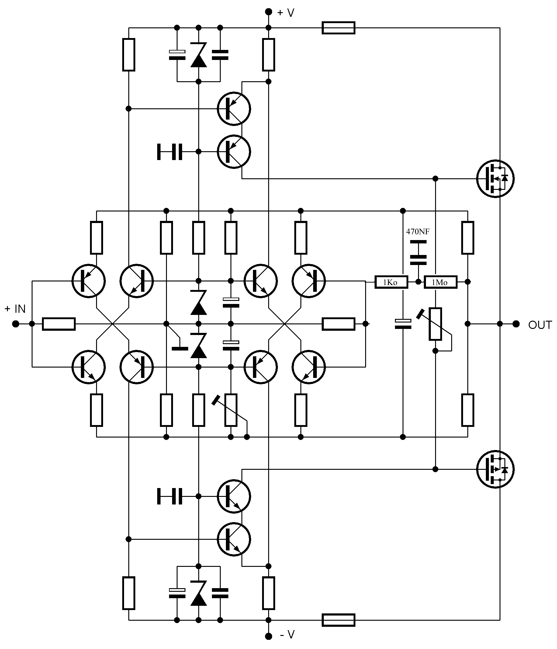

I'm afraid with this potentiometer on the gates of the power transistors and that the lengh of connections it suppose on printed board tend to some oscillations ? Too the driver's current has to be important in order to feed the gate capacitance at hight frequencies, right ? Can't be dangerous for the pot in case of failure ?I already made it in post #823 ...
This negative input could be used on asymmetrical input amps amps to add a a 5Hz high pass Tension Feedback in order to make a servo with reasonable condensers values. Only need one or two resistances more and a cap.
Yes. Answer:- Bias Servo. One BJT and One more resistor. That's it. Problem solved.
Look I prepared you some values. I'm sure that 15mA driver's current is sufficient not to allow outputs to oscillate. 😉
That would not cancel DC offset anymore than simple trimmer in sch cause the input stage has inherent offset variations which can be lowered only by separate DC servo. Please try to forget DC servo offset control here cause that is completely unnecessary by this design. 😉

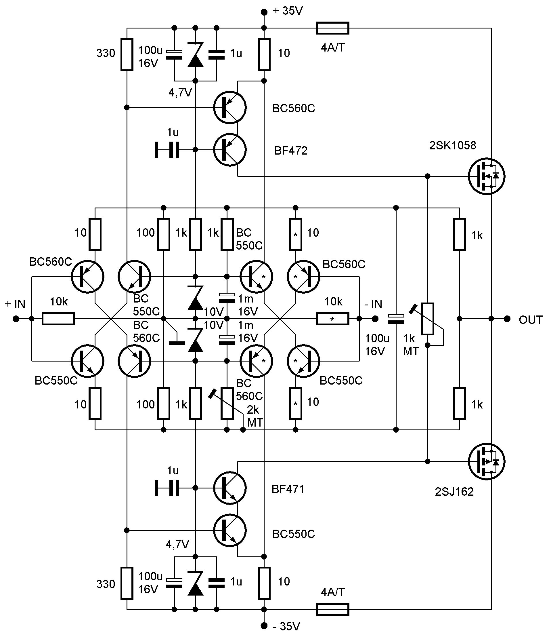

In SSA Balanced Input schematic I marked with * the parts needed for balanced version which can simply be omitted in unbalanced version, so very smooth transition. 😎

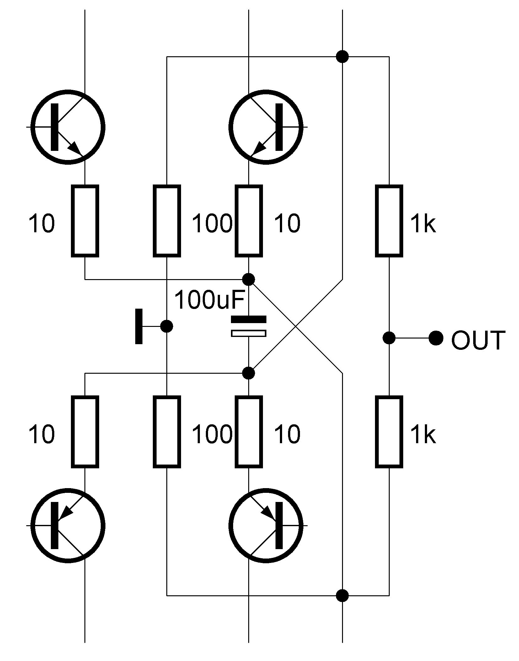

I suppose you could insert Jfets in the front-end as well..(I know the p channels is difficult)

The best part of this design is the impedance match of both inputs, they are completely equal and still you can define global voltage gain by SSA current feedback to their emmiters, not affecting the input symmetry, all in the same differential/gain stage. 😎
So if we want to keep the possibility to feed with sym source we can place sym parts on pcb bord and let -in floting when asym use. If that very great stuff.
Marc
Yes exactly like that (-IN to GND or omit parts when asym use). 😉

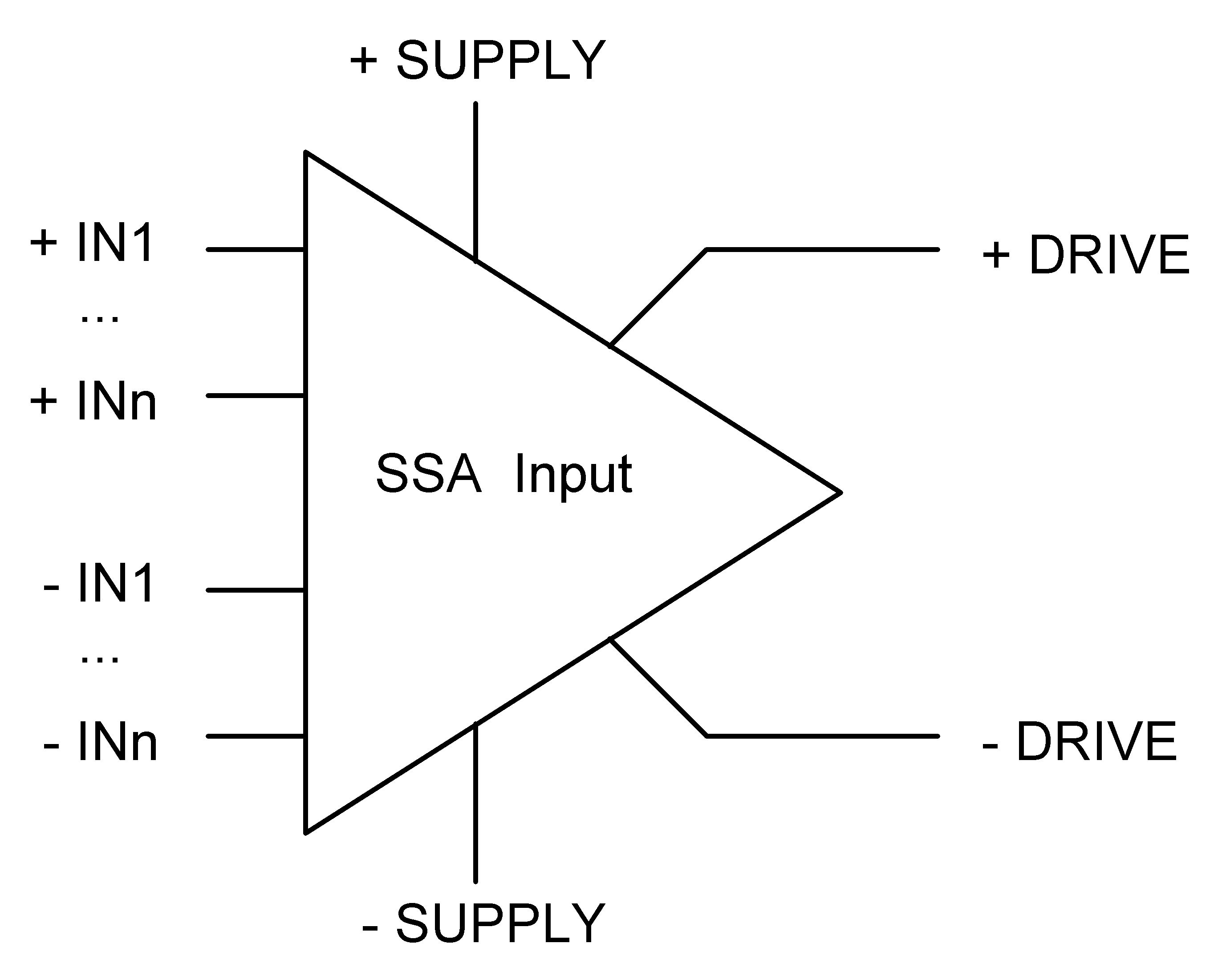

It would be even possible to add more * marked stages to make multi input stage for some specific needs.

This wiill reduce it,i'm sure of that, when unbalanced input is requested (i know, you do not like that, but i t like some times to reduce the move of cones of Bass reflex drivers under their resonances frequencies):That would not cancel DC offset anymore than simple trimmer in sch cause the input stage has inherent offset variations which can be lowered only by separate DC servo.
The 1k is unnecessary, just to protect the npn from short circuit of a power Fet. It will reduce the overall gain of DC to 1.1, instead of 1 if replaced by a strap. Without those somponents, the gain in DC is 10 with the proposed values by L.C. .
Nb: Following the PSU lines you use, so the power of your SSA amp, the CR resistances values (the overall gain of your amp) have to be set in order to get a full power for 1Vrms at the input. You can remove the 10k from the base of the NPN to the ground, and replace the 1K by 10k, as well.

Well, my proposal for a Board implementation would be using strap to give the choice: Symmetrical / Unsymetrical with DC comp and low pass filtering. With the cap value, filter will have a cutoff of 5hz with a 100k resistance, that you can change with the value of the 100k resistance. 47k will gives 10hz, 25k ->20hz etc, 33k->30hz. And you can forget to implant any of those if you don't want.

Also all symmetrical differential input designs can be easily turned into full balanced version with global negative current feedback. A whole new space of an experimentation opened, me just love it. 😀
