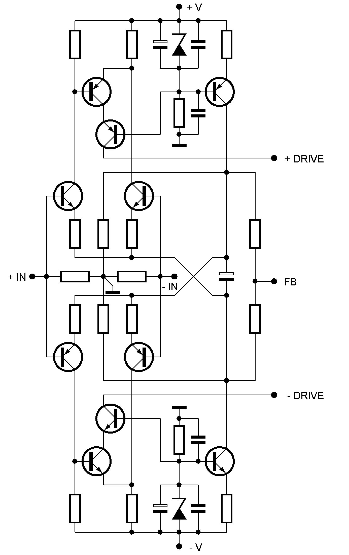

SSA Full Balanced Input
SSA full balanced input current feedback front-end. Maybe I'll try it someday. 🙄

May-be need of a trimer in the input to tune the common mode rejection. Once again, i do not understand the cap between the two emitters lines. Their trans are feed by a constant current, not ?
Beautiful, as habit, the way you mix the two first stages. Can be implanted on all the boards, as you can simply remove the two transistors and 4 resistances of the - stage if you do not need-it.
In theory the potential between middle points of a splited feedback loop-bridge is DC. All AC variatios should be in phase so zero difference, in theory. So the capacitor is there to bring the bridge to near the ideal theoretical conditions. 😉
Yes universal unbalanced/balanced SSA PCB fit the needs for RCA or XLR inputs as well. 😎

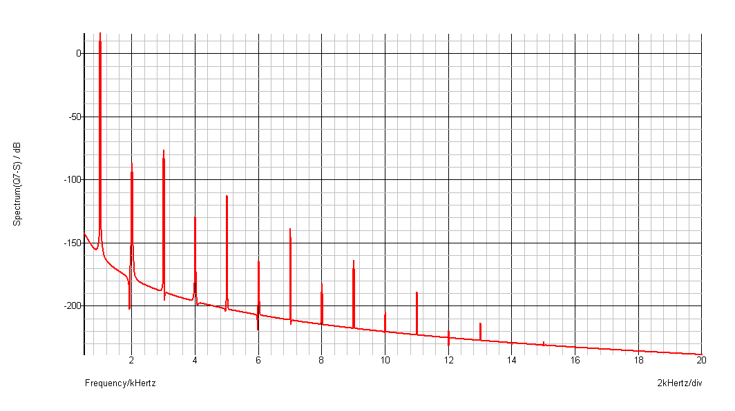

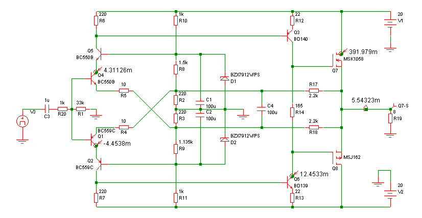

Lazycat, the sims look very good to me, maybe it's my turn now.
Meanwhile I am enjoying the opamp version very much, with zero bias on the FETs. 😉

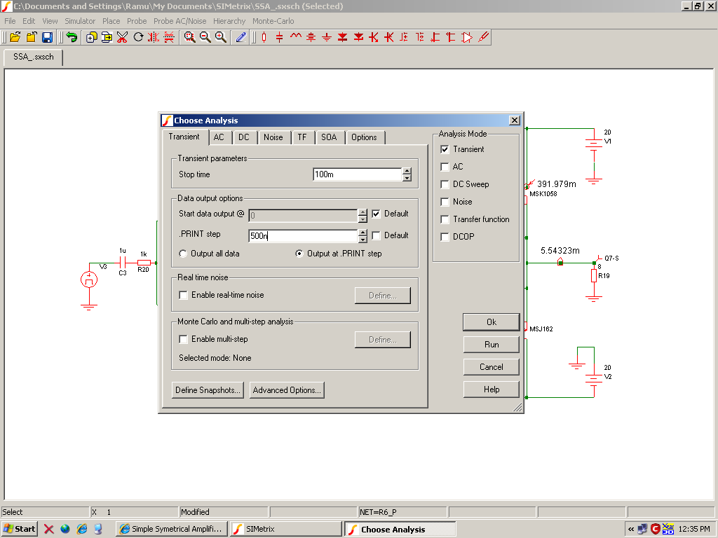

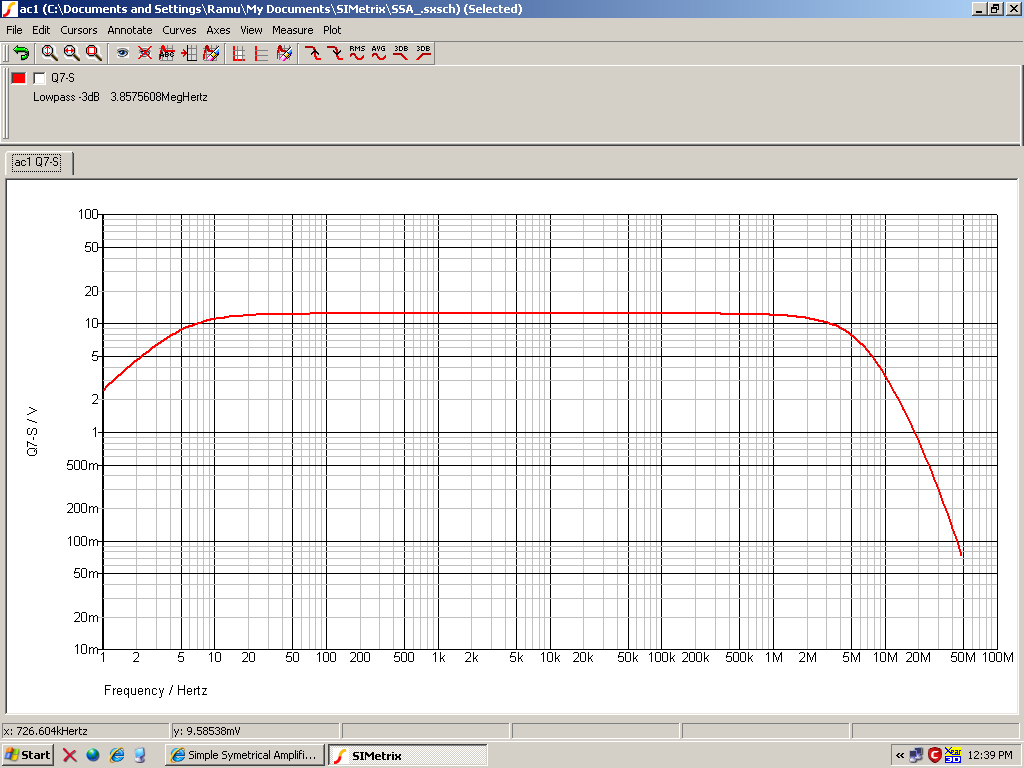

I'll start buiding my SSA tommorrow. No veroboard in stock. 🙁
I'm taking your word LC, that I don't need a servo. SSA better behave, or else... :bomb:

What is the PSRR figure of this design and how to improve it?
I believe PSRR is never a problem: A good amp need a good power supply. And, on my point of view, it is even as important than the amp design itself. Will try a good SMPS for my future class D+my modified SSA amp: i have a friend witch has changed the original PSU of a Quad amp for a SMPS and report a much better sound. May-be the little 100kz ripple you cant get rid off ? I had noticed several time that, adding a little amount of HF in an amplifier (as long it is fast enough to deal with it) improve the transparency and separation between instruments. i dont know why. Mechanical effect on the tweeters ? Or what in the amp ?

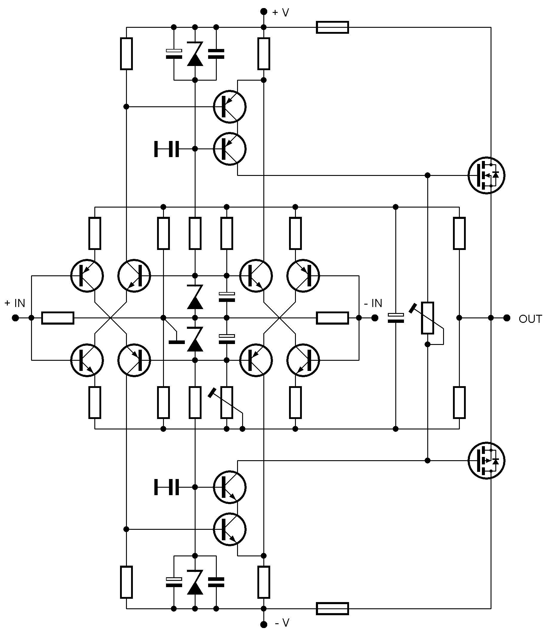

SSA Balanced Input L-Mosfet Output
I already made it in post #823 but that was more like transforming classic differential input to full balanced SSA version. 🙄
This one is complete transformation of the classic SSA to full balanced input with lateral mosfet output. As always, some will find it useful, others will stick to unbalanced input as well. Enjoy. 😉
