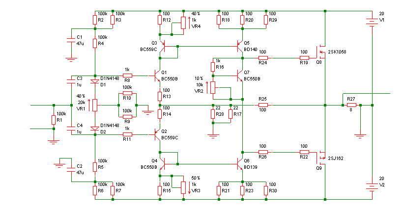

I had the idea to modify one of my good existing amplifier to current feedback and symmetric input.
Comments will be appreciated as i don't feel comfortable with my feedback design:
R18; R17, R15, R16
Only half (positive side) of the schematic shown.

I haw increase the gain of BIGBT by increasing this resistors to 2.7K (28dB) is that OK, and will there be any issues about instability etc…
By habit, and if the printed board is ok, CF is rock stable at all gains. The only issue reducing feedback can be a decrease of damping factor and slight augmentation of THD, OMHO.

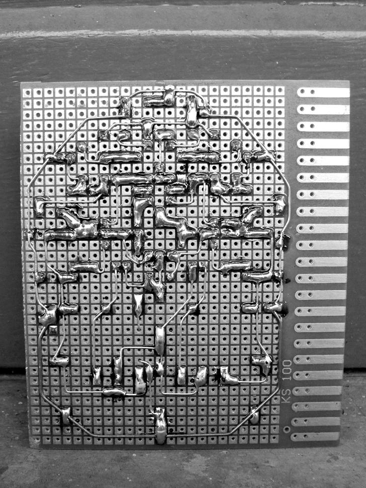

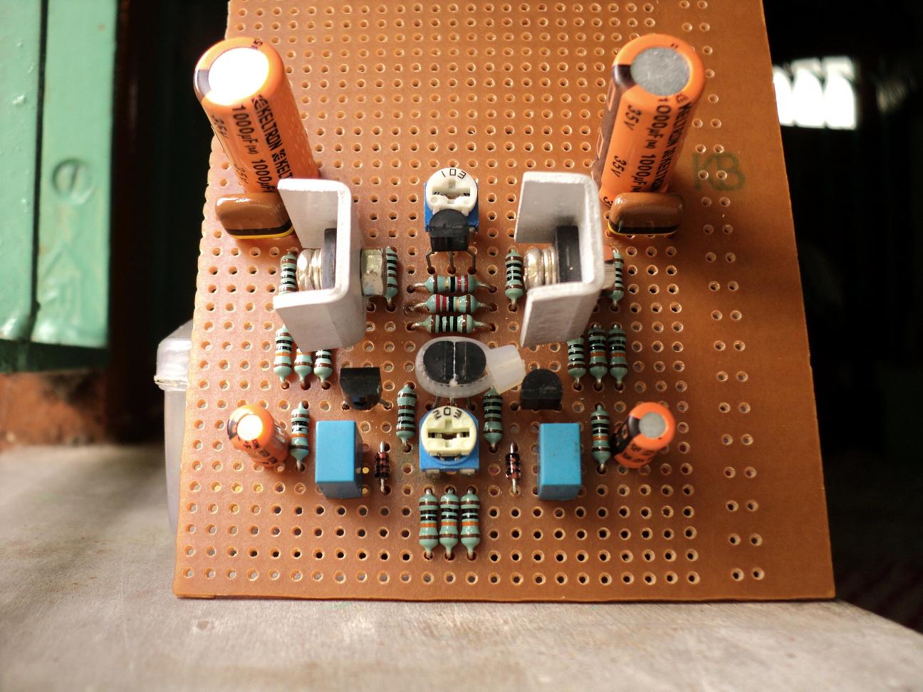

Board connections done. Added 1K pots in parallel with 100ohm resistors for fine tuning offset, after basic setting with 20K.
Going to fire it within an hour. Right now going to market to buy vegeatables - order from higher authority.
Very excited. :male:

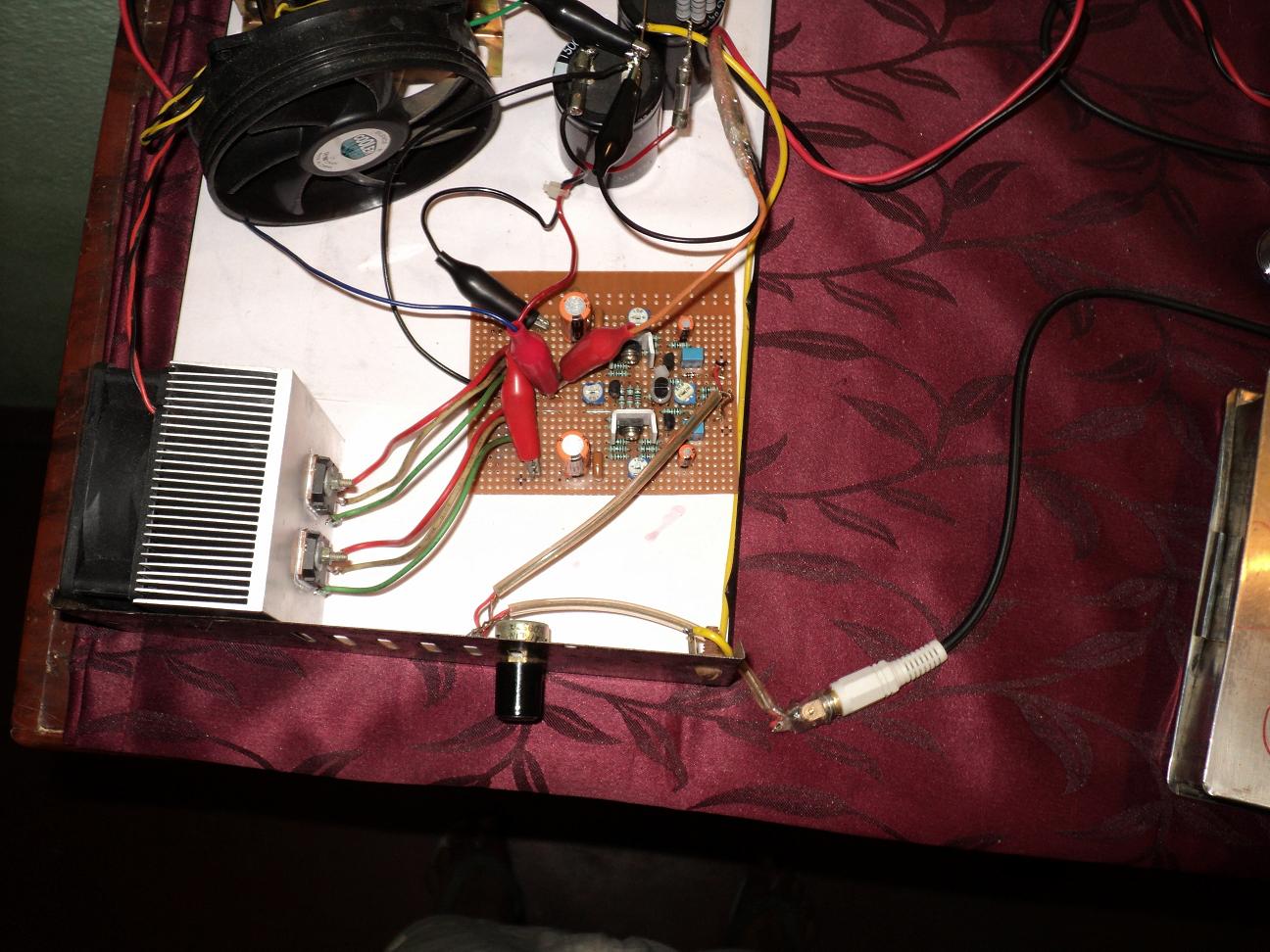

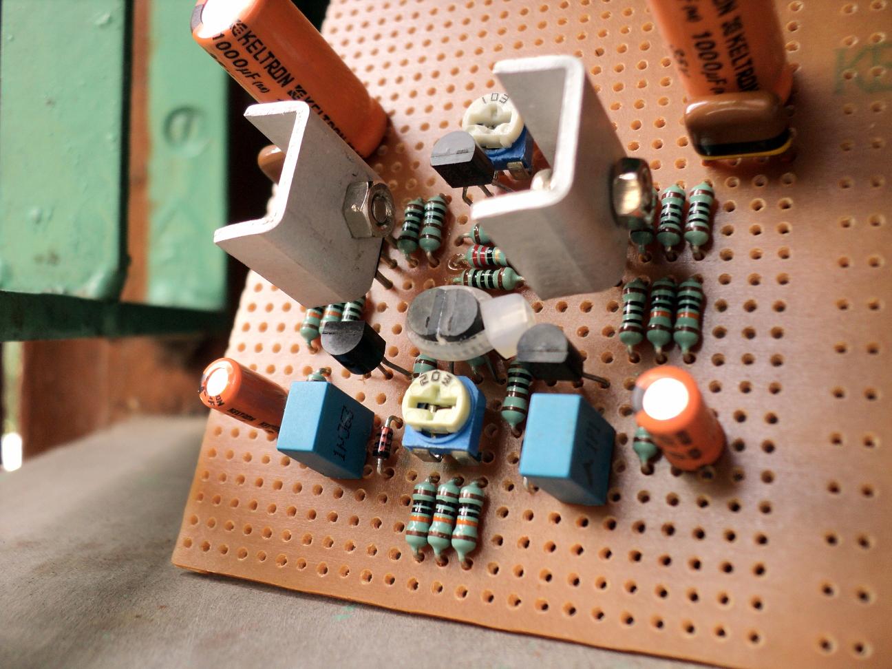

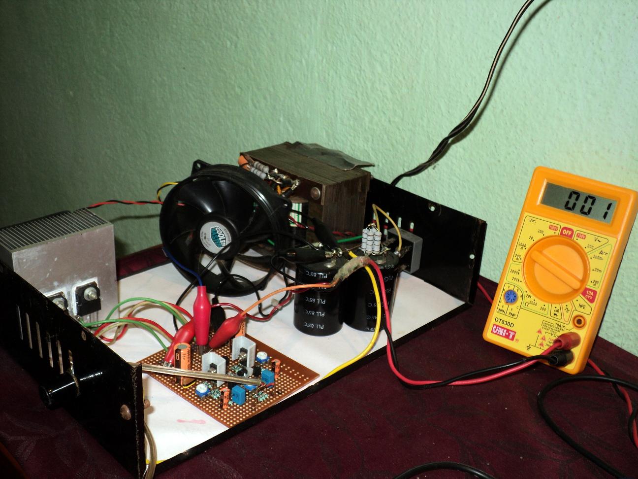

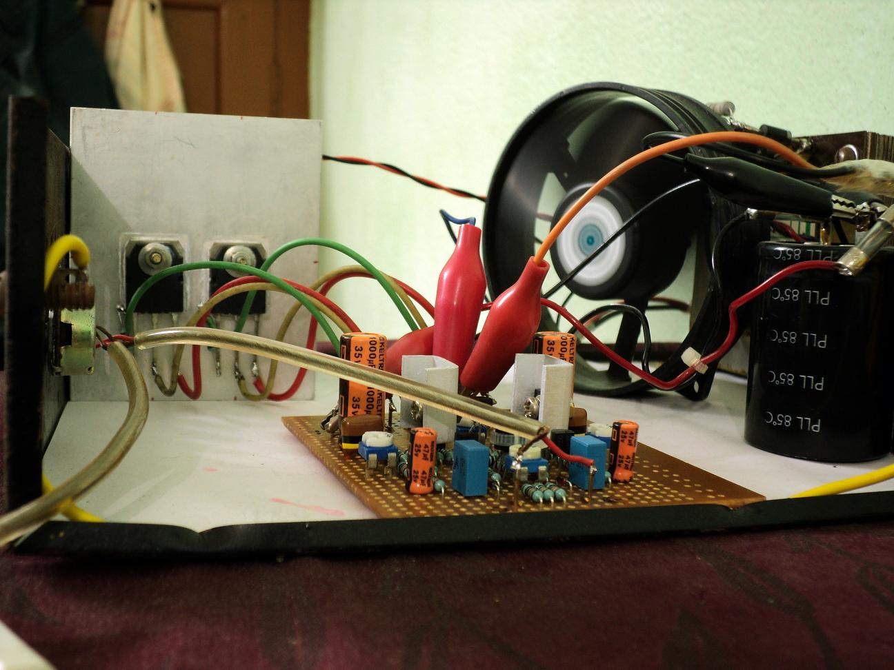

Initial test done.
Settings:
Bias 100mA total. Offset +-5mV(varies all the time). 100ohm gate stopper at board and FET. No source resistors added. Supply +-20V, 15000uFx2 smoothing caps.
Observations:
Stable bias. No oscillation(well, I don't have a o-scope, but my am receiver is very efficient in this job LOL, plus no overheating anywhere, the input BJTs are warm, the VAS BJTs are little more warmer, thats all and thats what I expected.) Offset isn't very "stable" but is limited to +-5mV, also is easily to set by the 1K pots after setting close to + or - 1volts with the 20K pot. NO audible noise with inputs open.

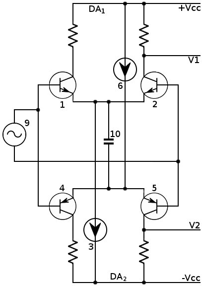

R18; R17, R15, R16
Esperado you've been attracted to this thread for some reason but was really not aware why at begining.
Your sch is classical example of people ingenuity to make progress on certain ideas. The SSA principle is very flexible and I can see how to implement it in your case turning the amp to current feedback SSA type.
Just remove R15-R18, D8,D9, split fedback loop like in SSA design (two times two feedback resistors) connect it to the emmiters resistors of input differential pairs, also lower 150 ohm resistors to 10 ohm. Leave the current sources Q3/Q9 like they are and because of cca. 1,2V DC potential between +/- diff-pair emmiter resistors you have to filter AC out with a good 100uF elco as much as possible.
Now you have your amp being SSA pimped. :D

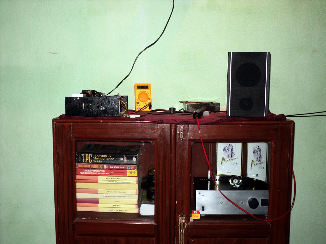

Impressions about sound?
Alive. One word is enough.
Well, mid bass to treble is perfect. Very good tonal balance, independent of volume; this I liked the most. A very transperarent sounding machine. I have yet to test the bass response as currently I lack a passive Sub.
I'll update transient production quality later; I think this needs more time than usual.
I know why ;-) I'm dedicated at CF from years now, using it exclusively as far as audio is in concern. And your design is f... brilliant. As brilliant as your kindness is touching.
I was away from electronic since 25years, and it is hard for me, now, i don't feel any more the things, obliged to make calculations for everything, age is a nightmare, too.
That was my purpose, before to build from scratch YOUR definitive prototype.
Just remove R15-R18, D8,D9, also lower 150 ohm resistors to 10 ohm. ...because of cca. 1,2V DC potential between +/- diff-pair emmiter resistors you have to filter AC out with a good 100uF elco as much as possible.
See attachment, that's what you means ? I just wonder why you want me to change the emitter values from 150 ohms to 10, it increase current and open loop gain, right ? it need 4watts for the 330 ohms then, and, if i'm correct, the gain will be 33 if 330ohms are set to 660 now ?.
Where did you see this 100µF, where i have put the 1000µ ?
I'm lurning LT spice, right now, and it don't want to pimp-it :yell:
But, when it will go, i think we'll have all the inputs architectures, now ? This one is complementary from the Shaan one. (Congratulations, Shaan)
