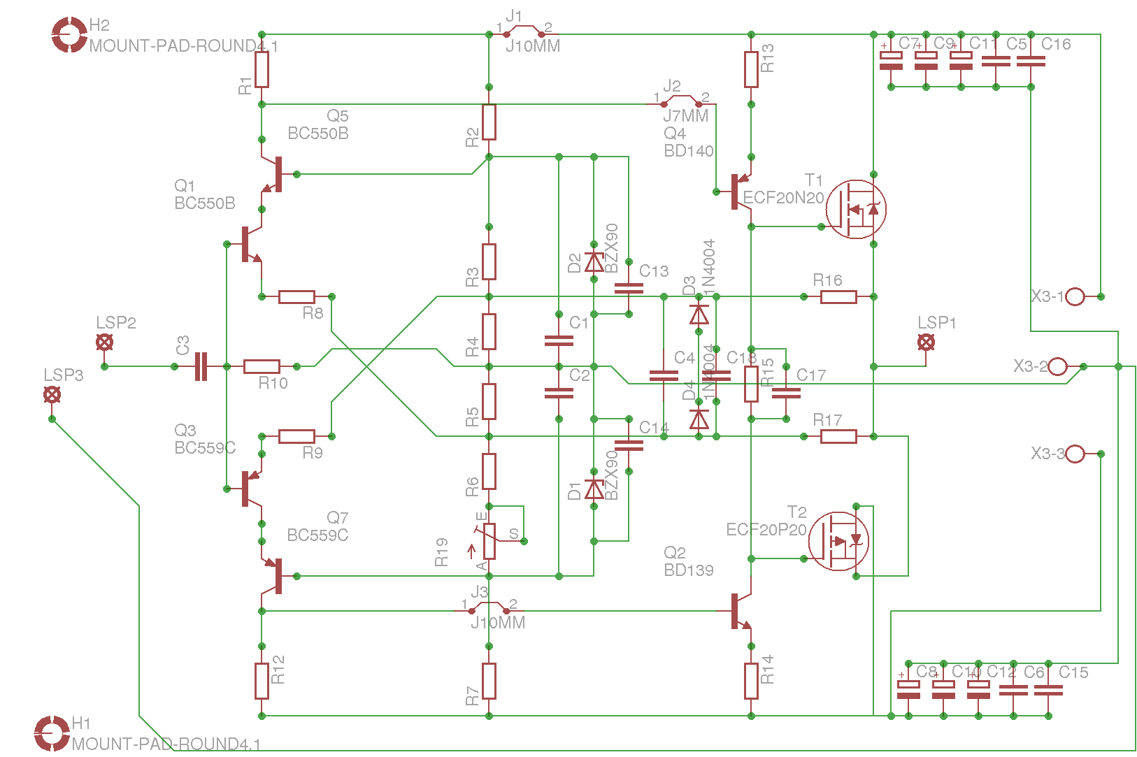

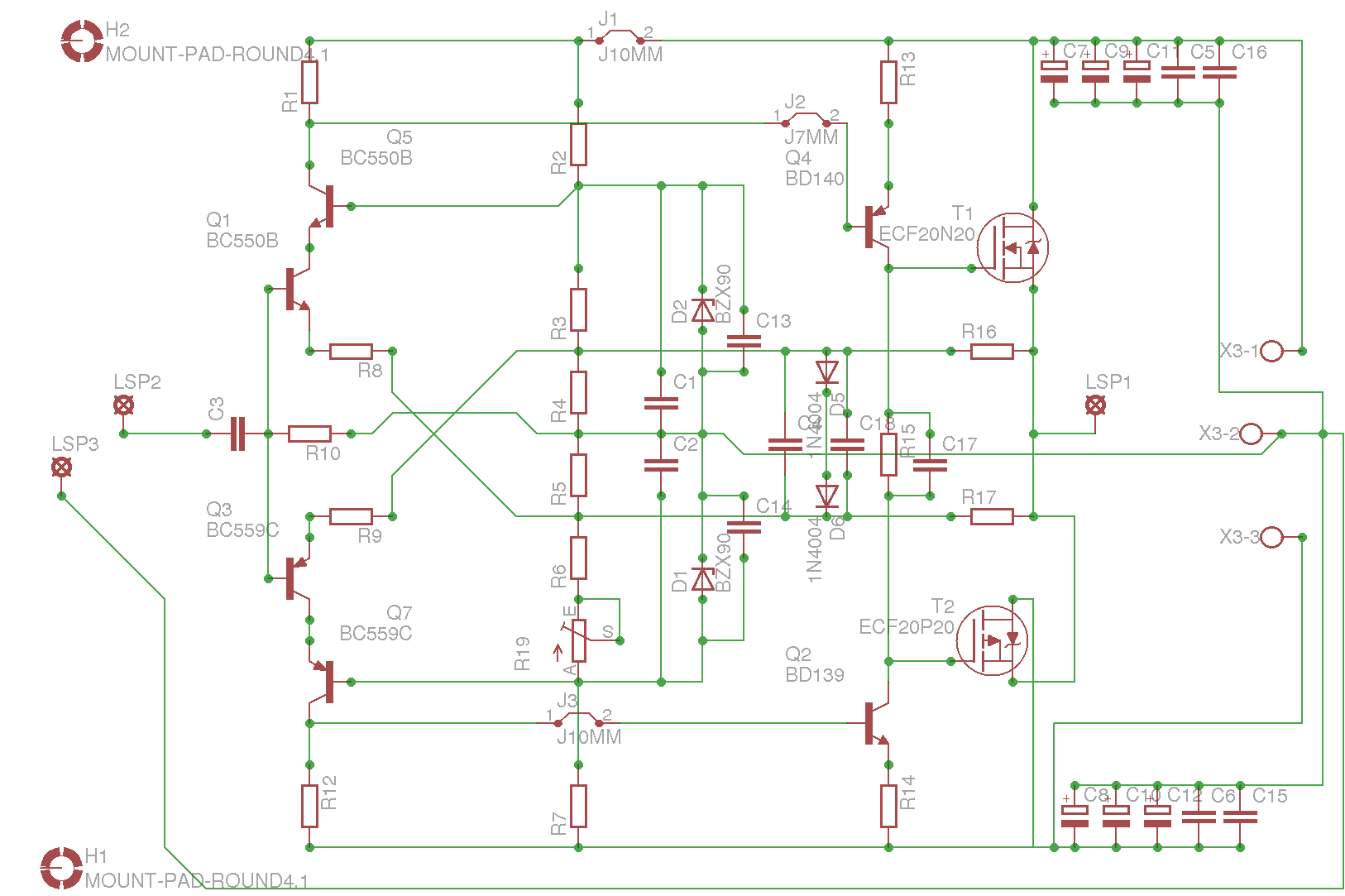

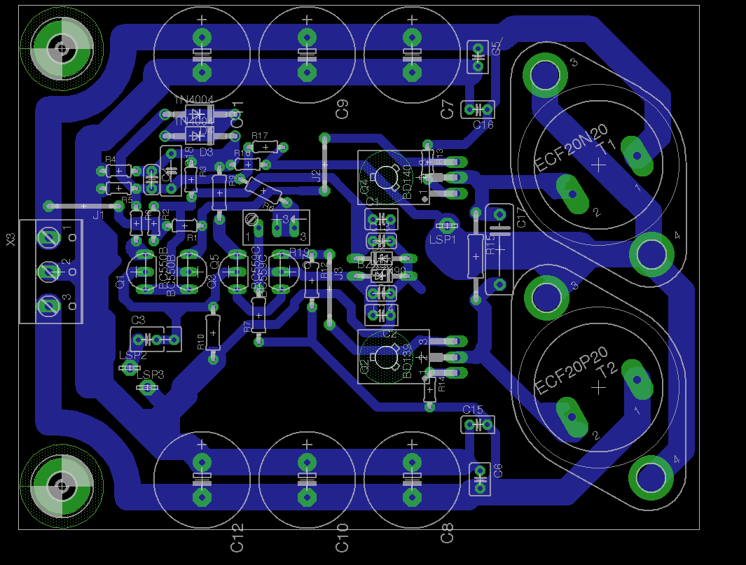

thanks lazy cat, did you just mean the green junction dots? if so hows this one?
Better now
So first we'll clear out sch and you'll correct the PCB in accordance to:
- R11, R18 goes out
- C3 should be 4,7 uF so it needs more space around on PCB
- T2 you must change drain and source pin !
- please provide two 1N4007 in series diodes, parallel to C4
- please add one extra 1 uF cap parallel to C4
After sch + PCB correction I can check.
... can i substitute the NJL outputs for MJL , is there a difference ...?
You can, but than you will need linear Vbe multiplier (one TO-126 BJT, one diode, one multiturn trimmer, two resistors) instead of four thermal-track diodes. No big deal.

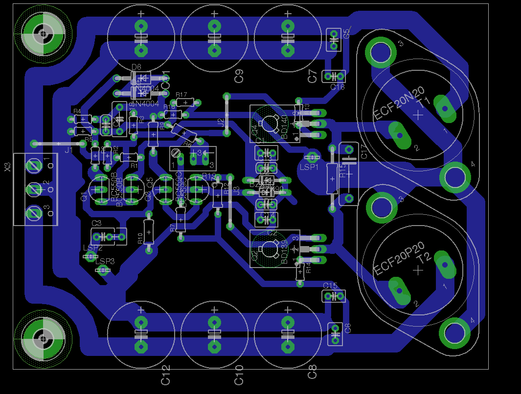

One more thing regarding PCB:
- Q1 and Q3 have to be face to face glued together. This is mandatory.
- Q2, Q4 each should have small heatsink, also mandatory.
- T1, T2 probably there will be Al L-profile fixed to heatsink? Provide good thermall contacts ...
That's it. Bye

thank you Lazy Cat, yes ill glue the faces together on the input trans and yes a drilled 5mm L bracket for the output fets, thank you so much for the help, steve.
Your PCB does not correspond to that request.
Q1 and Q3 have to be face together, not like it is now, so please rearrange the input section completely.
