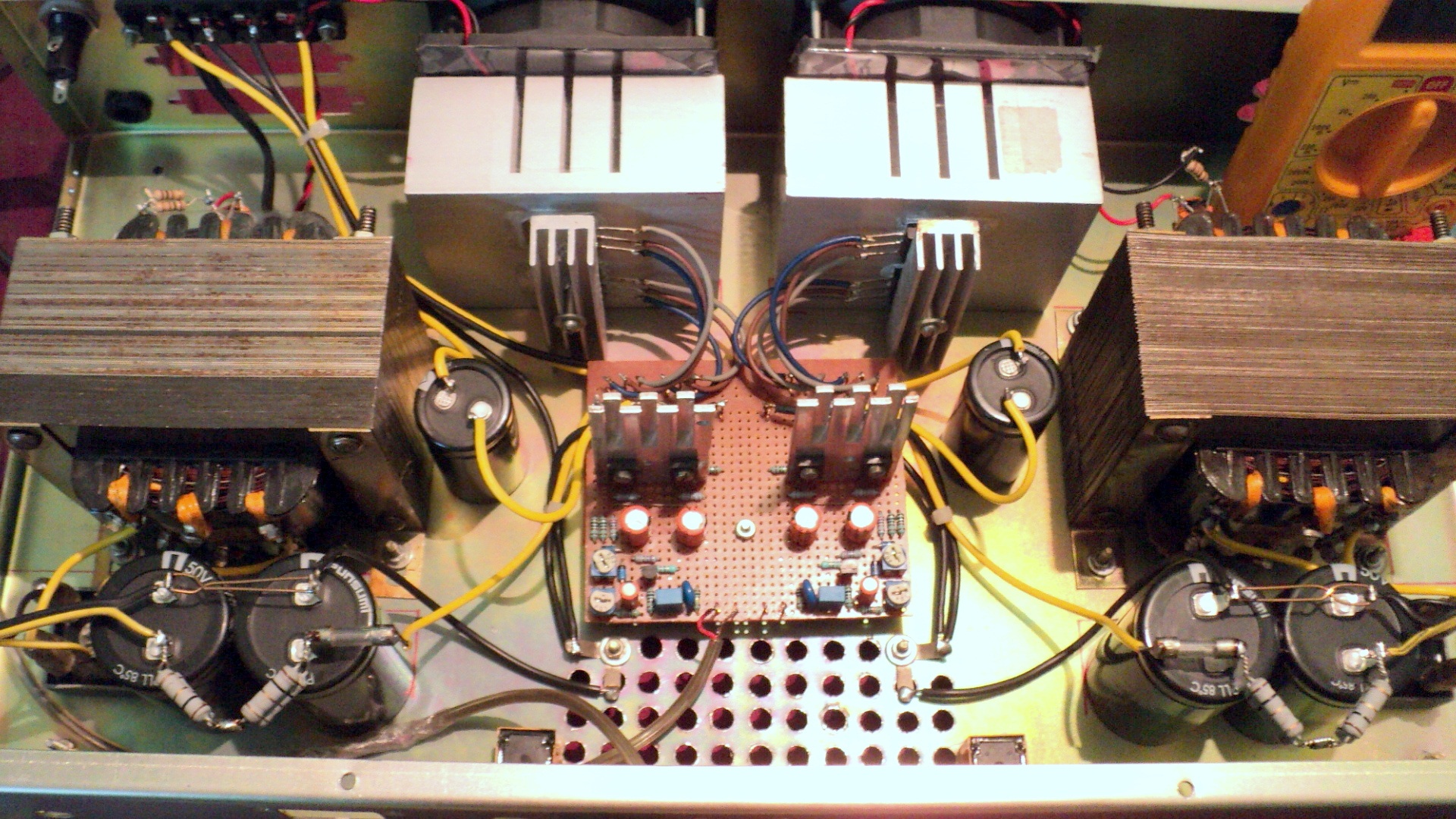

Today I made initial power up of the CSA VAS and measured some DC points. For a fresh start it looks quite promising. 🙂

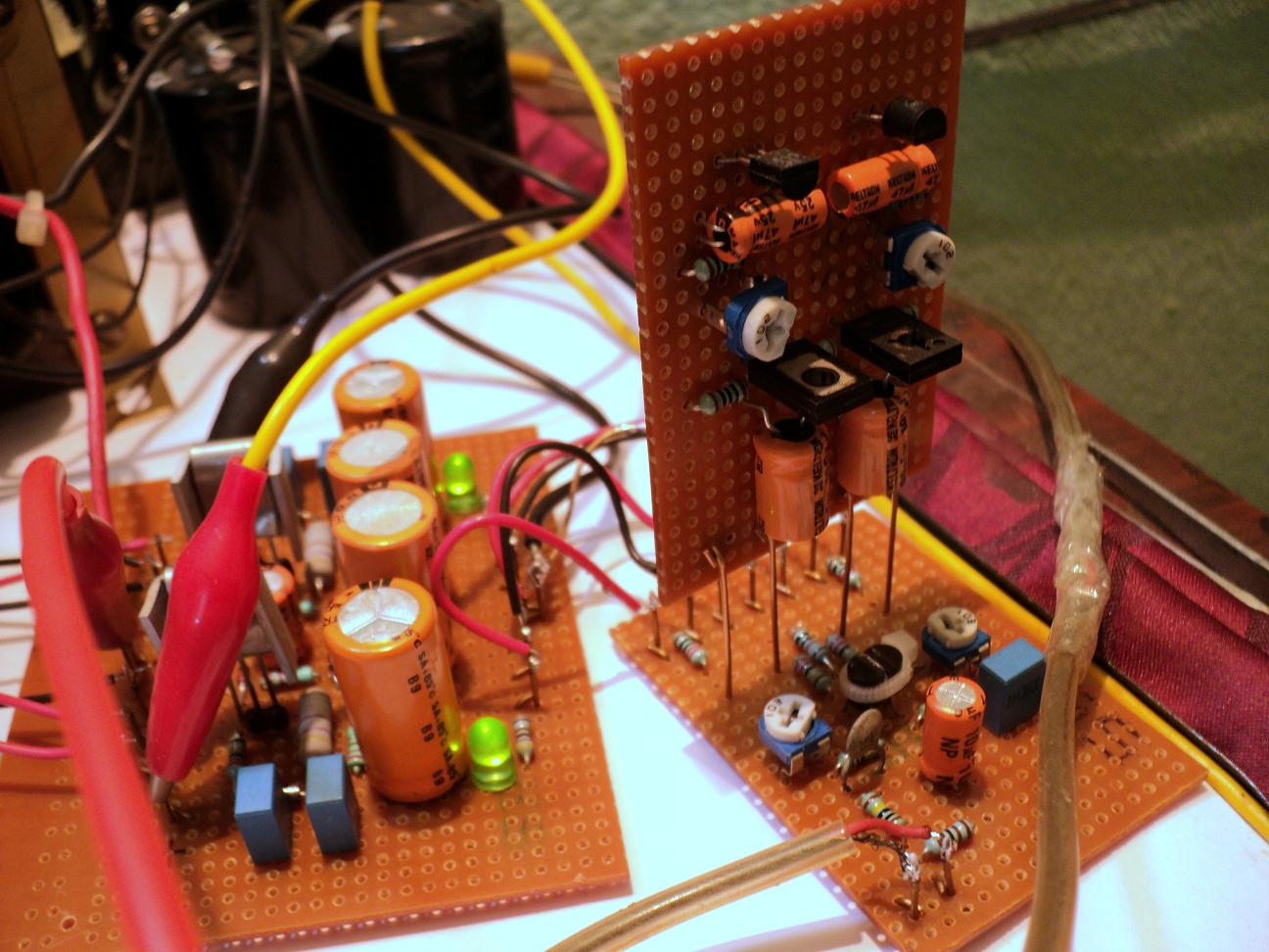

Update:
After letting SSA with the new CCS run without signal for a whole night I checked the offset and bias after waking up in the morning. Unchanged.
Yeppee! Feels like an achievement!

Hehe... I'm just happy LOL.
Thanks Andrej and all.

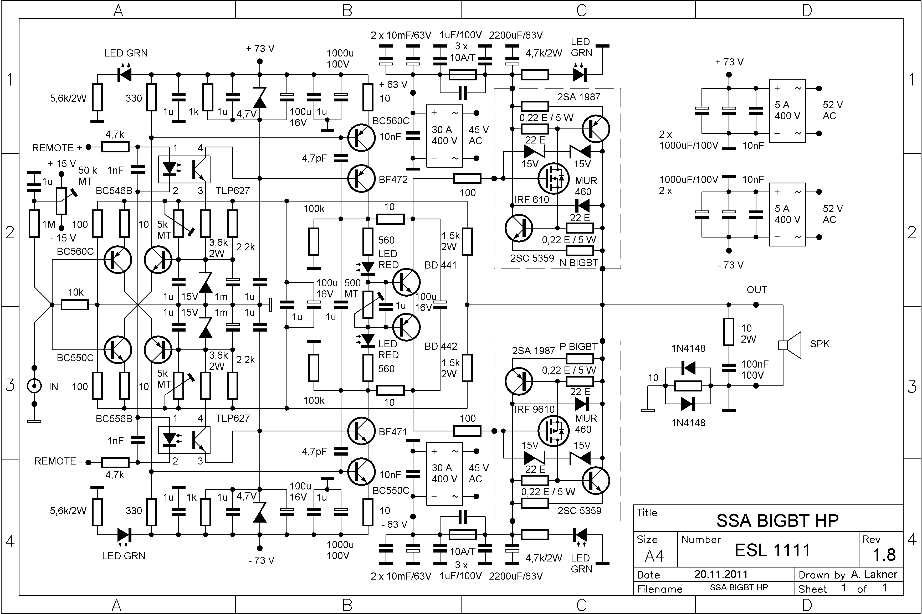

LC, by CSA, do you mean this? Or some other beast?

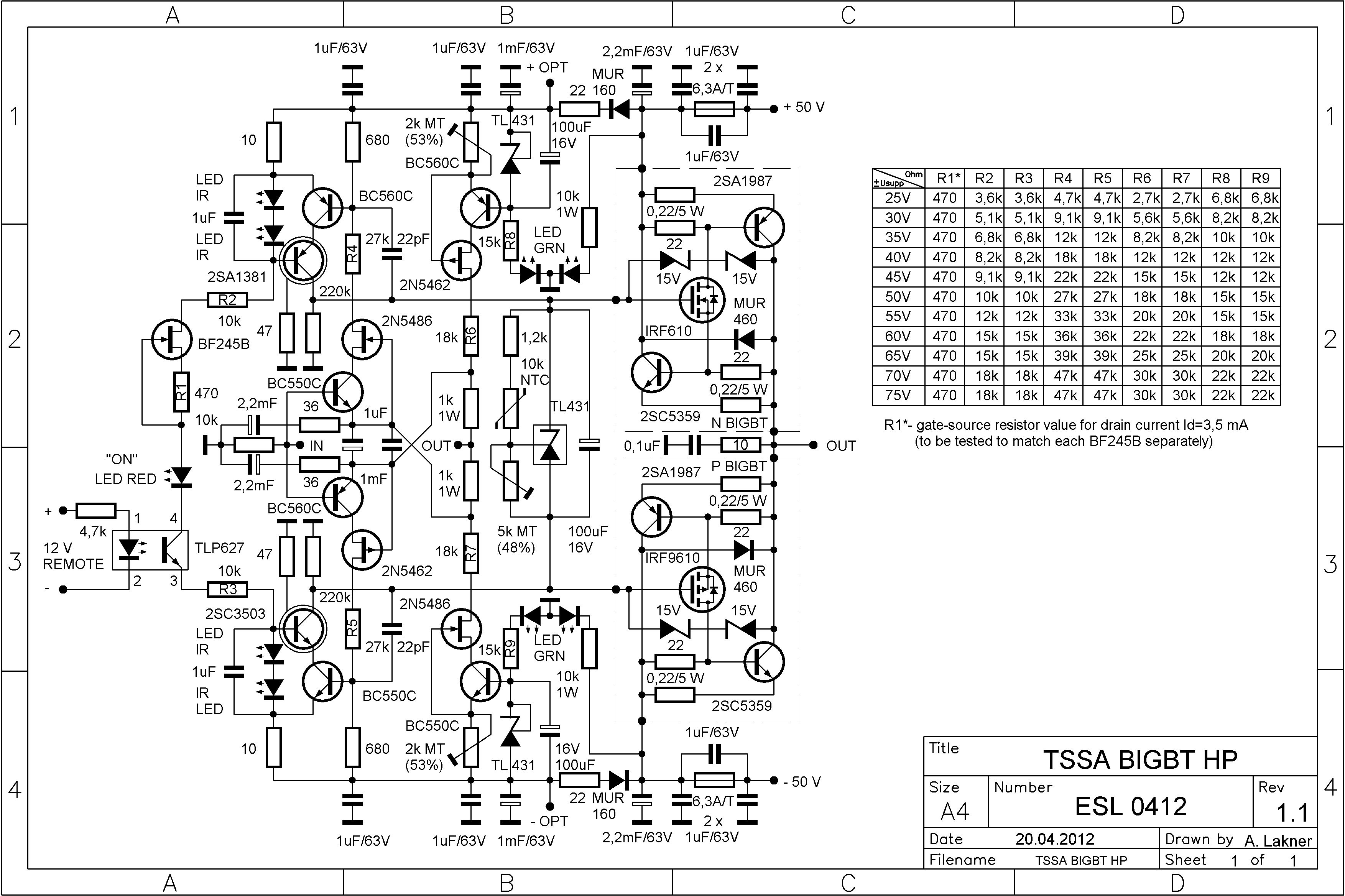

I like the simplest versions of SSA and TSSA, they all produce nice sound, but Lazy Cat wouldn't be satisfied if not checked what's max performance one can get out from this topology. So logical step is slowly but gradually to go to high performance (HP) versions of them all. Continuous learning process progresses as you can see if carefully follow the threads, many solutions appeared on the way, which were tested and implement by individuals. Many of you experimented and adopt different variants based on common SSA CFB topology, very nice evolution happened since the start. Sonny is the first who's successfully managed to start group buy of his version of TSSA amp, offering best info, PCB's, parts, manuals, we all others are still searching ...
Sch from your post is SSA BIGBT HP before applying CCS, than TSSA BIGBT HP came (pic) which will be soon build by Marc (Idefixes) and than I extend this one to CSA sch which is now in testing phase. CSA stands for Complex Symmetrical Amplifier, which name explains itself. VAS is packed with semis: 22 transistors, 7 reference zeners, etc. Output is of course my preferable BIGBT. Looking to TSSA BIGBT HP can give you an impression where to CSA is evolved onward. 😉

Not this one. This will probably just be there in its naked phase for enjoyment, experiment and learning. I learned a LOT and am still learning and want to learn more.
The one that will go into a metal case is another pair of SSA on a larger board(veroboard of course 🙂 ) for one of my friends who lives about a thousand km away but was present here with me while I had just finished the resistor-feed SSA. His jaw just dropped down to his feet when SSA played music and after 11 days of audition he said I must build one just like that for him. Delivery will be in December or new year. 🙂
His presence helped me a lot in determining the truth about SSA sound. He used to listen to it almost all the time with a smile and often went to sleep during listening, at quite high volume. I was assured that SSA is indeed different and better than usual market stuff. :up:

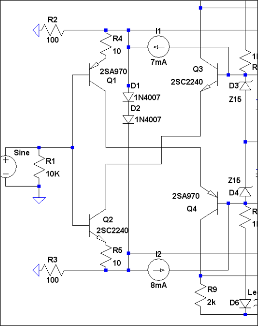

Depletion mode two terminal CCS in the form of BF245C JFET or Supertex DN2540 TO-92 MOSFET (Sheldon) were effective enough, and as far as simplicity and compactness goes, handy. We added them some time ago if looking rather far back in this thread. Trimmers for their source pin degeneration can give current control, and they can be added easily on main test board of course. Your ring of two BJT CCS is maybe better tracking the input pair junctions and worth the extra boards though, quite possibly. Talking about those same positions, the ones injecting to the input pair emitter feedback summing resistors (I1&I2), right?

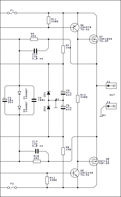

Salas..
What are the two Diodes D1-D2.. for..?? thermal..??
One reason for the BIG improvement with CCS, is that the current injection from the feedback modulate the current running the circuit, The signal simply alter the working condition of the circuit. this is not the case with the CCS solution where this mechanism is taken out...

The diodes are those two to help open the power LatMosfet gates equally, just drawn to the other side, same nodes, see them again in Nico's.
Yes current modulation, that is the reason why TSSA came about also. Will be interesting to hear what does it better, DC to ground FB, Sziklai source follower 175mA, or AC to ground FB, emitter follower and common source 0.6A, already got a pair of Sonny's SMT boards to make one.

That's right Salas.
The two bjt CCS proved to be reliable, both in current supply stability and thermal independence. I also has extremely low noise, I can hear the noise only with an ear-over-speaker test.
Ring of two is trusty, one of the stablest simple ones. I use it many times too. I had measured bandwidth extension by 25% when I had applied the JFET sources, you should got some of that too, if by any tell tale sonic clue.
