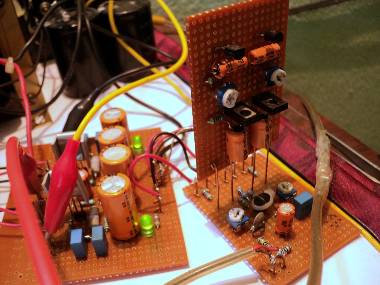

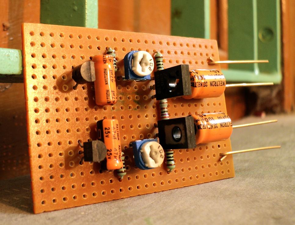

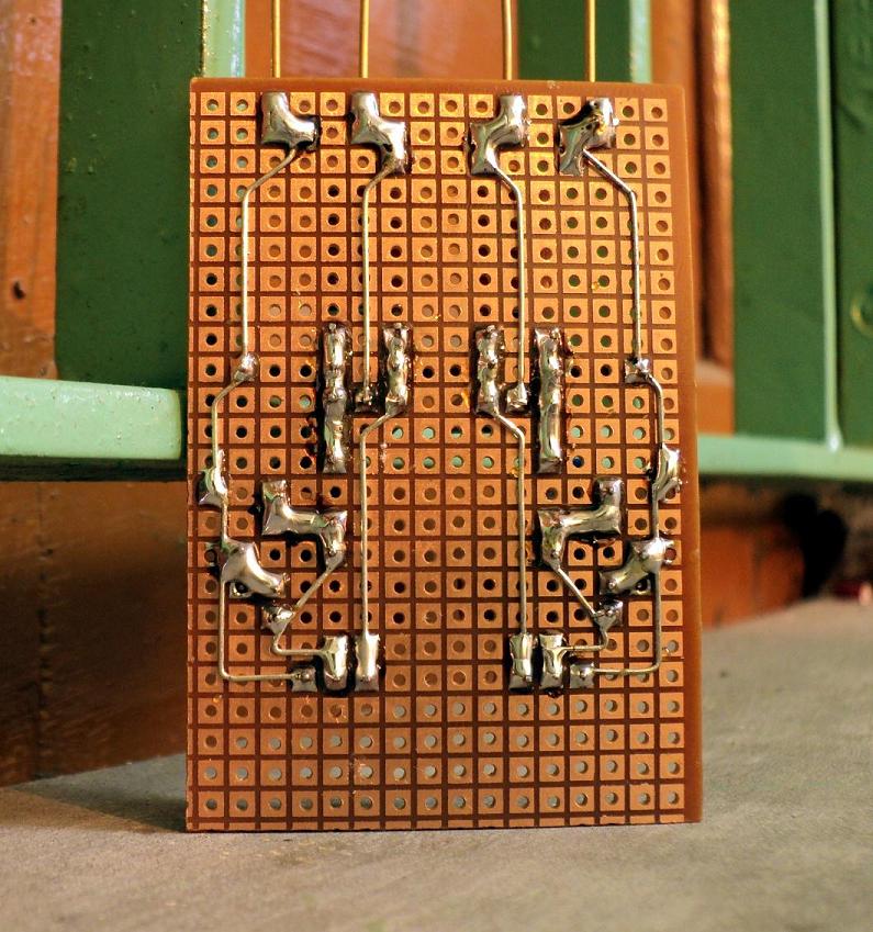

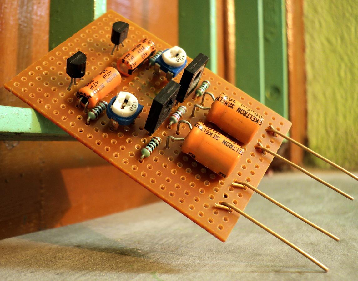

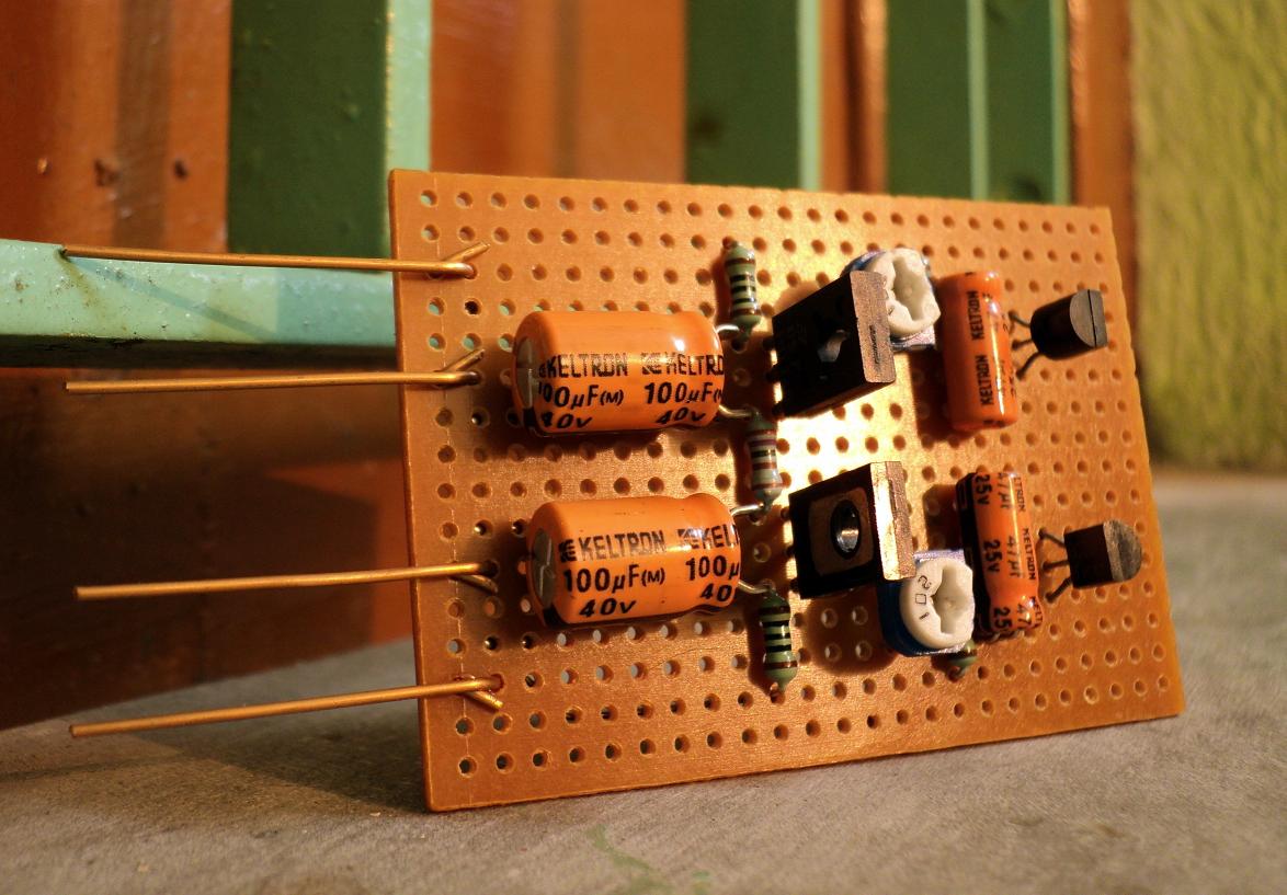

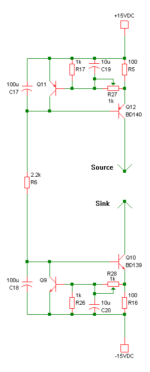

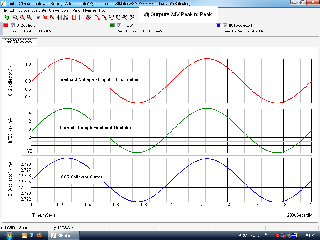

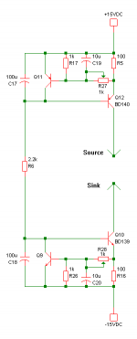

Well, before going for the standard SSA CCS made of SSM, TL and jFETs I was thinking of a last take on a CCS commonly used in many amplifiers. I wonder why I didn't think of it before as I have many many times used it in my previous projects with good results(although not in a similar place as it is now).
I have simulated the CCS with the SSA and this one really shows some hope. I think everybody here understands this CCS more than me and so I am not gonna "describe" it. I will use trimmers there to control the current and measure it around the 100ohm load resistors.
It looks like this CCS is fairly tolerant of temperature variations. Heating the BD bjts to different temperatures seems to affect the offset to +-10mV at most. Also the current looks super stable with signal at 7uA CCS current per 10mA feedback current(1:1400) or per 1000mV of feedback voltage(1:140000), all AC. This is only what I see through the monitor but don't know how to derive the dB value of the CCS variation current. Please educate me. I attached some traces. I am going to build it and will update once tested. I hope this one will be less noisier than the Wilson.
This will do...
Test done. Results very positive.
1. Very stable current supply, offset drift from cold to warm is less than 15mV.
2. Almost zero noise from speaker(input short to ground).
3. Turn on thump gone(only a little cone excursion). Also both + and - PS capacitors drain equally at turn off.
4. I was worrying as the CCS doesn't use the ground potential, what if it doesn't start. But it did. Something new for me, hasn't played with symmetrical CCS before.
5. Music come alive. Mission accomplished! Clean and Clear. Going nod-nod and tap-tap... WOOHOO!
- Simple Symetrical Amplifier
