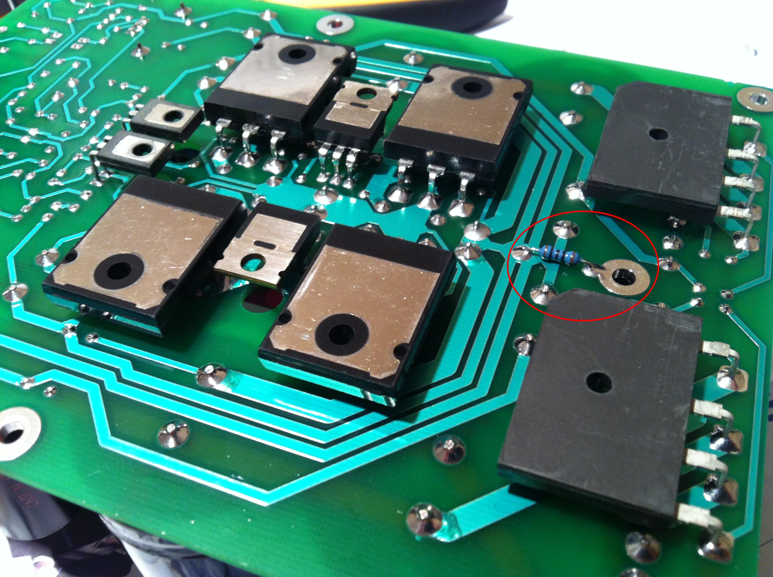

I just upgraded my regulation scheme to this.
The new feature is the 100R resistor between the full earth of the casing and the star ground of the amp - got this from a TI application note that Sonny gave out in his TSSA implementation.
Big thanks 4 that Sonny !
It never occurred to me to include that resistor but upon examination it comprehensively completes the filtration system of this design
Hi mikelm
You can find this 100 ohm resistor on bottom layer of my old SSA PCB (it is also included in new CSA PCB-s). It serves many purposes, one is you mentioned, second it serves to define potential of the heatsink in a testing phase when heatsink is alone, not yet assembled in the case. ;)

Hi mikelm

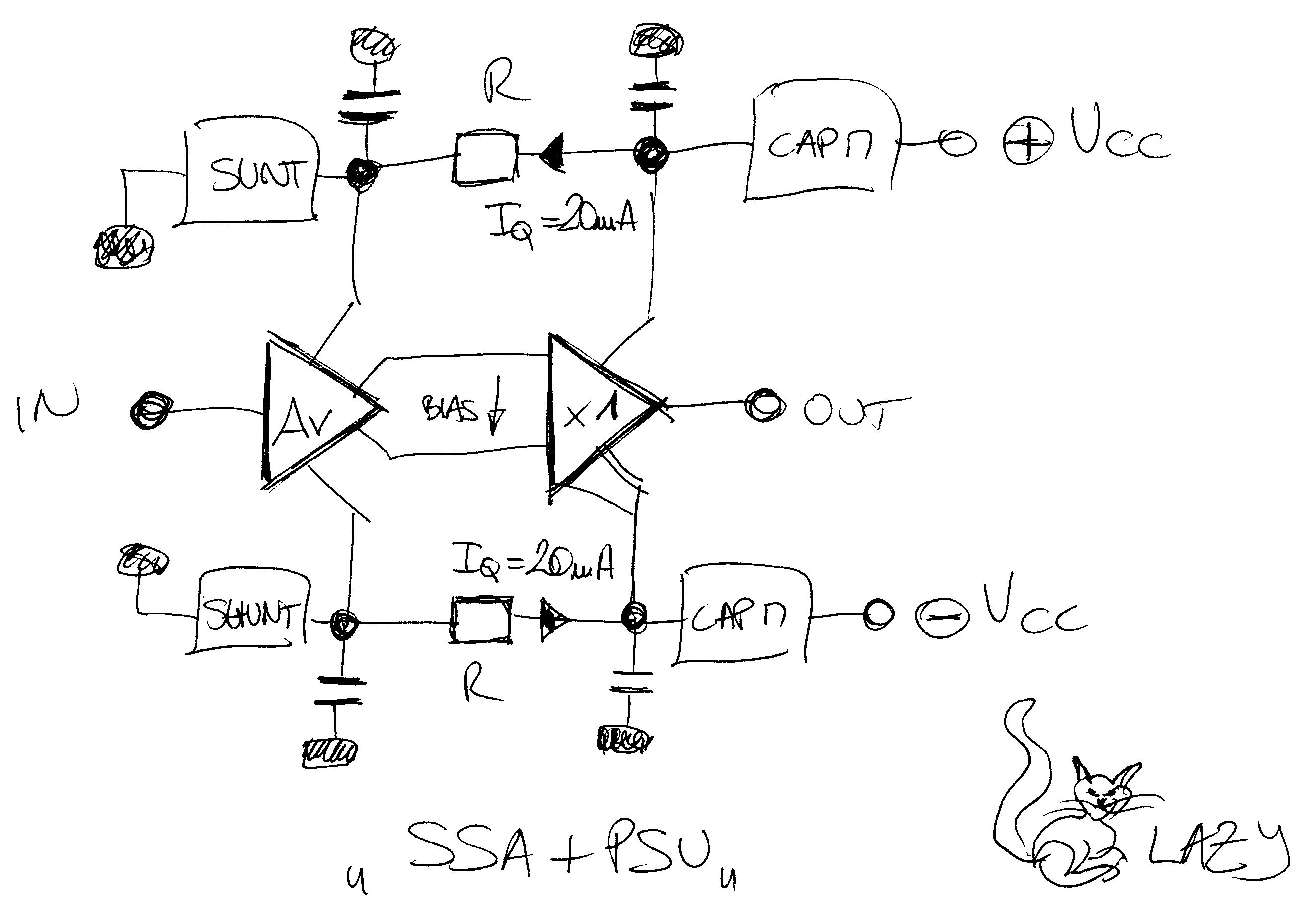

To LC, it would be interesting (i will do on my side if i find time for that) to study a perfect PSU for the SSA. I imagine a combination of serial and shunt regulation, ( with big loss of power expected ;-). Something like common serial and one shunt regulation on each amp board. To see if any noticeable sound improvement.
At this level of quality, no major improvement can be done amp side. PSU can bring the next big step. Don't you think ?
Hi Esperado :wave:
Yes, SSA would only gain if PSU is designed and calculated correctly. The aim is still to maintain low PSU serial impedance and reject ripple to voltage gain front-end. A lot more parts to play with but all in a purpose to elevate sound quality. :up:

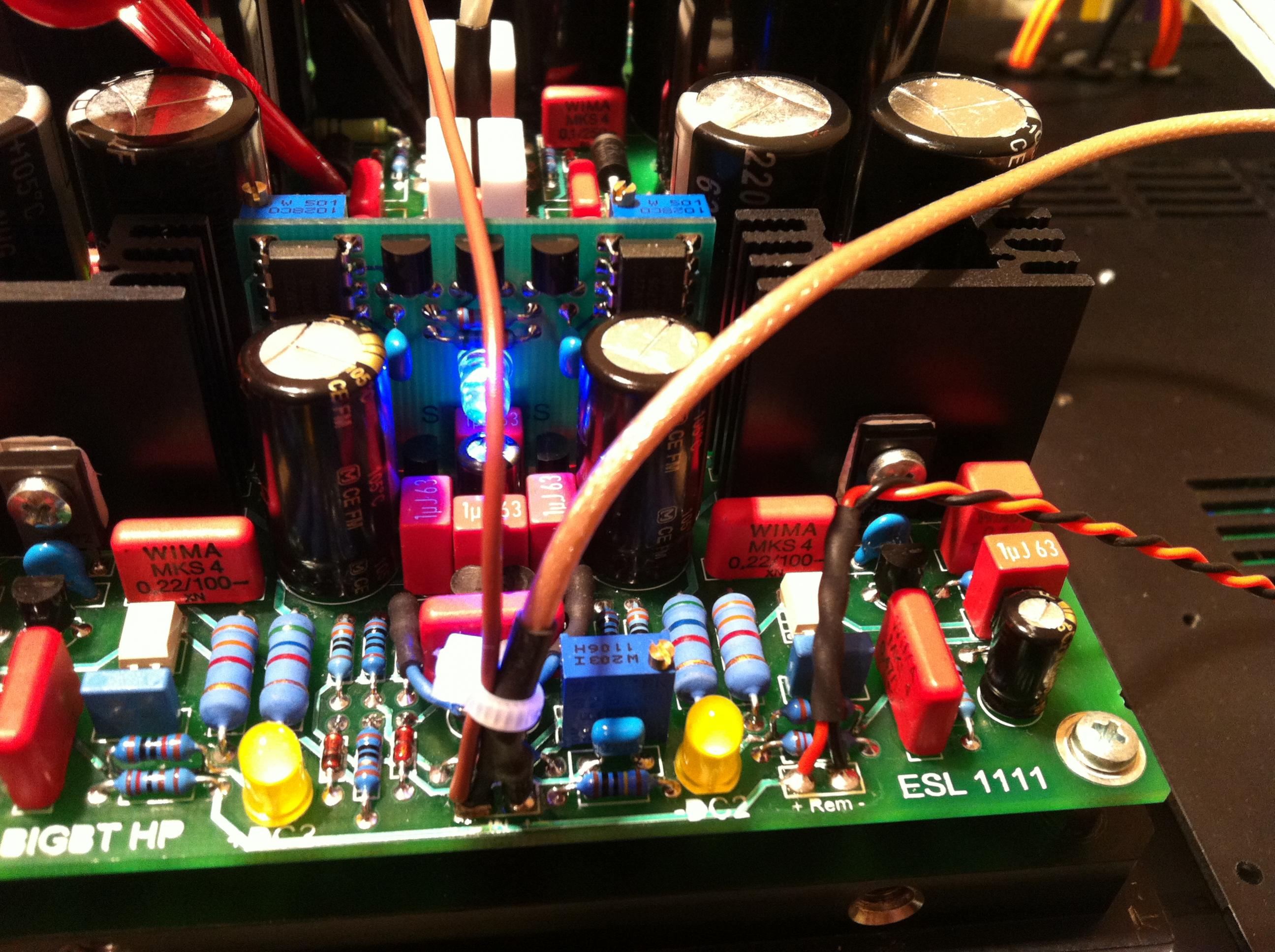

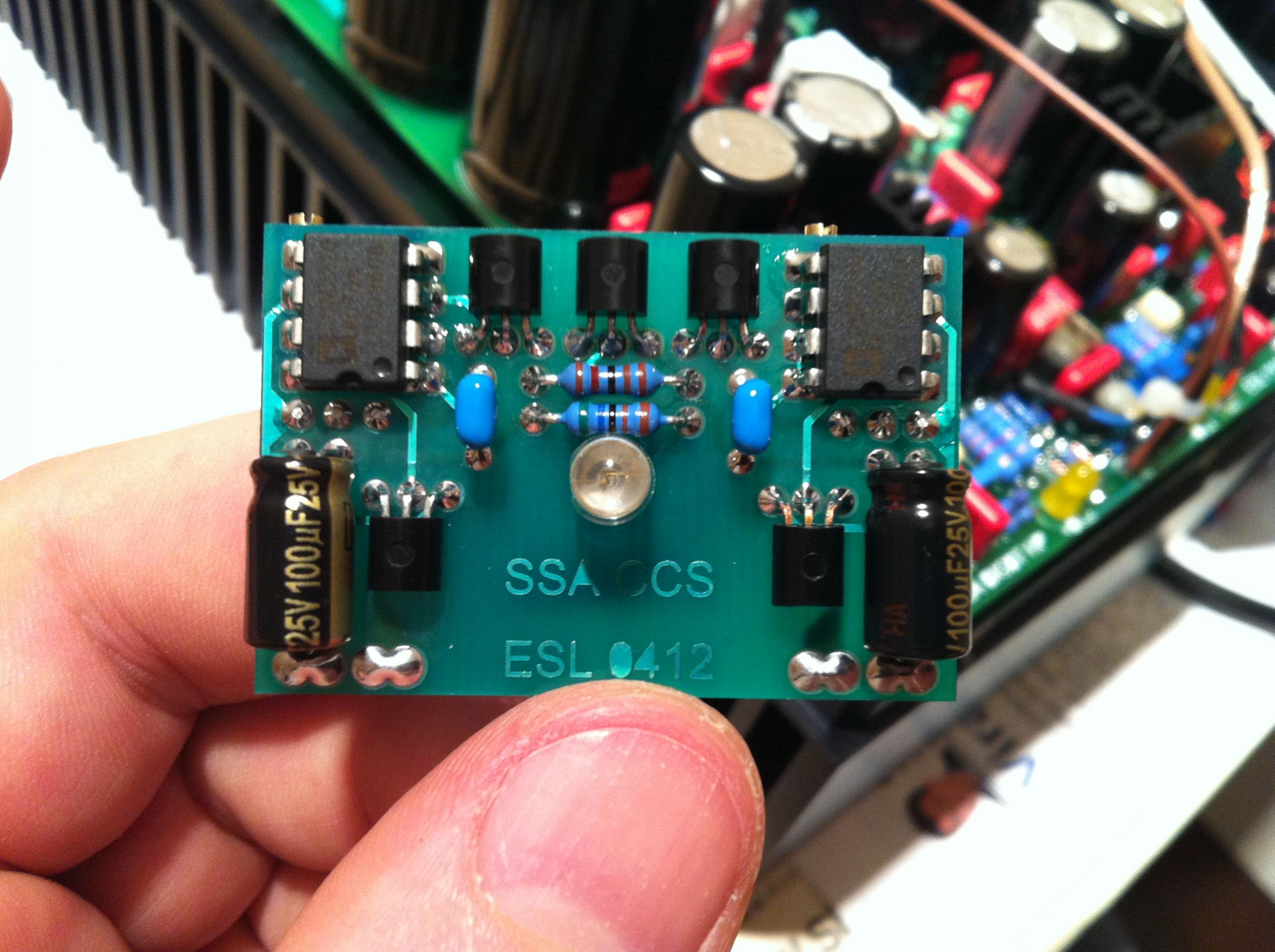

When I put CCS-s in SSA it went flawlessly, no other adjustments than just correct quiescent current. :up:
Same here. Just connected the mirrors and ran the amp. It went as if nothing has been changed. The total Iq has decreased about 20mA(at 160mA, before was 180-185). I set the offset and immediately played some music.
This is AWESOME. BIG change in the stuff that's coming from the speaker. It gave me goosebumps haha. The whole soundstage has gotten bigger, it felt like the speaker isn't 4" any more, it's a 8 inch one. Marvelous! WOW. Clean - Clear.
CCS cause modulation of input/feedback BJT to be independent from Rinject voltage drop, so really purified, lot less THD. ;)

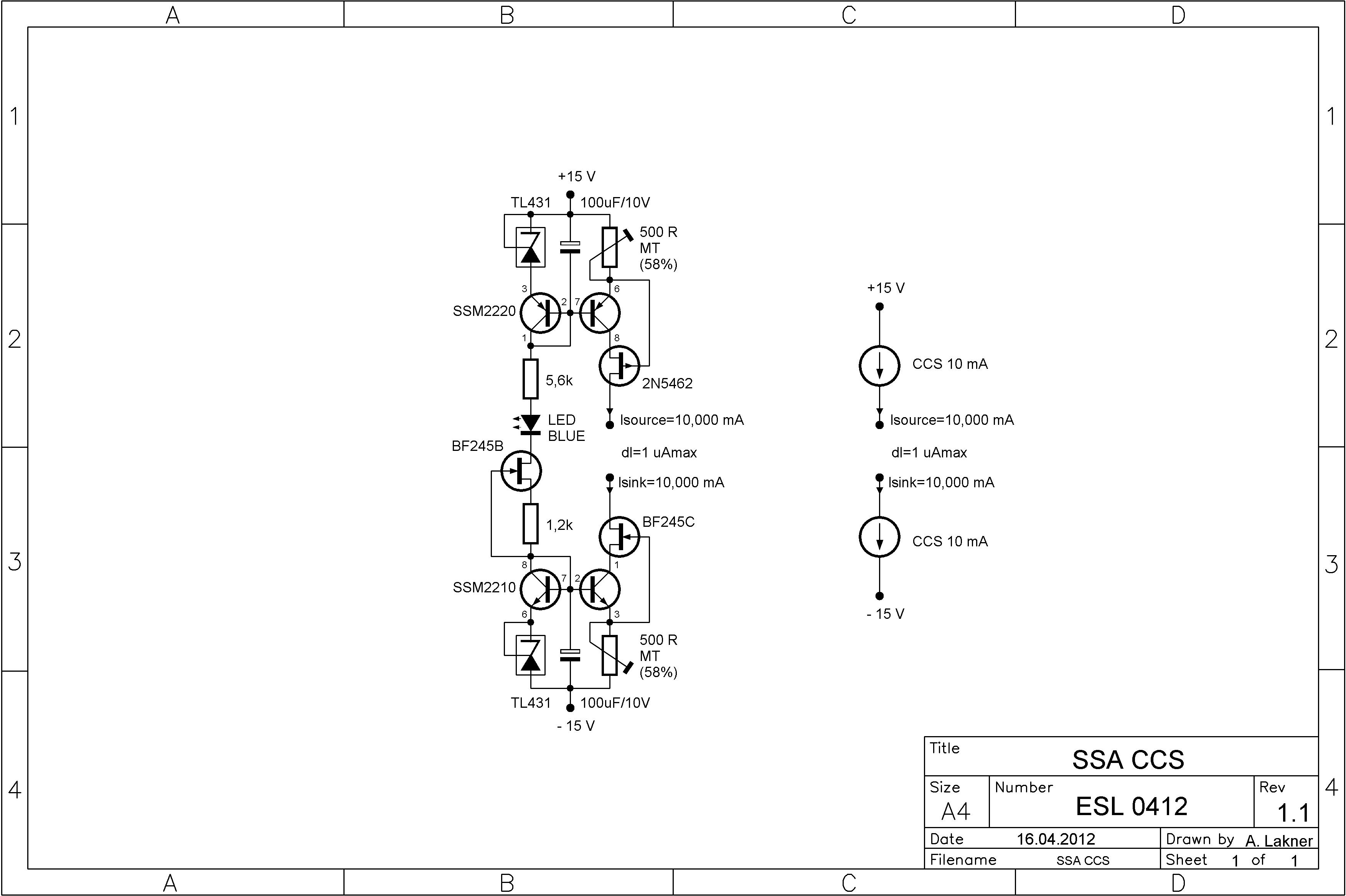

2. Offset. Wow this Wilson is quite a drunken dude. It just can't control itself, keeps sliding between +-200mV randomly. I expected this, but hope this can be solved.
It can be solved only with some thermal independent Vref like TL431 etc. That's why mine CCS are like sch on the pic. ;)
Shaan, I spent quite some time to find, choose and implement the best CCS into SSA, considering DC + thermal stability, AC performance, Iccs modulation suppression and noise level. Schematic I showed you is all that.
SSM matched pair serves to copy TL431 2,5 V into trimmer without Vbe thermal influence as well as noise performance of this chip laser trimmed pair.
TL431 is also very thermally stable regarding price/performance and last but not least fet cascodes puts Iccs modulation suppression down to -100 dB as I measured up to 100 kHz. All in all very good CCS performance. :up:
