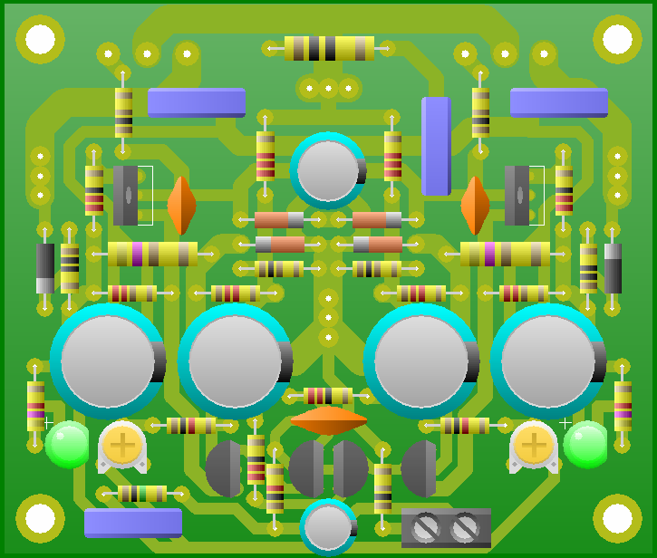

Is there a PCB drawing that includes the additions that Shaan has implemented?
Hi Harry :wave:
There are some PCBs with CCS included
- TSSA post #235, schematic few posts earlier
- TSSA post #957, schematic few posts earlier
- SSA post #2871, shematic few posts earlier, without CCSs
That's something for the start. 😉
We could all make consensus on specific schematic and make GB PCB once hehe
Regards, Andrej 🙂

I agree 100% with your last sentence, after all experiences and positive results it is time to make a PCB from SSA schematic that is tested and includes all necessary features to ensure pure SSA sound. So first we need consensus on schematic and than will make PCB, maybe even for GB. :up:

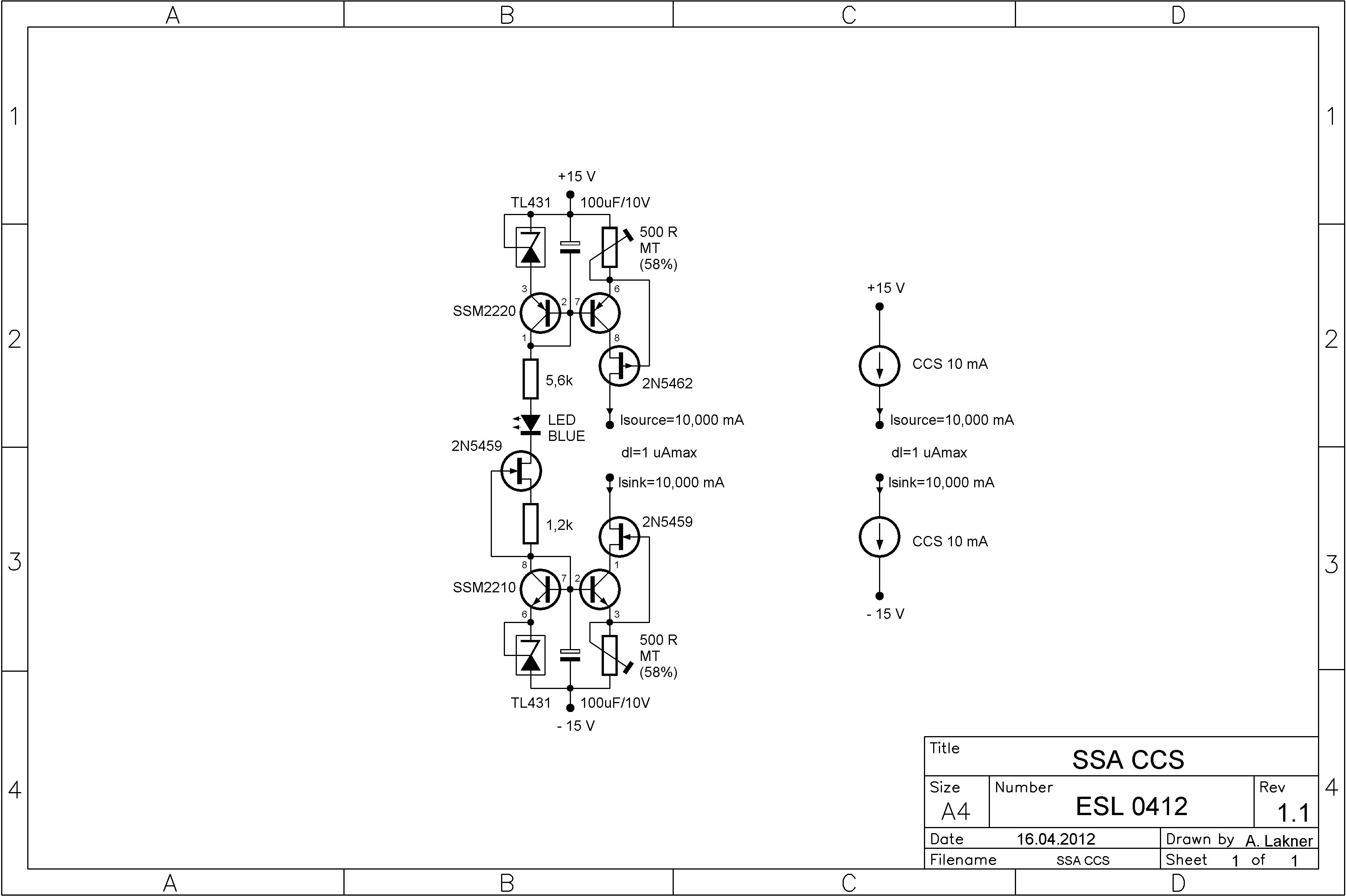

SSA BIGBT + SSA CCS
Requested by many, SSA BIGBT HP, SSA CCS schematics and final product successfully made in June 2012 😉

Thanks LC. So my reference to post #2992 is actually TSSA BIGBT HP and what you have reposted here in post #3034 is the SSA BIGBT HP. It is now clear to me and should help others as well.
Any reason for not using BF245B and 2N5486 JFETs in the SSA BIGBT HP? Just asking as I have them, as well as 2N5462. Moreoever, the voltage rating of 2N5459 is lesser than 2N5486.
Although this question belongs to the TSSA thread, is the 10K NTC the only heat sensing device in TSSA BIGBT HP?

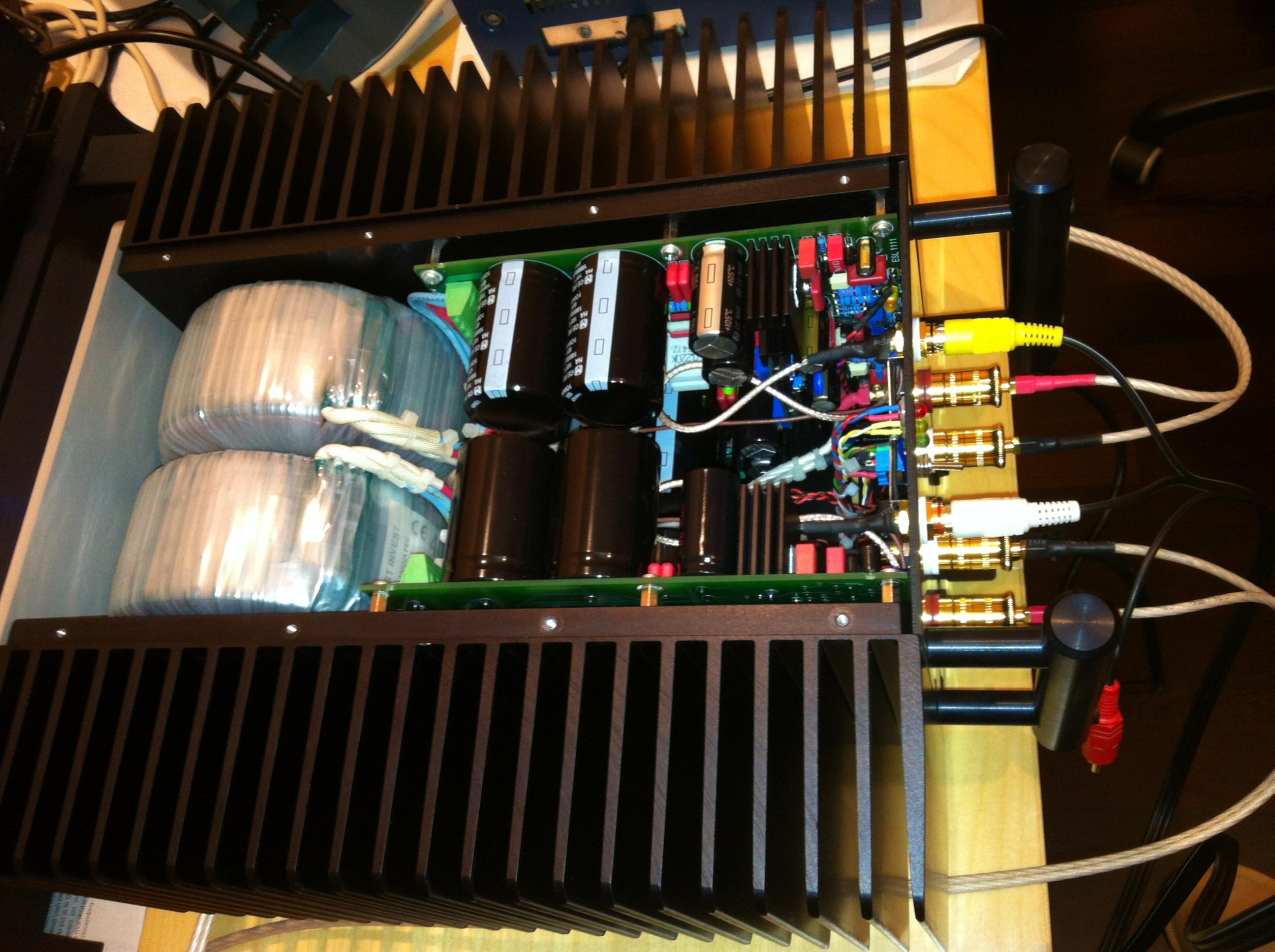

I wish we had such nice toroids available here. 🙁
Well there is hope, as the net says, some companies have started mass production and soon the story is going to turn better... 🙂
Locally produced. What I like about them is that the core is welded at both ends under mechanical tension to the ribbon, than complete core goes to plastic bath to be thickly coated in hard plastic. With this procedure they minimize possible ribbon vibration noises to minimum. 😎
