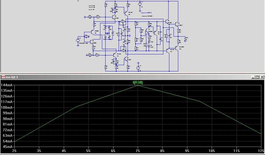

But how can I determine the minimum value?
Well, as the gates are protected with resistances, you know the minimum impedance. With the hole, the resistance make a low pass filter to the signal applied to the power stage.According to the incredible bandwidth and slew rate you can simulate, made at full power, nothing to worry ;-)
Looking at the slope of the expanded square wave, you can see what i suppose is a consequence of the variation of the gate capacitance with the level, the slope goes flatter with the level (a little slower than light speed ;-).
On my side, i had tried several lower values of gate stopper, not a big difference. So i suppose we are at a nice minimum of current provided by the driver stage.
Well, one thing can be done to save some power and add some roughness would be to reduce the rail to rail voltage of the power stage ? On my size, and with my stabilized power supply, i do not wanted to complicate the wiring. May-be a switched PSU for the power stage and my PSU (with a little transformer cause less amps) for the previous one would be an ultimate solution ?
In simplest words semiconductor junctions are in eternal love with constant temperature
That can be reached on the average, not transients because the thermal resistance between the cases of the transistor and the junction, the high inertia of passive coolers and the low thermal inertia of the junction.
Here too, a very fast open loop amp with enough back is the solution to minimize distortion.
Again, this remark us about reproducing music, made of transients and not about worrying about DC offsets as long as they are kept little enough.
Looking on my sims, you can see that a 10 X improvement of the bandwitch produce a factor 10 of reduction of both TIM and harmonic distortion.
That i wanted to demonstrate to myself in applying the beautiful architecture of L.C. to a promising existing amp. (That, and my lazyness ;-)
The physics behind that is "heat travels" according to laws of diffusion. These are parametrized ( i.e. solved) by constants of matter. The assumption of complete mutual independency yields exponential functions. hasn't anything to do with inertia, that is a consequence.
I calculated the power dissipation and from that...well using thermal conductivity - or resistance junction to case case to insulator to heatsink
yields the steady state case as all those Rth..x are solutions of differential equations for t-> infinite. The only topology that has no such problems is the Quad 303 cascade.
Thus the simulation is at best a rough estimate showing that no thermal runaway can happen.
In practice this will be tested with sine bursts at 1/2 full power where disspation is maximum and then read the current with digital scope.
