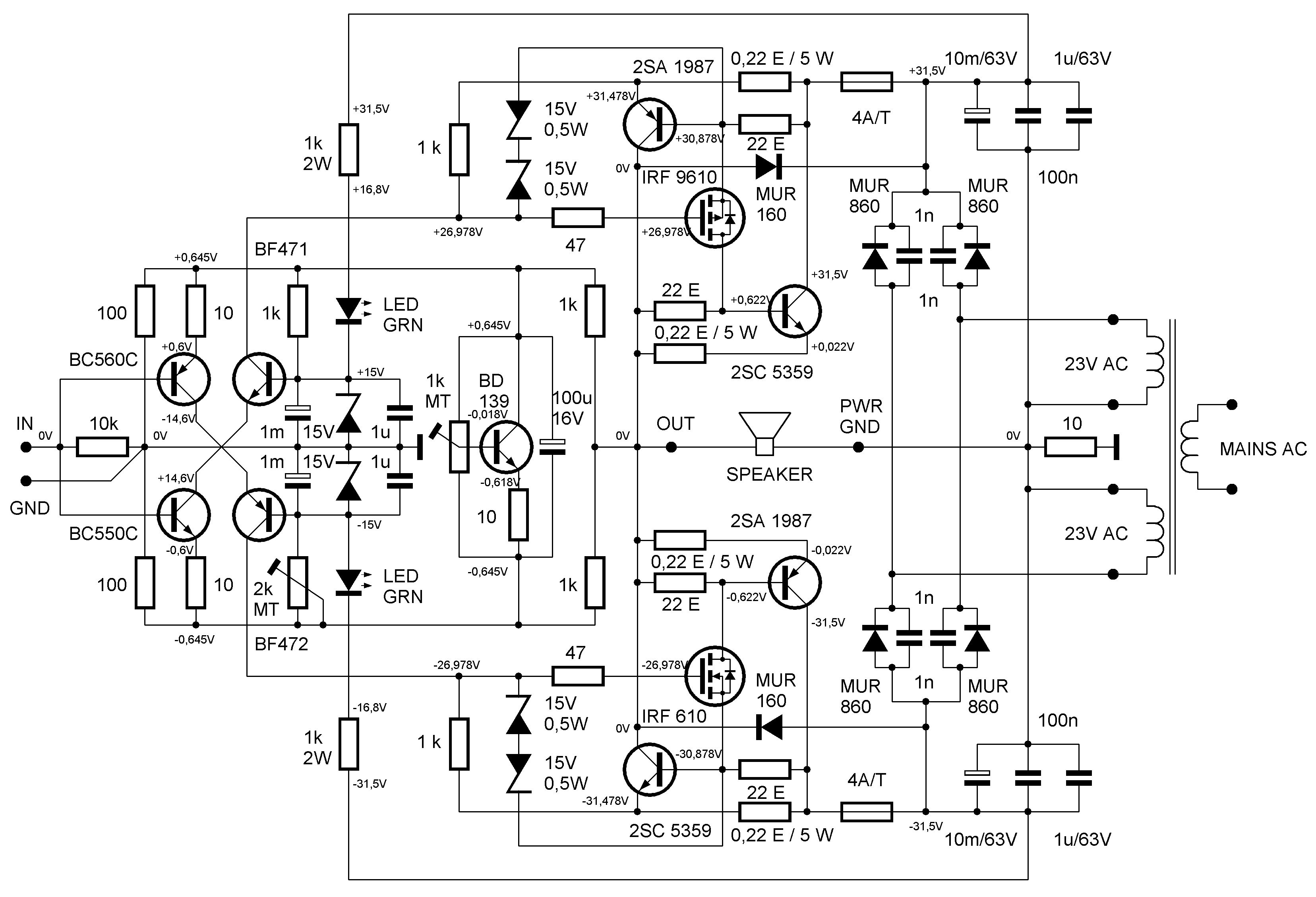

BTW, I agree with you about the non-switching Class AB. I have tried this one too, over some years, but never found the benefits I expected sonically. I really don't think that the switching of the output stage is such a big problem as long as it's clean and well controlled.
A good compromise is to ensure that the drivers never switch off.
Hugh
With K30ATM and BF245A had tested only. But mine's LAT and low driver bias suffices. Check if your input BJTs still run about the same Ie, and if the amp's output tracks sine wave well symmetrically when cranking it up on the scope. Say at 30V pk-pk. About HF noise, see if its acting up so to revisit comp caps or input filtering 'cause the CCS boosts its speed. Will some NTC find enough temp to react when bundled with two small BJTs running 30mW each? We must get to know which exact type works for LC first. Still the CCS is fixing the drivers bias stability not the input drift. But in a bridge everything interacts non the less.
Upon further review (tried a DN2540), the CCS prevents bias of the outputs from drifting too high. That part is fine. But the problem is that the voltage drop across the CCS is small until it begins limiting current, but then it continues to rise. This eats up the rail voltage on one side. I don't think this will work. I await the NTC recipe.
Sheldon
I used low pinch off Jfets for that reason. Up to what level did the DN2540 hold before starting to chew up?
The DN2540 holds up fine, it's a 400 volt device. It keeps the current through the bias diodes from drifting higher. The problem is that the driver transistor keeps trying to turn on harder, increasing the voltage at the top of the CCS. That effectively reduces the rail voltage on the rail driving the CCS. Clipping is asymmetrical, of course.
Sheldon
VAS cascodes has 10 mA collector bias current, I don't think they ever go to off state ... 🙄
P.S. Vbe multiplier voltage is always present and quite constant, so no sign of FET crossover distortion. FET bias is independant from output stage and can be several hundred mA if you like. Voltage part of the circuit also has +/-10 V more PSU potential than the output stage. 😉

how would you bias the FETs for class AB?

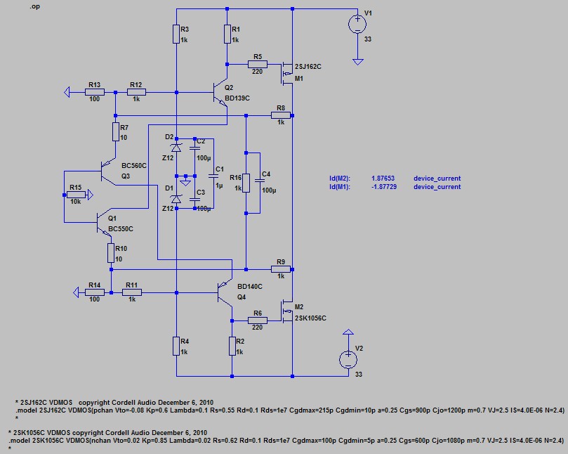

provided the model provided by Bob Cordell is correct and the schematic is correct
I get an op of 1.8 amps drain current .
Is that correct?
