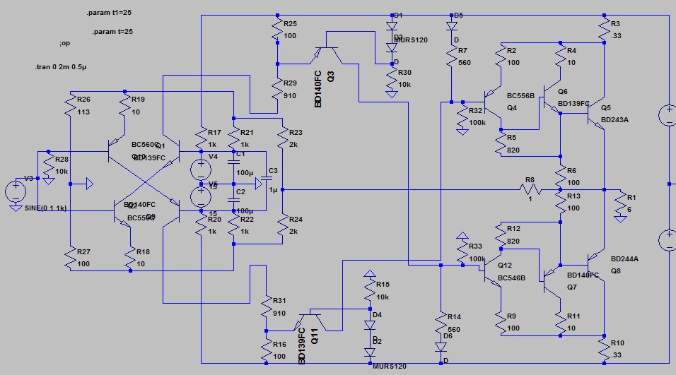

Whatever I try..the sym cascade produces much distortion far more than the power current amp. Dunno what is wrong? Nevertheless the op stability vs temp from 25 to 140 is brilliant.
Maybe the thermal track diode causes this distortions, at 1 mA first stage bias, also diode bias current, dV/dI curve is higly nonlinear. Global feedback can compensate this behaviour to some extent but not to ppm level.🙄

Its a shame...the circuit at least in simulation can be tweaked to yield a constant idle current from junction temp 20 degree to 130 degrees...Maybe the thermal track diode causes this distortions, at 1 mA first stage bias, also diode bias current, dV/dI curve is higly nonlinear. Global feedback can compensate this behaviour to some extent but not to ppm level.🙄
wow.
But the distortion level is outright too much.
That alone is not bad, but the harmonics spectrum is poor as odd harmonics dominate . That will not sound good.
Thus next attempt coming soon.
