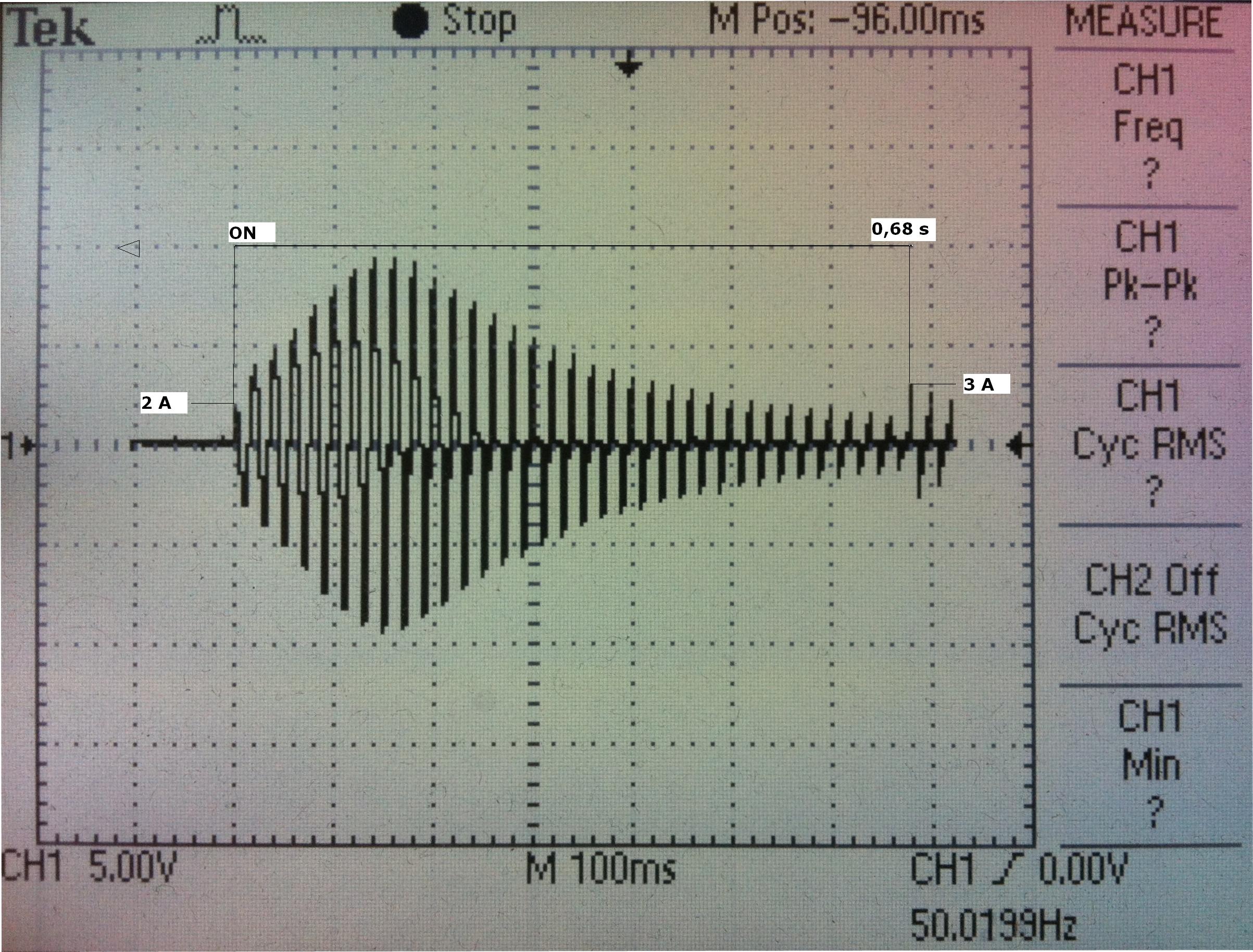

Plot represent mains AC current waveform as voltage drop on 1,00 ohm resistor (1 V on plot equals 1 A) as function of NTC soft-start circuit power-on sequence. After 0,68 s delay, relay contacts shorts the NTC and there's still 3 A current peak to fully charge elco bank of both (stereo) SSA channels. 😉
Here's plot with values. 😎
P.S. Serial NTC is CL-90 from GE. First power-on relay switch is dealing with some 2 Ap and second delay-on relay switch with some 3 Ap which is quite optimal for turning on two 400 VA toroidial transformers and some 90.000 uF of all elcos in power supply. 🙂

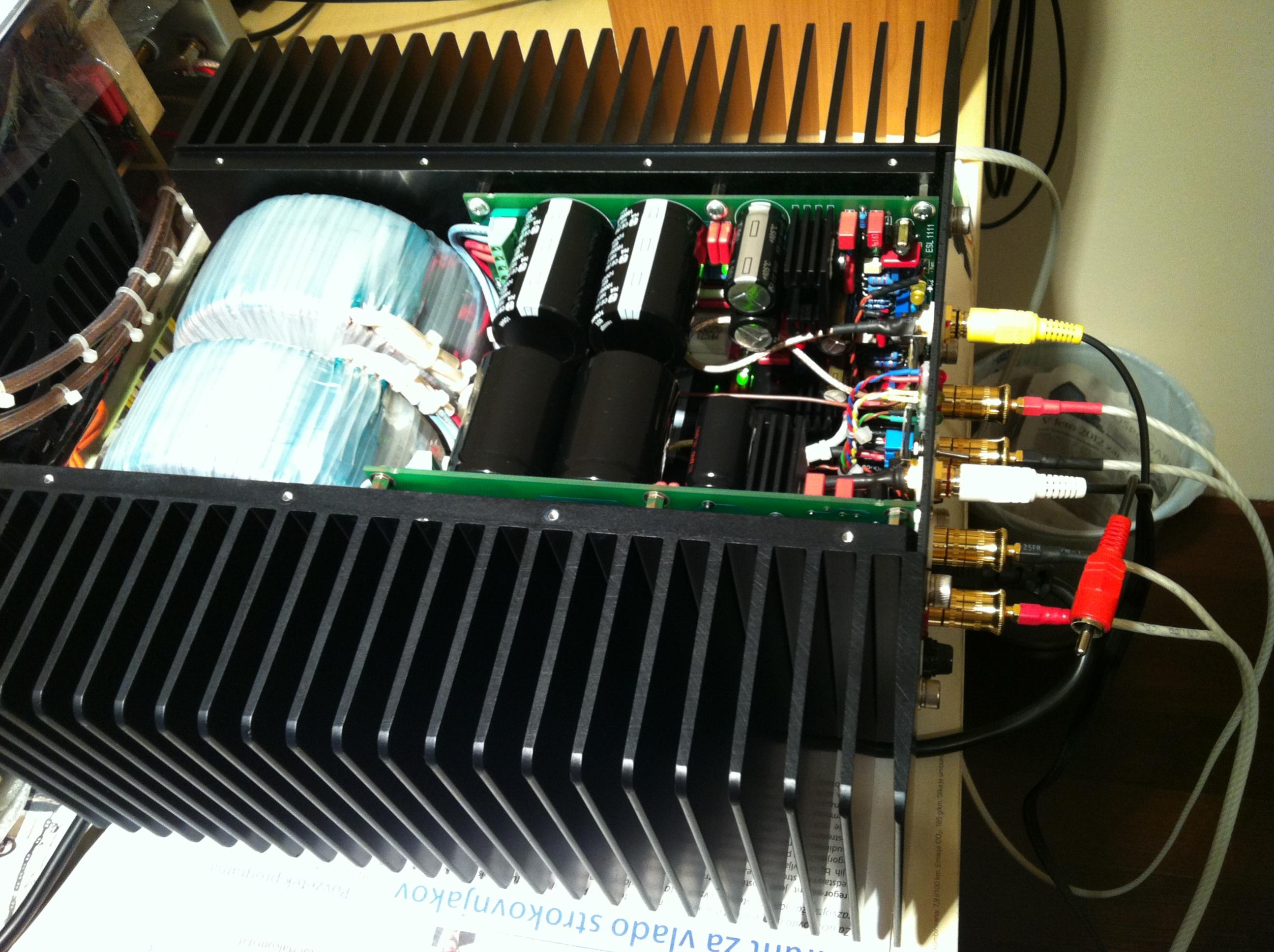

After 😎
Very nicely done LC, any concerns with transf so close..? if not the packaging is exquisite..

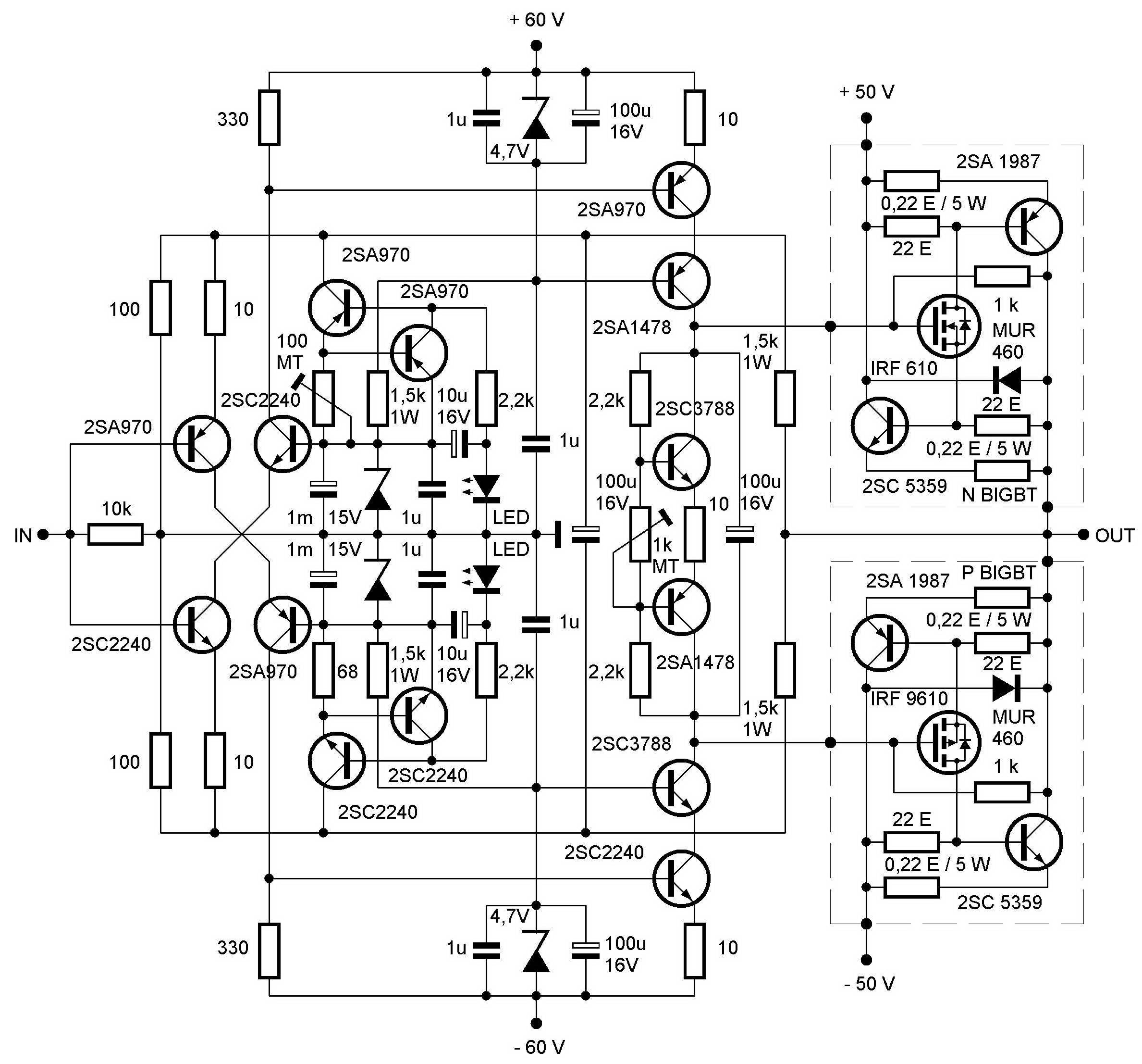

LC, may I know where is the PC layout diagrma of your SSA BIGBT HP ? wanted to take a look at the reference, may I ?
SSA all BJT and Thermal trak
The SSA employs a cascode which acts as CS. This CS can possibly not charge discharge the gate source capacitance of the MOS fast enough, moreover,
all paraistic capacitances of MOS depend highly non linear on gate source voltage and so on, and according to semiconductor physics, must be different for p channel MOS.
I would like the SSA all BJT and current driven throughout because power BJTs can have a perfectly linear ic/ib up to about 5 amps that is enough for 50 watts amp.
I will use one pair of thermal trak BJTs and thus the first design obstacle is how to control a Vbe multiplier with these on subtstate diodes thus that the operating point is independent of the junction temp of the power BJTs.
Hi Hans 😉
SSA BIGBT HP is very fast design it has -3 dB CLG margin around 3 MHz and slew rate more than 300 V/us and that info is for ready made amp in the box, if you know what that means.
In SSA BIGBT HP predriver/VAS stage has 10 mA bias and current response up to 100 mA with ease, so driving two IRF gate's is a peace of cake.
IRF's drivers are vertical MOS FET intended for fast switching applications and in BIGBT configuration they are perfectly suitable for audio purpose. This is probably the best output device to my opinion and it's really a shame that more of DIY-ers don't test and use them because they are inherently stable, very imune to self oscillations, easy to drive, has enourmous current capability (30 A) and has positive characteristics from both common emmiter/collector output configuration in one device ("balanced"). 😎
Congrats ...............![]()
Thank you a.wayne 😉
No difference to output noise or 50 Hz hum from "before" to "after" setup. There is simply nothing at the output no matter of the toroids position. 😎
Hi Hans 😉
so this slew rate is obtained from an actual device driving what load?
Real load, 6 ohm speaker connected, 10/100 kHz square wave, positive edge slew measured. 😉
Hi LC,
Is the BIGBT schematic joined already usable. Your latest HP version is out of range for me? I am affraid that the thermaltack version (2x25vac rail) i worked on doeasn't present sufficient power to drive speaker i planed in my room.
Marc
